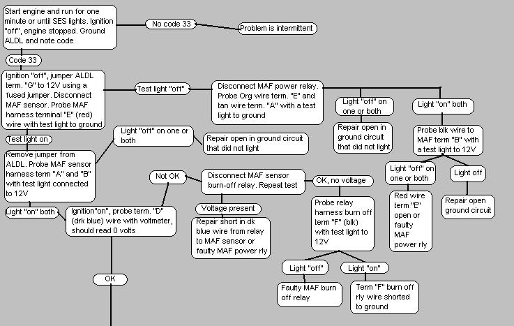

Need help troubleshooting your MAF Code 33? If so then check out these pics.
Attached Thumbnails MAF 33 trouble code troubleshoot-maf_code_33_pg1.jpg   MAF 33 trouble code troubleshoot-maf_code_33_pg2.jpg

it says to use a 12v jumper but how do u make one or where can u buy one

wait, let me read. On which box?

Ok. get a tester light that has an inline fuse. Connect one end to the positive terminal of the battery and the other end to the wire that is being tested.
