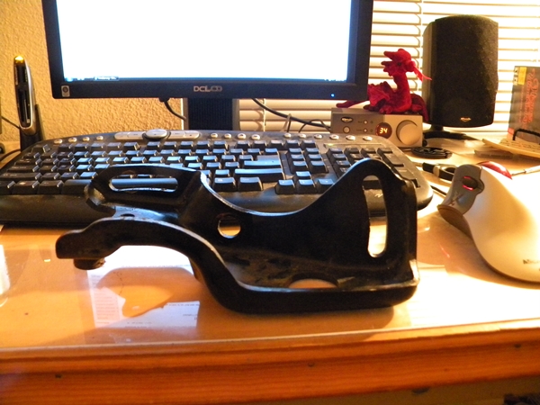

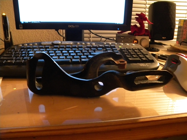

Hey guys been awhile since I posted. just got an engine from an 87 firebird TA 350 tpi motor and trying to id this bracket and where it goes? It has a dual v belt and one serpentine belt style pulley setup on the engine.
Some pictures if someone has tghem of where it goes in relation to the other brackets would be awesome as well

That is for the AC, it fits behind the compressor. The two lower closely spaced holes that are rusty go on the LH exhaust manifold, the first two bolts. The lower slot is one of two bolts for the PS adjustment.
