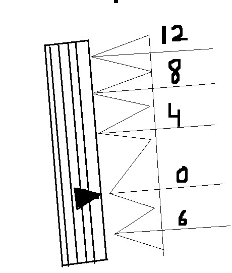

i think the LB9 and L98 are have the same timing tabs. Either way , I hope i remember, but Ill take a picture of mine tomorrow and ill post it up for ya.
Old Jul 30, 2010 | 12:02 AM
  #90
massaku's Avatar
Joined: Dec 2008
Posts: 228
From: Puyallup Washington
Car: 84 15th anniversary Trans Am
Engine: 305 H.O. L69
Re: LB9 hesitation when given gas and no low end power
Thanks bro! there are like 3 little points one big point and another little point but I dont know which one to get the mark on lol.

I made a crude little picture after looking at my other TPI engine... is 6* on top or bottom? I believe twisting the dizzy counterclockwise it should raise the line on and twisting clockwise lowers it. I am guessing it is the one on the bottom.
Sorry its so crude lol

Here is what I have mine at with the EST wire disconnected.
Attached Thumbnails LB9 hesitation when given gas and no low end power-1.jpg   LB9 hesitation when given gas and no low end power-2.jpg   LB9 hesitation when given gas and no low end power-3.jpg
Old Jul 30, 2010 | 10:22 PM
  #93
massaku's Avatar
Joined: Dec 2008
Posts: 228
Dude...your awesome thanks man
