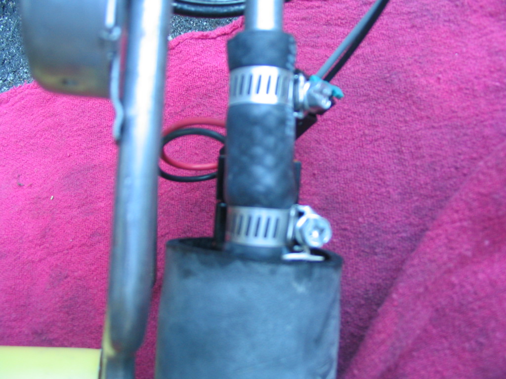

I took my car out today in 90* and got about 20 minutes in before the pressure started to flux. Got it parked, did my errand and put 1/2 a tank of gas in and that got me home.
I had been talking with Racetronix about their Walbro pump. They referred me to Greg Carroll at Blowerworks (supercharging company); they say he's well versed in TPI cars. He gave me some more things to try. He, Me, TGO, we all agree heat is our problem. I told him my voltages did not drop and he suggested a few things:
-->pinch the rubber return line when the pressure starts to drop:
*if you get a large jump in psi, the regulator may be the culprit
*if you get nothing, he then suggests checking the in-tank rubber hose; said if there a fracture in the rubber, it will open up when it gets hot and your pressure will drop; replace the pump if no fault with the hose is found
He also said the Walbro pumps are a good unit. Also said to get better submersible fuel hose (suggested Gates).
What's odd is that when an issue similar to this occurred in 2007, it was the pulsator that went bad. I removed it and installed a second Walbro with the hose supplied from Edelbrock. These symptoms remind me of the trouble I was having then. I had hoped I wouldn't have to drop the tank, but I think I've arrived at that point now (after the pinch test of course).

NOTE: I am updating this post as well as the other one we're all reading
A week or so ago, I mention a couple of tests a fella at Blowerworks had me perform. He said to pinch the return fuel line and see what happens. What happened was really nothing. I got no spike in fuel pressure, thus eliminating my regulator as the source of my pressure loss. Couple that with my voltage tests a couple months ago (which yielded no voltage drop) and the fact that my entire underhood system is wrapped, and that leaves only one area that can fail. That is the submerged rubber fuel line in the tank.

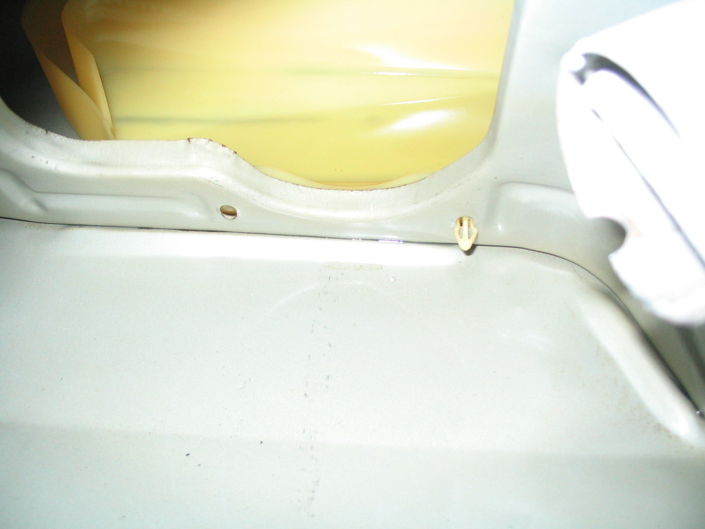

I finally bit the bullet and dropped the tank; much easier the second time (in 4 years).
I had to laugh at myself this time though. Only took me 3 hours to get everything removed and have the tank strapless sitting on a jack stand. I know I had gotten most of the fuel out but could still hear the liquid-in-a-metal-container sound when I knocked on the bottom. I laid under the car for a good 30 minutes staring, wondering, worrying how I'd get the jack stand out from under it and not have it crash on my head or break the neck off. I eventually scooted a second stand under the right side and gradually eliminated the original one in the middle. Teetering on the edge of destruction, I thought. I laid on my back and edged the second stand out of the way, fully expecting the worst. It dropped onto the diff (a big honkin' 12 bolt mind you) and sat there. I lifted it up and it weighed next to nothing; manuvered it off the diff and it practically fell out of the bottom of the car...all in less time than it took you to read my description. Wow.
My secret was that when I did this last, I couldn't for the life me get it to go back in, kept getting stuck in the hole in the quarter panel. I got pissed enough to where I took my trusty channel locks and rolled up the rusty piece of metal over the hole. About 1/2' x 6" section. It popped right into place then, and fell right out this time. I won't cut a hole from the inside but I have no problem moving PITA oxidized metal out of my way.
So anyway, I removed the sending unit and inspected everything. Nothing looked broken, no tears in the rubber, no scum on the bottom of the tank, nothing. I have finally run out of things to blame (good thing because I haven't been right yet) and pieces to replace. I've order the Racetronix FPA-019 (another Warbro) pump that Orr has had success with. I may get it sometime next week and I'll let you know how it turns out.
Only thing I can think that may have hurt this pump is when I was wiring up the EZ-EFI to the FP relay, I had accidentally hooked the EZ ground wire (which I thought was a 12v source like the stock ECM) to the power terminal where the former stock ECM went. Started the car that first time and got nothing (obviously). Could putting ground in place of power have hurt it?
The pics below are:
1) tank so clean you could eat out of it
2) the hose that I thought would have been compromised but isn't
3) the fuel sock which doesn't really look too dirty
The pics below are:
