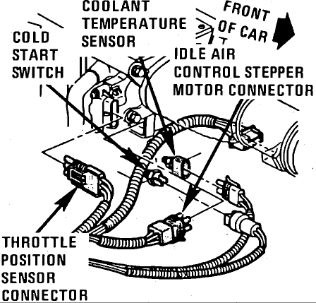

Im converting to a stealth ram and need a little sensor ID help. I have searched and also looked through some alldata diagrams I have access to.
I am trying to identify the 2 sensors in the front of the intake 1 I know is the coolant temp the other is unknown fan switch maybe? It has a fuel injector type connector on it. If anyone knows on a 870 ecm does the ecm control the fan temp turn on or is it a switch?

That sensor on the front of the intake is the EGR time delay switch.

The sensor on the front of the intake is the ninth injector timer switch.
Explains The connector.. Thanks..

Ok thanks for that. Guess Ill have to continue to use my hayden controller until I switch to the EBL system
I found the alldata diagram of the cold start injector now that I knew what to look for.
