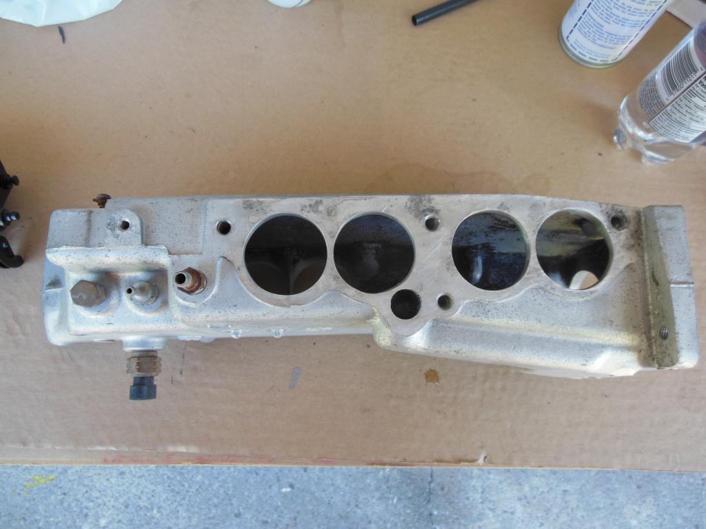

First off, sorry if this has been answered already, I searched as much as I could and couldn't find an answer.
How is the upper plenum constructed? Is it just a box and nothing more? Or is the inside extensions of the runners? Does, for example, the right bank feed from the left of the plenum and vice versa? Or does it feed right-to-right and left-to-left? How does the air travel? I'd just like some enlightenment from the TPI gods of the forum .

It's essentially a box. There's really no chambers, per se.

Plenum is open inside
