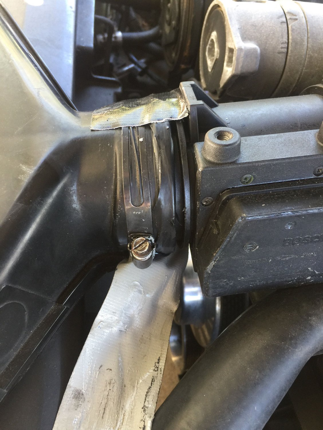

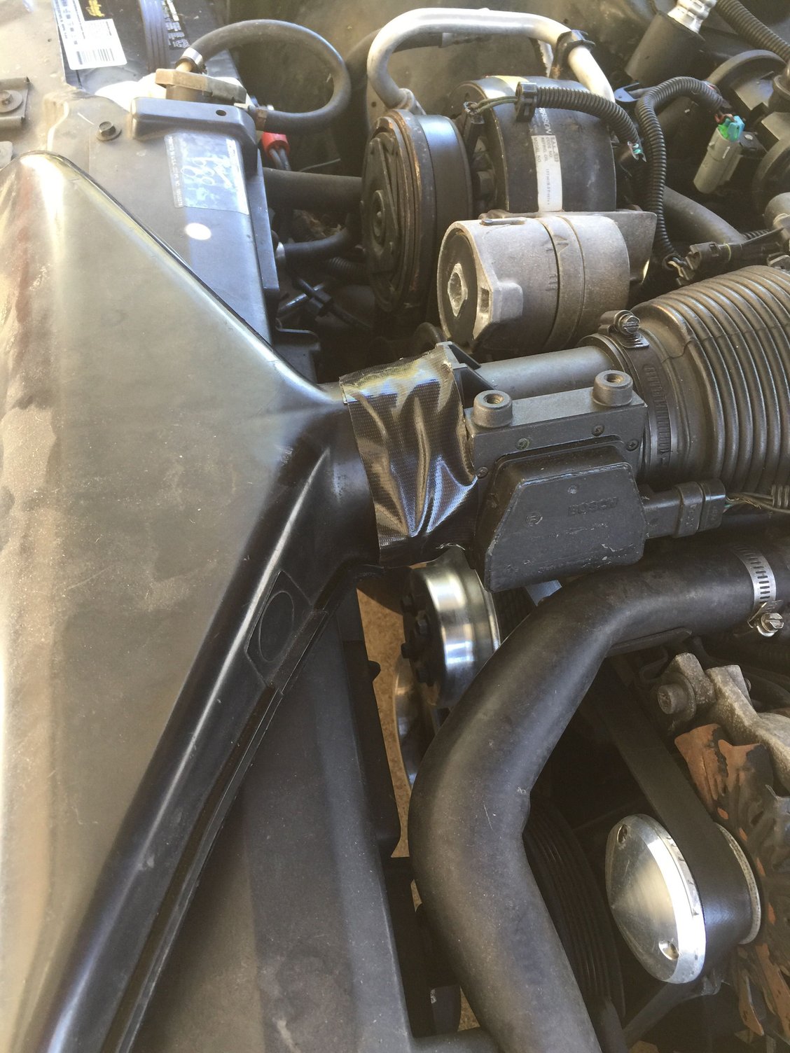

Recently had some work done, the machinic said he didn't have the part for this so he wrapped it in duck tape. Can someone help me with what I'm missing?

This one time. At band clamp.
Originally, GM used a soft O ring inside the aircleaner that the MAF seats against, then a one time use band clamp was fixed over the aircleaner lip and the ridge on the front of the MAF.
Kinda like this... Or exactly like this... Hard to explain and visualize, so here's a few photos of one I just happen to have laying here.

It's important that everything AFTER the MAF sensor is pretty sealed up, since any air that gets in the system needs to go through the MAF. In your case, the "leak" if you will is BEFORE the MAF, so even if air does make its way in, it's still getting metered by the MAF, and won't affect how the car drives.
....I had the same missing clamp, and actually cut a 1.5" segment of an old bike tire tube and used it like a big rubber band. Looked fairly "factory" too if you didn't know better.
