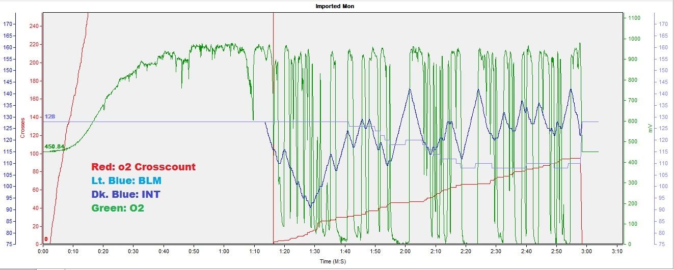

I found the attached image online while tracing the o2 circuit. It appears to me, the ECM probably supplies full voltage (not sure if 5v or 12v) to the signal wire, but it passes through a resistor to drop voltage to .54v. Hopefully if its 12v prior to the resistor, there wont be any damage done by back feeding 12v through it.

I had him disconnect the O2 a while ago and take data.
The thing that convinced me something on the O2 sensor circuit was wrong was the fact that even with the O2 disconnected, TP was still reading 1092 mV (which would ordinarily be impossible). As you say, in open loop, this doesn't matter since the ECM ignores the O2 in open loop.
The way it got into closed loop at all with the O2 disconnected is that the 1092 mV voltage that the ECM is seeing on the O2 circuit is substituting for what the O2 would normally send. Since it sees a voltage and the coolant temp enable temperature is met, it goes into closed loop.
In those logs, Wrangler would report that the engine would run fine for a while and then stumble and die, which would correspond to the log... where I would see the engine run stable in open loop and then as soon as it reached closed loop temperature, the ECM would recognize the O2 voltage coming in from (what we now know to be) that short to 12V on the O2 sensor harness.
Once it got into closed loop, the Integrator would immediately plummet to 108, chasing the O2 voltage. The BLM would then plummet to 108, and you'd see the idle speed and IAC going crazy until the engine died.

Wrangler, the image you posted in the first post shows something entirely different than what you are describing. The blades are honestly irrelevant at this point, as the commanded RPM is based on certain parameters. If the blades are open, the IAC closes to meter the commanded air. If the blades are closed, the IAC opens to meter the commanded air. Simple. Your IAC shows a rise in steps during cold start Open Loop, and this is based on the image you posted. The O2 is irrelevant at that point because the loop is not closed yet in terms of feedback when the IAC deviates. I'm glad to hear you checked the diaphragm in the regulator as that can be an issue when the engine sits for awhile, it will dry up. As far as the O2 sensor, you stated on the first page that you replaced the O2 sensor with no apparent effect. If you still feel it is the O2 sensor, then why didn't you force Open Loop to see if that is indeed the culprit and inspect how the engine runs ignoing its' feedback? Don't see how an ECM will go bad just from sitting unless there are critters around, but anything is possible. If that is in fact the case though, you might want to consider upgrading to an EBL system...

It's detecting a false mega-rich condition (a constant 1V on the O2 is basically pig rich to the ECM). So it's pulling fuel out like crazy until it reaches the limit of it's "trim-ability" at BLM of 108. So the engine is getting starved of fuel.
At the same time, the ECM is seeing the engine RPM dropping due to lack of fuel. But it still thinks you're running rich since the O2 is still pegged at over 1V. So it does it what its supposed to do to keep the engine alive and opens the IAC to give it more air. But without the fuel, it doesn't matter how much air comes in through the IAC... without fuel, ultimately dies.
The logs showed it was somewhat of an intermittent short. I forget if I mentioned it in this thread or over e-mail, but at times the voltage would be 450mV (the normal stoich voltage). But anytime the voltage was shorted up to 1092 mV, it spelled trouble.

Yeah, the O2 sensor circuit definitely seems to be fixed now. ECM appears to be behaving normally for the most part, which would put my fear to rest about possibly having damaged the ECM with the 12V short on the O2 circuit.
Nevertheless, something is dragging the BLM down to 108 still once you get into closed loop though. Not sure what to make of it at this point though.
If there's nothing wrong with the ECM, then something on the side of the engine with the O2 sensor is malfunctioning.

Could this be a tuning issue then? Earlier on in this thread you mentioned the running voltage being low and explained the injector "on" length would change with voltage. Now that it running at 14.6v, could this also be contributing to the non running condition?
The o2 is after the Y pipe in the motor, so it sees both exhaust banks right after the union.

Look at the Time between ref Pulses in microseconds. Everytime on a decrease, when its injecting more fuel, there is its normal RPM increase. So whats causing the ECM to want to add more fuel... I saw a document around somewhere with the computer's logic on what triggers it do add more fuel like its doing there.

Back to my question for ULTM8Z, would increasing overall system voltage mess up the original tuning enough that the ecm tables are no longer able to compensate?
Admittedly, I did not personally not tune the motor (I had it tuned by http://www.scotthansen.net/ through a series of data logs and burned proms) so my knowledge of the computer language associated with the ecm run program is very small.
Re: Motor used to run perfect, but won't run longer than 2 mins. now?
That's a good thought. You might try getting your system voltage back to the way it was and see if that solves the problem. If it does, then yeah most likely it's a tuning issue related to your injectors.
at that point, it'd be up to you whether you want to keep running it that way or retuning for the correct system voltage. Since you say it ran perfectly before.
what injectors are you running?
edit: by "tuning issue" I don't mean Scott messed up. I only mean he tuned around want seems like a system malfunction (That was evidently unknown at the time). Lol... Something I've done many times myself... and when the malfunction is found and corrected, you have to go back and either start from scratch (depending on the severity) or simply make further adjustments.

Ideally I'd just have it re-tuned with the higher voltage.
Bosch III
Sure, I dont blame him at all.
I don't have a clue. I'd send him a data log and he'd send me a burned prom to data log until he got the numbers where he wanted them. I think we went through 5/6 tunes.
