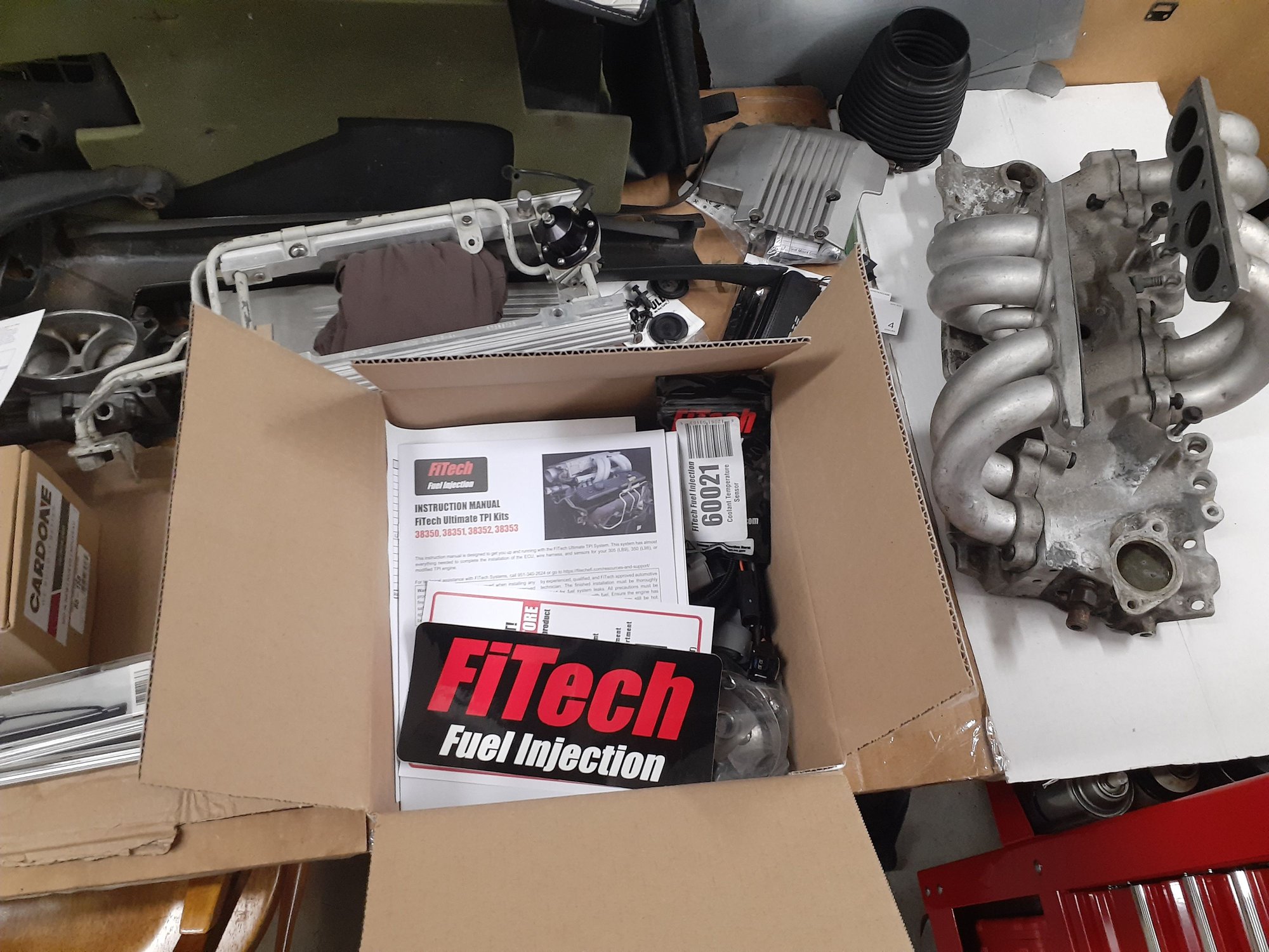

My order FINALLY arrived. Now who wants to help me install my engine so I can review it?

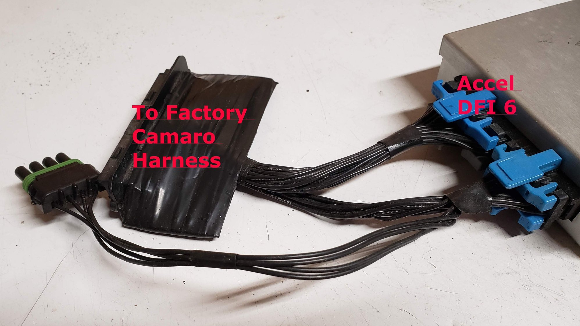

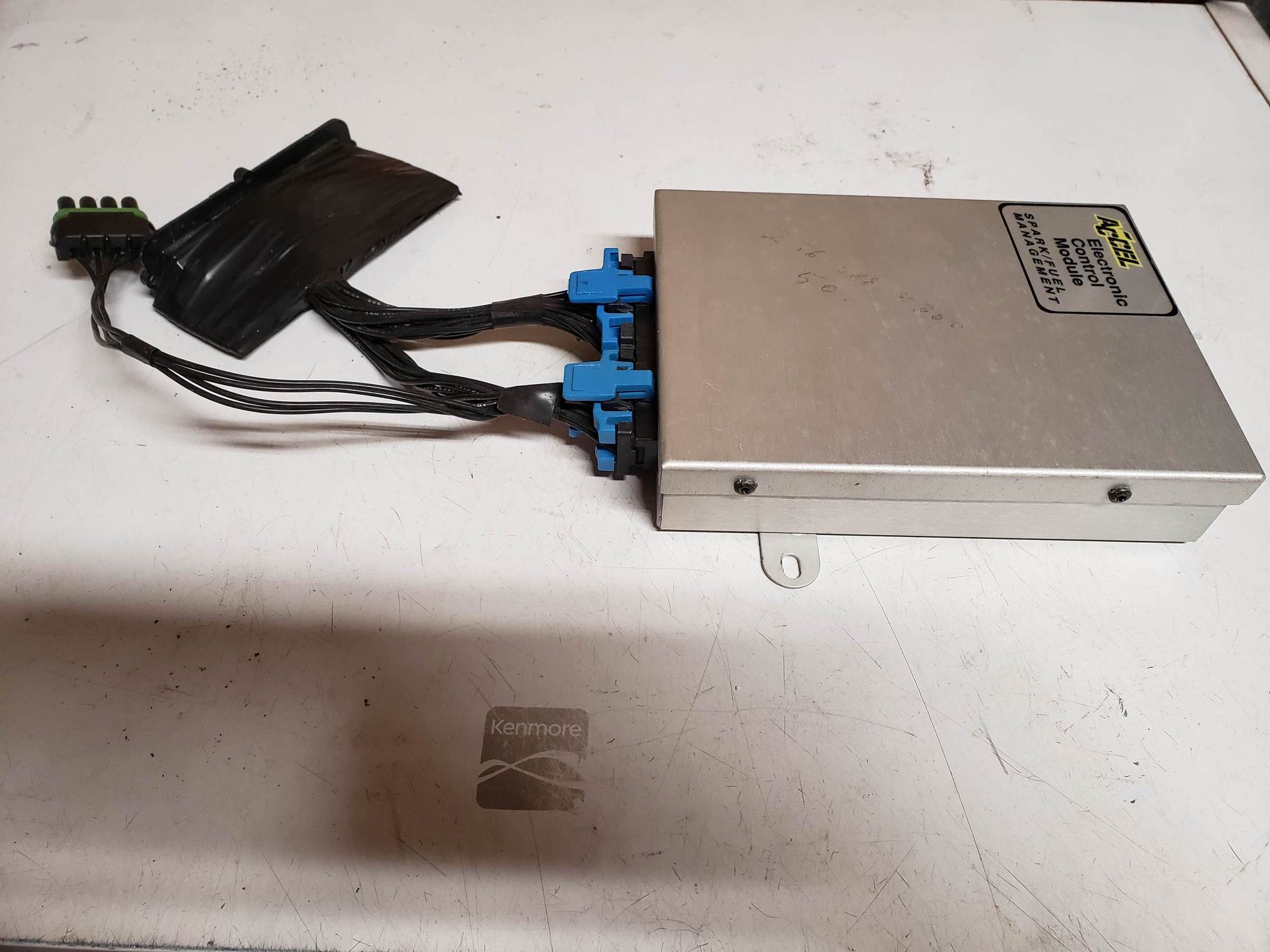

Back in the day, there were a few companies that created piggy back harnesses for the Accel DFI and FAST EFI boxes that allowed them to be plugged directly into the factory 3rd gen harness. Unfortunately those guys are long gone. The header connector that allows a piggy back harness are still available. If someone were savvy with electrical connections and soldering, one could create the same type of harness for the FI Tech.
Here's my old White Racing piggy back harness for my Accel DFI 6 that's I've used since the late 80's
funny, I had one of those old boxes. worked great tuned in dos. looked a bit different but was plug and play. I think I sold it to someone in Hawaii on here years and years ago.
but yes, today's stuff should be pretty easy to be plug and play. at this point all the imports have plug and play stand alones like ecm masters and stuff. such a shame they don't support domestic stuff besides ls

My piggy back harness was by White Racing. The other was by Fast Track Performance. Maybe you had that setup? Yeah I see a lot of custom piggy back harnesses for the import cars. I've tried to reach out and see these companies would be willing to do custom work to do the same for Third Gen's but no one is interested as they are only familiar with the Import schematics. If one were talented enough with electronics, you would just need the header connector and modify FiTech harness to it to create a piggy back interface that would plug directly into the factory harness.
