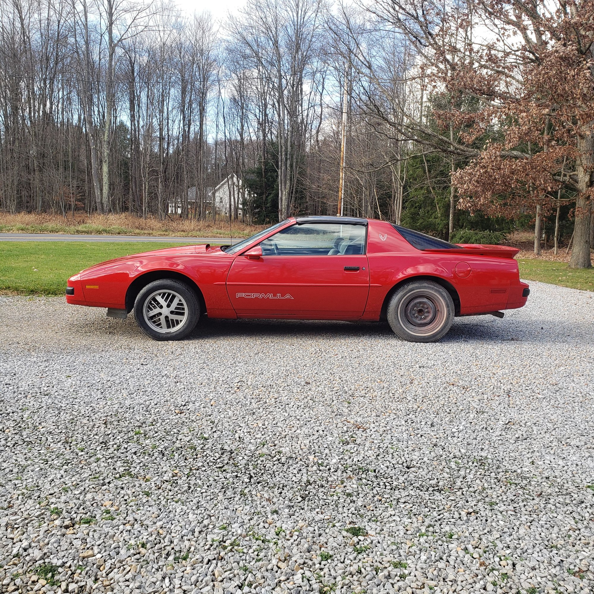

My question to you is this........what color Formula ??
Throw a set of injectors in it and post up some pics - Good Luck

I will have some time Sunday to get back to the Formula. I will try a few gallons of e15 fuel and some Techron and see what happens. Master cylinder replacement will finish up a complete brake system overhaul as well.
Here is another question, in going over the brakes I found one of my aluminum drums has a significant crack in the liner, anyone have suggestions where to source a replacement. I have not found the aluminum drums anywhere local.

I did pull the cap, rotor and wires, all appeared fine. I did mention that the inside of the cylinders were excellent. Had a close look at each one when we were cleaning out all the sunflower seeds that were stored in 4 of the cylinders.

In my opinion you should replace the injectors anyway. They have been sitting for years....plus those injectors are so prone to coil failure. If you wanted to get them cleaned and tested it would cost the same as purchasing a replacement set. And more than likely they will crap out on you eventually anyway.
I cleaned the injectors on my BMW N62 V8. wish I had not done that because they were fine. now i'm getting something weird going on. in hind sight, it may have been a waste of $$ that I could have put towards new injectors.

it is back home, I need to start sorting all the issues but at least it starts and idles.. gave it and quick wash this afternoon, rear Goodyears do not hold air after 22 years so it has to be steelies for a little while
