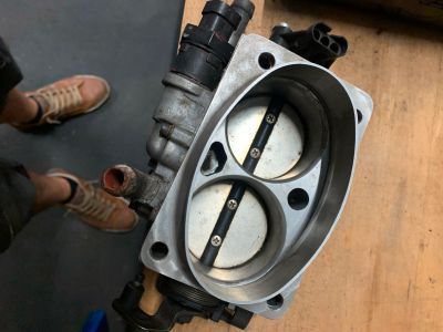

Hellow folks,
I found an offer in the internet. This TPI kit is going to be sold soon.
Can someone help me identifying the stuff in the pictures.
Questions:
-Are the runners SLP one`s? If yes, will it fit a stock base manifold (diameter)?
-what kind of manufacturer is the throttle body? Looks not OEM
-the plenum seems to be ported and matched to the runners, looking good?
-what would you pay for the stuff you can see on the pictures?
-the parts look like 85-88 tpi right? Seems like it operates with a 9th injector (cause of the small tube beside the bigger runners?)

Second run of slp, Accel lingenfelter 58mm Throttlebody and 85-88 plenum
