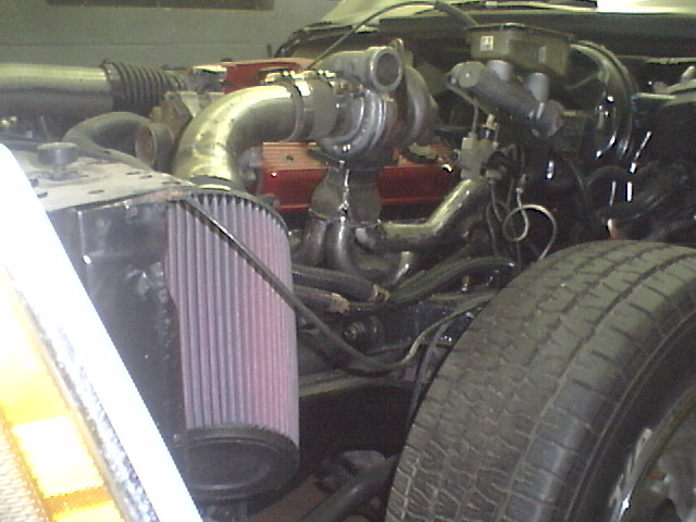

Dont know about a fire in the engine but a too small return will burn out the pump. I would get a second 3/8 Monte feed line and use both 3/8 lines for the fuel injection. I used the stock Trans Am lines "adjusted" to fit the G-body frame and a Gran National tank (190 lpr pump) with #6 braided line to connect the two. Using the stock hoses front to connect to the rails. Future mods will require larger lines... You can see the fuel lines in the pic. Hope this helps, Bob

HOLA CHIT MAN !! that looks great, thats not in a 3rd gen is it? I may be wrong but from the frame that you can see it looks identical to mine. Did you run the #6 line all the way to the tank or just to the fuel lines?

hehe, thanks..yeah its a 80 Malibu coupe. its all factory F-body fuel lines back to near the tank, then braided to the top of the Buick GN tank.
