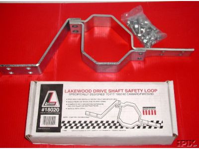

I was wondering if anyone has any options on which one to get. I am looking into getting the Jegs or Lakewood one.
Here is the lakewood one:

Hey Luke. Go with the Spohn piece. It bolts right to your tranny mount and crossmember with no drilling to other pieces of the floorpan.
HTH...Ed

i bought the jegster universal fit DS loop, it would of been easier and quicker to buy flat steel and make my own.

I still use one of those. Both can be used as long as they're for third gens. They need that extra piece that clears the torque arm. A generic loop doesn't.

Oh wow, I didn’t know Spohn made a stand alone driveshaft safety loop. Hmm, seems a bit pricy at $75 when the Lakewood and jegster safety loops are selling for $25. I do like that Spohn’s safety loop require no drilling though. It’s a tuff call.

I paid $100.00 for a Metco that I'm not even using. The Spohn piece is great Worth every penny

I run the Jegster loop designed for our cars..$35 fits perfectly.

Be careful of this one if your car is lowered at all, like 3" as mine is...
I bought the torque arm with the $40 optional driveshaft loop on it, and after installing it my torque arm kept striking the loop under load....had to cut it off with a sawzall....

Ditto. I had the lakewood and got upset at it. The holes werent even aligned right and after just installing a whole new interior I wasnt going to drill. The spohn fit perfect and looks great.

Dude.. I wish I did cause it deserves a pic, but I dont have a dig camara. (Dam I need to get one) Its very very nice and heavy duty. Also clears my BMR TA too. Only hard part was drilling through the crossmember to get the bolts into the tranny mount. Had to line it up pretty good.
