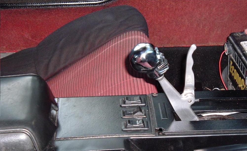

I pop rivited a pc. of thick sheet metal over the hole in the floor (you can use sheet metal screws, bolts and taps, ot weld)
Then mounted my Pro stick shifter down to the floor (on that thick sheet metal) I had to put a .75" spacer under the shifter to get it to the right highet. To bolt down the shifter, I used bolts and taps. Long bolts, stuck from the bottom up through floor, spacer, shifter, then put thr tap on it
Then I got an auto trans shift plate/top of consol. I had to enlarge the shifter slot in the shift plate some for my pro stick though, then just put the top of the consol on in place of the man. trans top consol

It's really wasnt too big of a pain to do.. It took me maybe 4-6 hours from start to finish.. Thats changing consols, putting shifter in, etc.
When I bought the car, it already had a v-8/auto trans, and the pro stick, but it was installed half assed. So I took it all out and made it right.
The 1st album pics is when I bought the car. The stick was way too low. Thats why I added the spacer under the shifter.
From the pics you seen, you saw no shift plate/consol top on the consol, cause they put the shifter in w/o a spacer and it was so low you couldnt reach the triggr, and lockout with the plate on
The shifter was one of the 1st things I fixed. I don't have alot of before and during pics cause at that time I hadnt bought my digital cam. yet, then, I bought a cheap $20 one and pics was bad, then about mid way through the whole project is when I bought one. I do have some pics of "after" on the shifter.
Oh btw.. The auto consol was just for looks really. You could still put the auto shifter in the man. consol, after you cover up the big hole in the floor. It just wont look as clean, and you'll see the working parts of the shifter.
Give me your E-Mail address and I'll send you what pics I have of the shifter. The mods here said 3 pics max per post, and I think I got about 6 or 7
Here's one pic of the shifter while I was fixing up the interior. You'll notice the shifter is up higher, and it has a shift plate on the consol.
