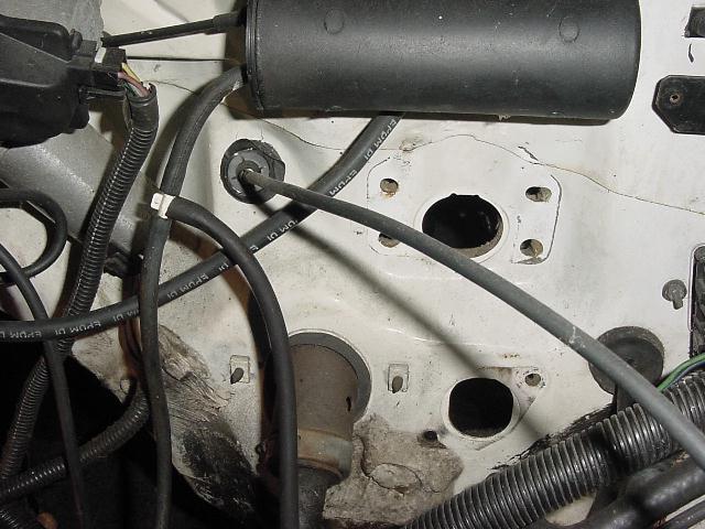

I am putting a hydralic clutch in my 83 Firebird and the insulation doesn't have the cutouts for where to drill so i was wondering if anybody has a template for where to drill on the firewall for a hyrdralic clutch setup. Thanks

Just finished doing that job today. I used the bracket that comes down from the clutch pedal as guide as to where to drill. Drill one of the small bolt holes first. Then use the u bolt to gauge the distance to the other small bolt hole. Use a 1" hole saw to cut the center hole. You will have to carefully enlarge it with a file or cutter bit in your drill to about 1-1/2"
