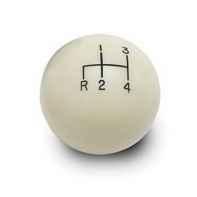

ok i was just talking to the owner again tonight, he told me the trans is really rare? he said reverse is left and back (i guess where 2nd would be on a normal 5spd) and then its just normal shifting to 1st, 2nd, 3rd, 4th. and its got a clutch.

Then it's a manual transmission.
The part about having a ratchet shifter for a 4 speed is BS then. He may have a short throw shifter or the tranny may have a close ratio gear set but it doesn't have a "ratchet shifter".
I have no idea what GM transmission uses that shift pattern
