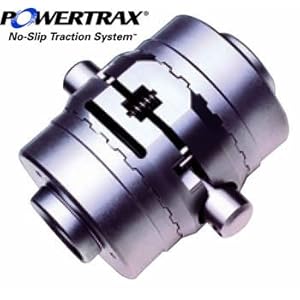

I saw a powertrax 26 spline no slip traction system for sale. Do I install this and my car will be posi or will I have to buy a posi gear like a 3.73 gear?

Just install it in place of your spider gears and you have instant posi.

but it didn't say anything about any gears and it says no slip.

If you don't want to change your gears "ring and pinion" you don't have to. They will be used again with that "26" spline Powertrax no-slip unit.
As 84z28 said, Just have it installed and instant posi.Heres a link to the unit at Richmond Gear. = http://www.richmondgear.com/powertrax/noslip.html

I've got a Lock Right in my S10 truck. I've been driving it every day for 13 years. It works just fine.
If you want to use anything other than the Powertrax kit then you must know what your gear ratio is before you order anything. The Governor Lock is not a good choice. The Eaton Posi is a good choice, but you must have a 3.23 to 4.10 gear to use it. Here is how you install it. http://www.nastyz28.com/forum/showthread.php?t=19773

I agree that the Eaton is the better choice.Thats what I put in mine. If your going to change the gear to a higher ratio and change out the axles to 28 spline than that's the way to go. If you don't want to mess with the gears ,etc. than I can see were the Powertrax no-slip would be appealing.

I love my powertrax but If I had another choice I would go with a detroit truetrac in a heart beat.
