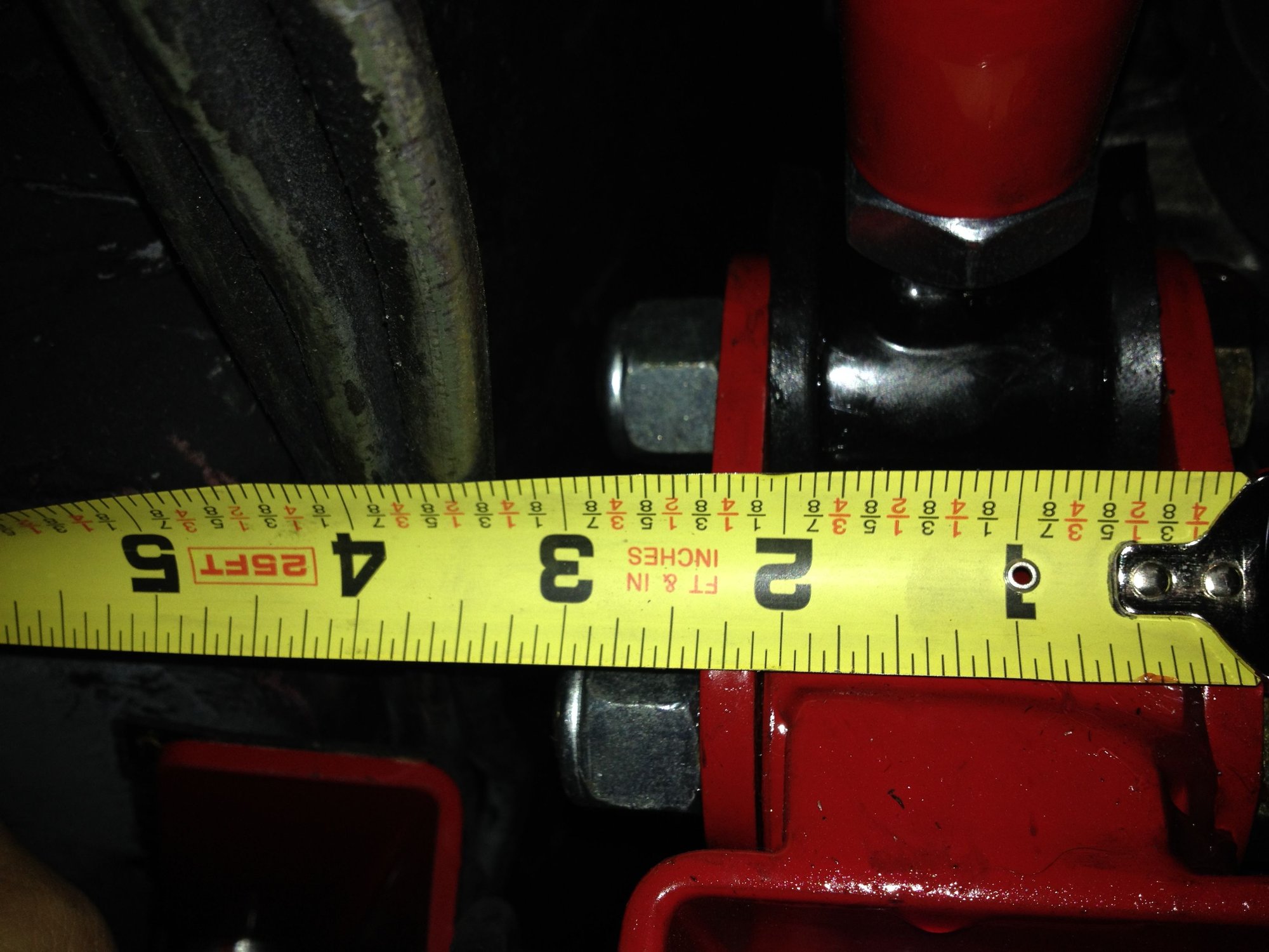

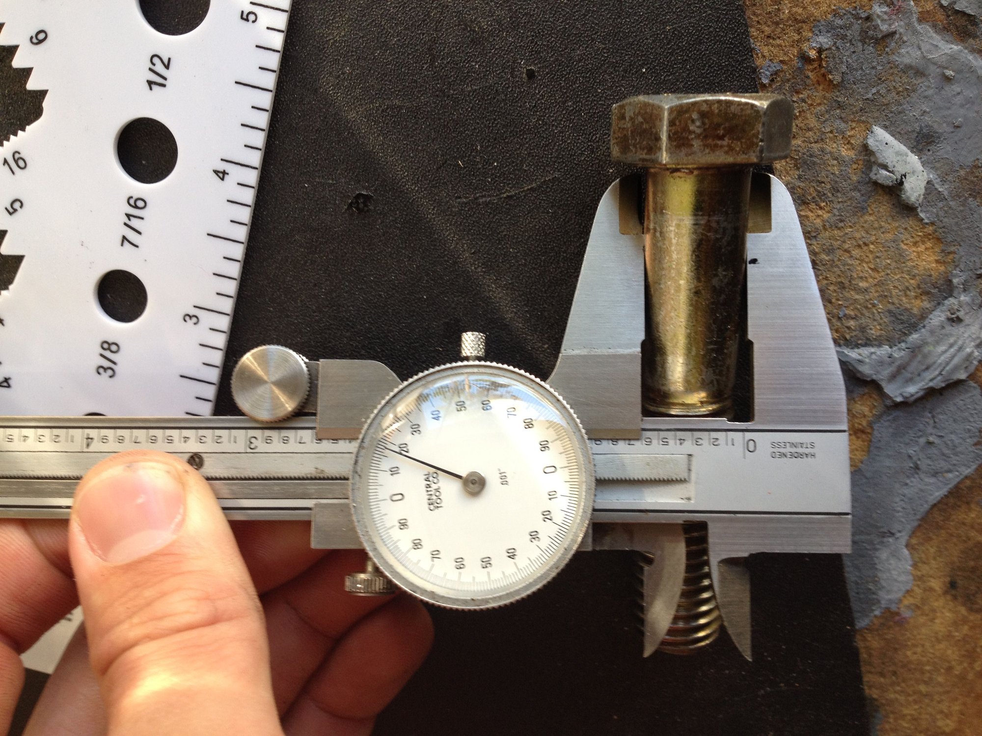

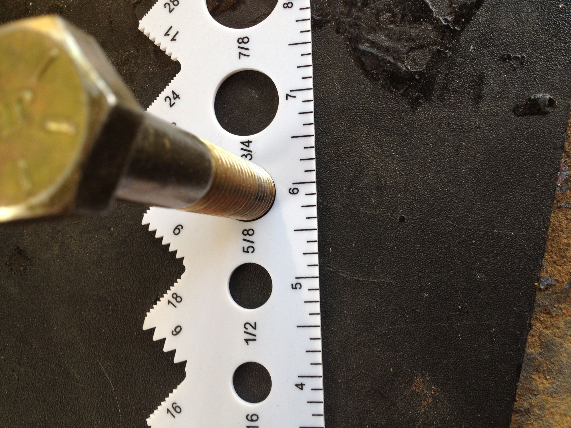

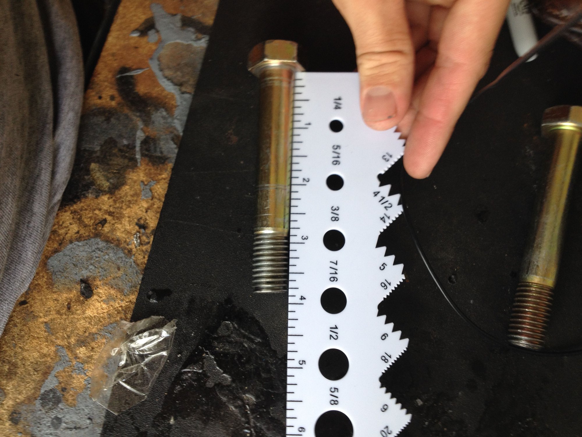

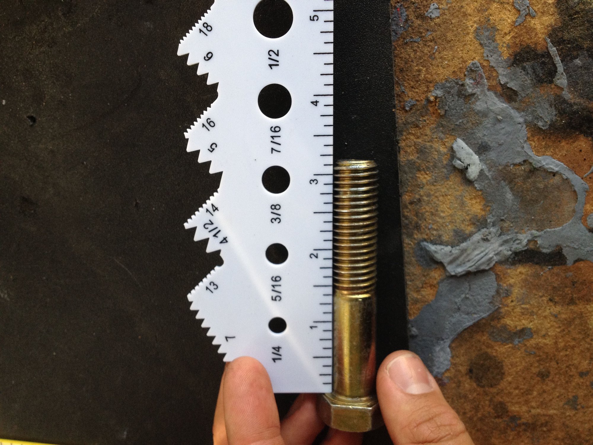

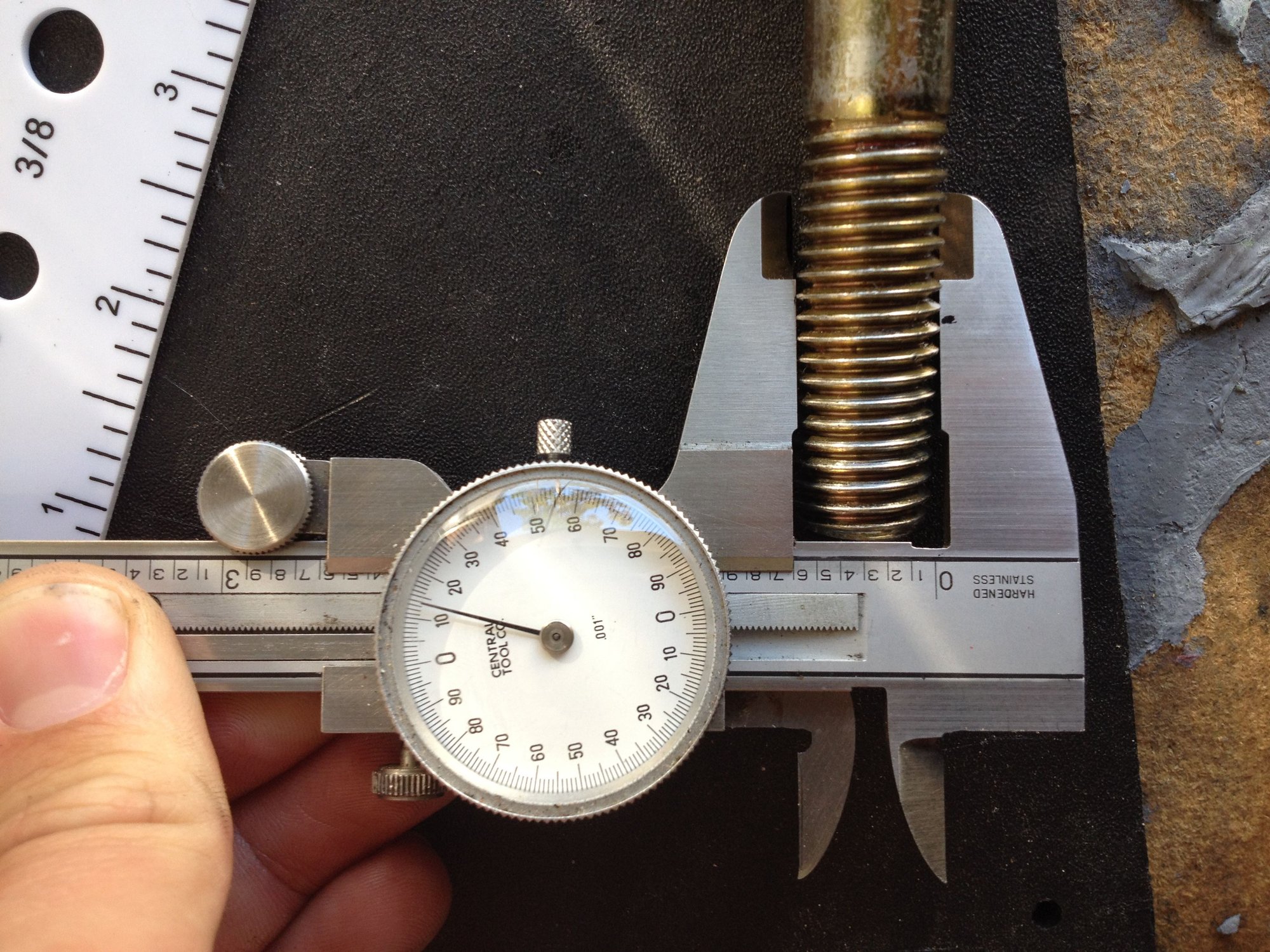

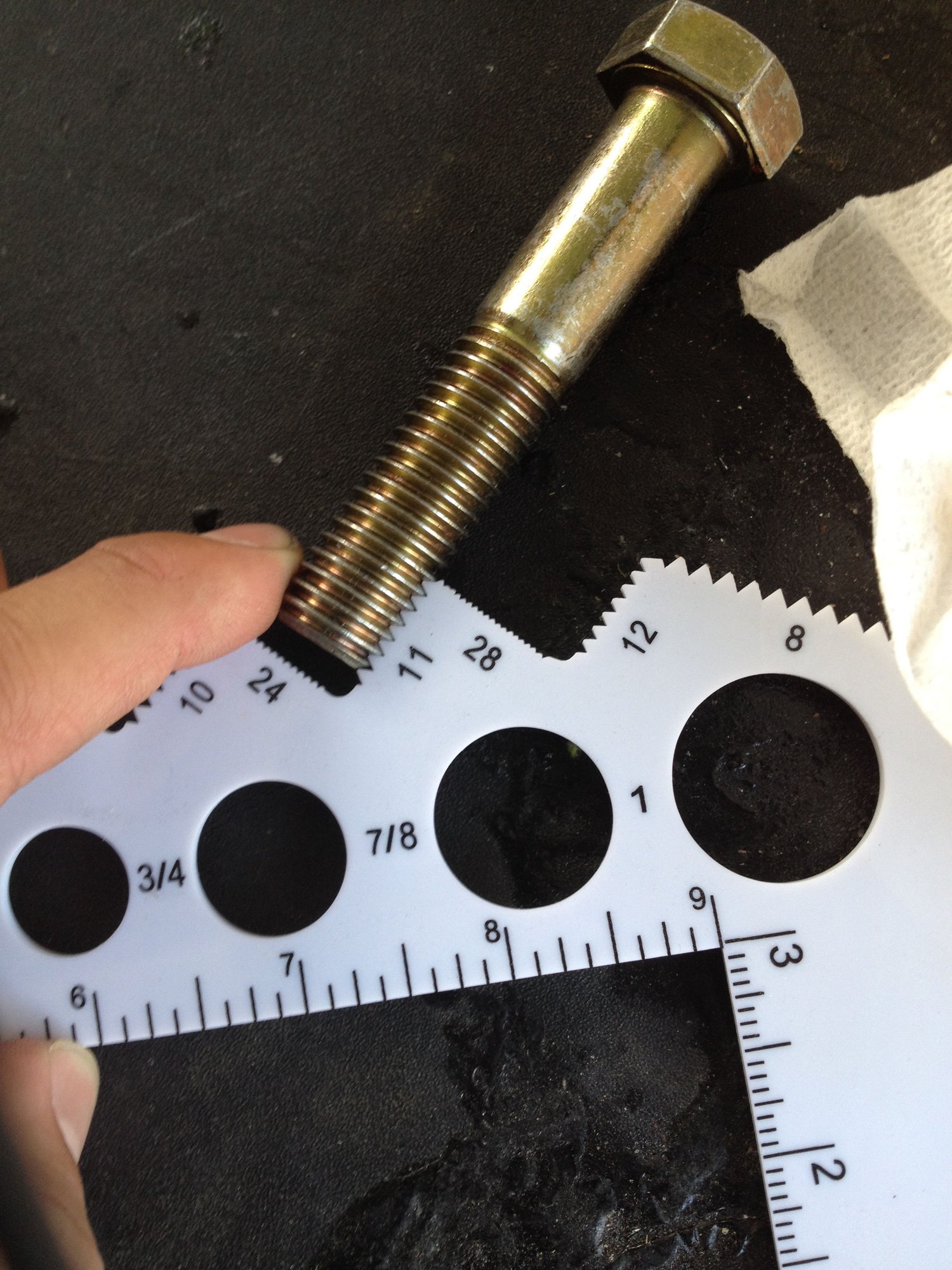

Took some time but I have the original bolt measurements. The bolt itself looks to be a 5/8-11 about 3-3/16" long. I took lots of pictures.
The diameter of the thread compared to the shank is different, but not by much. I guess it doesn't take much slop to make a noise when you're moving 3K+ lbs of assorted metals.
This is the new bolt I'm going to get https://www.boltdepot.com/Product-De...px?product=675
As you can see from the pics, the shank needs to be at least 2-3/8" long to pass completely through both plates.
I'll let you guys know how it goes when I get the new bolts.

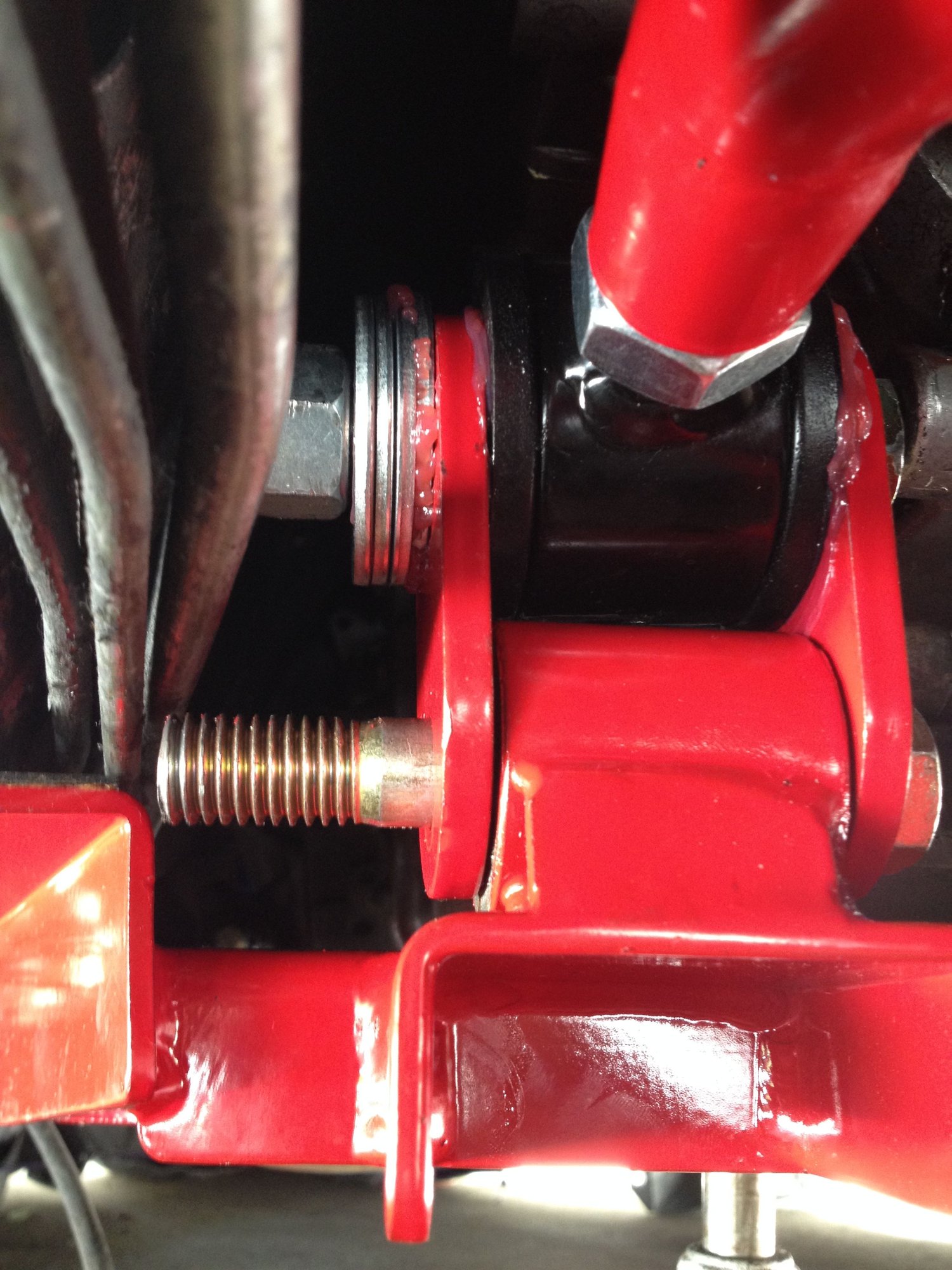

Coincidentally I just finished the job about 30 min ago. Took it for a ride and got on it pretty hard. It's definitely a LOT better than it was before, but there are still some noises. The funny thing is that it didn't sound like it was coming from the transmission tunnel anymore, sounded further back.
My car has been sitting a while and the test drive got cut short due to a state trooper (it's not registered atm lol). Once this semester is over (4/28) I'll have the car on the road and then I'll pinpoint the noise a little better.
I have a buddy with a go-pro, maybe I'll get some footage of this thing working on a launch or something. Anyways, I don't regret doing it as it made a big difference. I have some pics below. I'll keep ya posted.

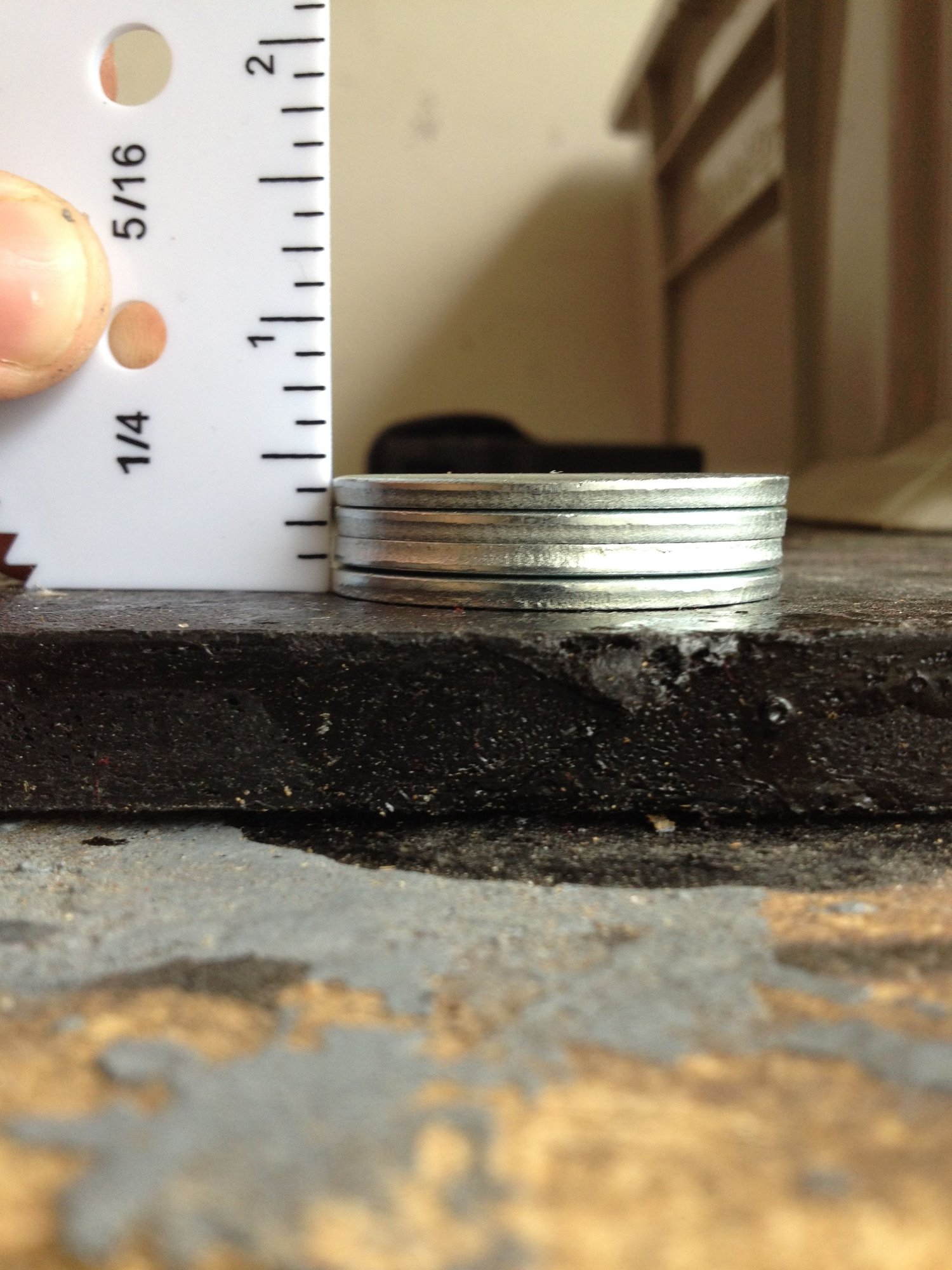

I ended up cutting the bolts that I got from the link I posted too short so I did some asking around and found a great hardware store with grade 8 bolts. Apple industrial supply in Ft. Pierce, Florida rocks. The bolts from the link would have worked also and used one less spacer washer, but these were only $1.25 a piece.
Spacer washers
I ground the bolt to a good length for clearance.
Here is the shank sticking through. Nicee
All installed
It ended up close to the fuel lines, but it clears just fine.
