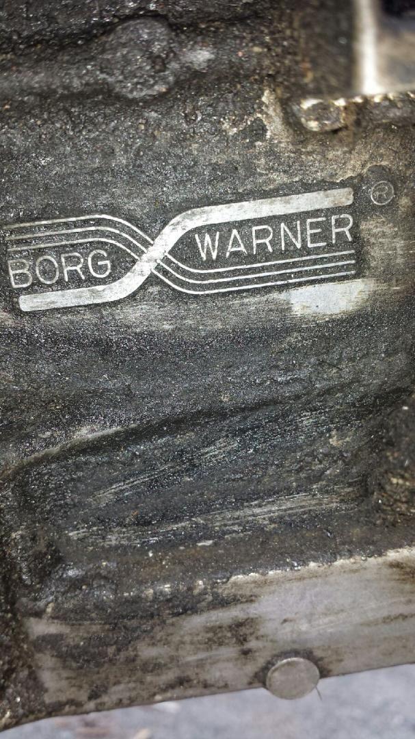

It is not a "Wagner", the mfr is Borg-Warner, as can be clearly read off the casting. The model is T-5.
What's the 8th digit of the car's VIN? (1 G 1 A P 8 7 ? x F N/L 1 xxxxx)
