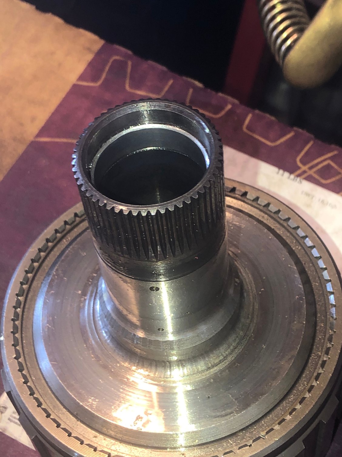

Do I need the brass thrust washer on the sunshell beneath the reaction shaft. I am using a Sonnax smart shell

Yes it did come with a special Torrington bearing that rests on the special low reverse roller clutch race. I am referring to the reaction shaft to what it rests on.
