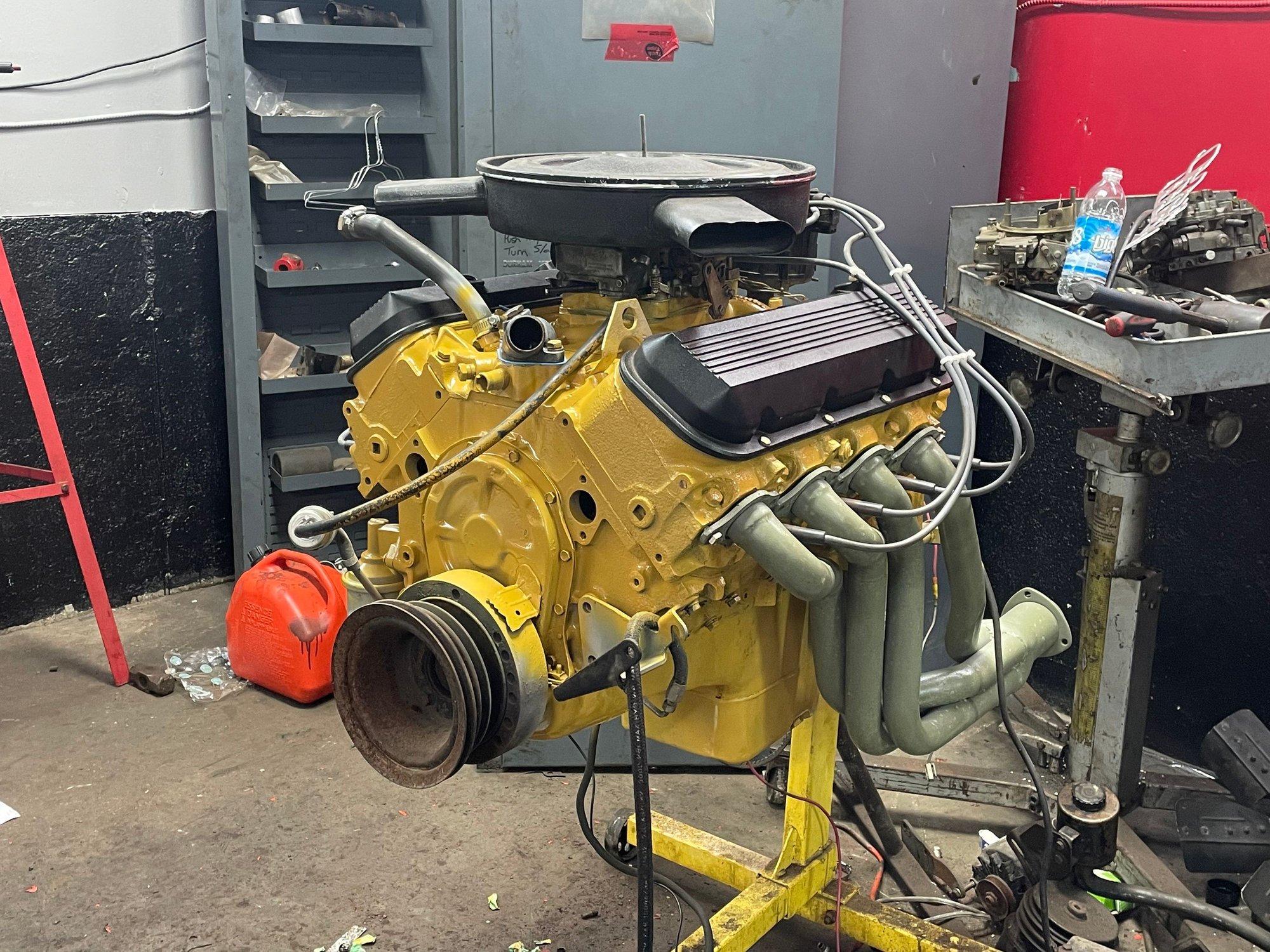

I recently rebuilt my 700r4 that came out of an s10 originally. All good parts installed the good red clutches and band, .500 boost valve, 9clutches in the 3-4 pack and a corvette servo. It’s mated to an unknown peanut port 454 that pulls surprisingly well. Doesn’t slip or have any problems in 1-2-3 shifts into 4th nice but doesn’t hold any real power without the engine revving way out. It cruises at 1750rpm at 60mph roughly and if I roll into the throttle it seems to rev up way more than it should so I dont stay in it for fear of frying the band. I air checked everything during assembly. I dont have lockup wired in yet, It has the stock 4.3 converter. Am I blowing through the converter? Is it slipping? I’ve done it enough to times in the last month I figure it would be toast by now. Any real insight would be much appreciated
