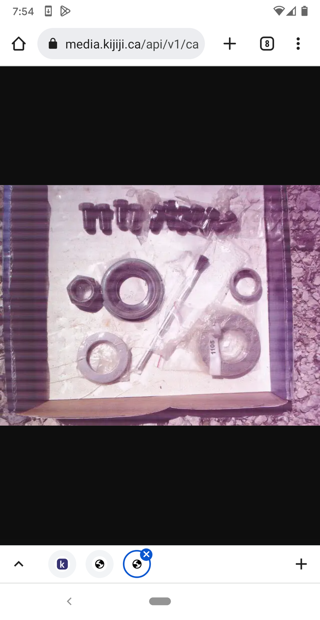

From the ad is a picture of a picture. Lol.
Would there be actual markings on the gears to indicate what they actually are? He doesn't even know the brand.
He's asking $150 cad or about $100 USD for gears and kit, which would be a good deal if they fit.

Interestingly enough the gears have no stamping except for "65" on the pinion.
There are tags with stuff written on them but of course it is mostly missing.
The gears come with a Motive Gear installation kit. Perhaps the gears are Motive? They appear to have been sitting for quite some time.

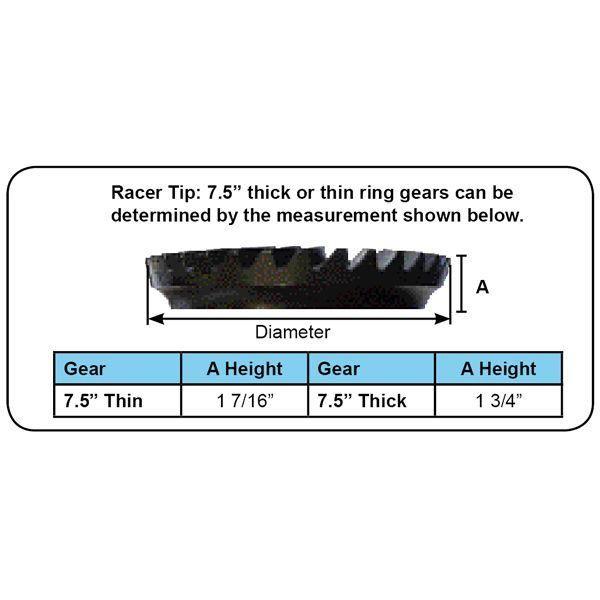

I did find a Motive Gear quick tip chart that lists 7.5" Thin having a 1 7/16" overall height and 7.5" Thick having a 1 3/4" overall height.
These gears are 1 7/16" thick

Looks 3 series (not thick) to me.
