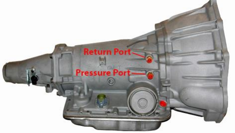

I apologize for lack of context. Here is a better pic. The image above in post #4 was simply a close up of the return line port showing you that there was no insert. This new picture is the passenger side of my rebuilt 4L60E trans case. Neither cooler line port has a brass insert. What I would like to do is insert a Time Sert into each (as the helicoil did not work very well) unless you have a better idea. For the picture I lightly placed the current fitting into the high pressue port. You can also see my steel braided cooler line hose below that in the foreground.

In your photo with the ports labelled, you can see the brass adapter fittings, complete with their hex drive.
You're kind of in a pickle now it appears. Too much "improvement" has already gone on. Most likely the reason the Heli-Coil didn't work well was because the hole in the case, for ¼" NPT with 18 tpi TAPERED thread, was already too big for the ½"-20 STRAIGHT thread. If that fitting is already screwed as far down into the case as it will go, then you've really kind of porked the pooch; you'd have to have a gasket that's near ¼" thick, to seal that. Not sure a Timesert is gonna fit any better, given that the holes are already so ... yeah.
Maybe you could cut or grind that adapter down to where its flat surface would come close enough to the case, to get something or other to seal. Extreme tightness isn't required, after all. It's not a head bolt hole or anything.
Also looks to me like you might want a 45° or 90° adapter instead of, or in addition to, that straight one. After all, the original trans lines had a 90° right there, and then laid against the oil pan on their way to the radiator.
Some history would help. As in, I bought this, it had that in it, it didn't have the other, the so-and-so was damaged, I did ... whatever, it didn't work because ..., then I tried ..., and so forth. Come clean and tell us what's REALLY going on, maybe we can figure out some way you don't have to put your brand-new transmission into a new unmolested case just so you can put the right cooler fittings in it.
Pretty sure that no matter what, that transmission needs to come back out of that car so you can have the best possible chance of an effective repair.

Haha! OK, you got most of it, but here goes. First, the image with the ports labeled is an "internet stock photo" just to show you what my pictures were of. In post #5 you referenced not knowing what my picture was of in post #4, si that's why I added the stock photo. All other photos are my actual 4L60E pix which as I mentioned, I purchased rebuilt to replace a shot 700R4.
The rebuild did not come with brass inserts, just threaded bores. The threads on the top or return port were stripped, so I inserted the helicoil which held pretty good but leaked over time. The bottom or pressure port did not leak, but when I went to disconnect the trans and removed the lines, I noticed that its fitting (the one shown in the large image of post #8 in the bottom/pressure port) rocked/wiggled in place which may be indicative of straight (NPS) inserted into a tapered hole. Not sure on the actual hole type (size, NPT vs. Straight, etc.), I need to start fresh so my thought was Time Sert. However, I would like any other recommendations on how to rebore the two ports, what inserts if any to use, etc. What additional questions do you have? Thank you guys!
