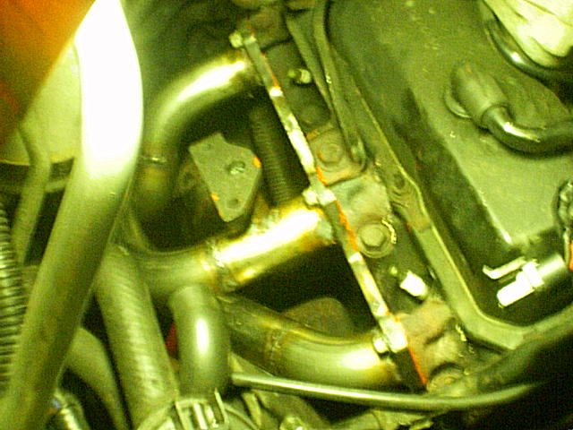

I like it, but I dont know if i missed this or not, where does the EGR find its way into the exhaust gasses?

Heres the EGR all hooked up...

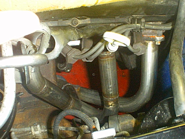

If you guys in CA need the air injection bung it can be done. Pics of the Y-pipe (which is crush bent on this application) will be up later today or first thing tomorrow.
Oh, and before I forget... lets give props to 6speed84z28 for building these. He did a great job and deserves a little recognition. (Sorry Greg, I just had to post this one )

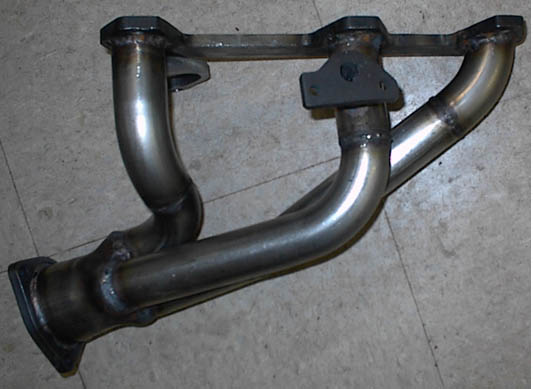

Um, the CHC headers were mandrel bent. What would be the point of "chrush bent headers" IMO, them don't even need to be in the same topic.
Heres a pic of CHC headers posted buy KJ a while back.
Where did KJ go??

From the way it looks to me, CHC headers seem like they would make more top end power. They have more of a J shape in the bends, while these have more of an L shape. In my opinion, these engines need more HP than torque.
Just throwing out some thoughts.

The bends on his are fine, they are not sharp enough to hinder any performance at all. His are longer primaries and look to be more equal length then yours which will increase performance. His flanges are night and day better-no comparison. His are TIG welded- no comparison. Irocs are much better quality. They just aren't painted yet guys.
Old Jan 4, 2003 | 10:25 AM

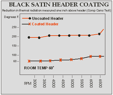

I would ceramic coat the headers,
ceramic coating is a joke kinda, cause you only need a 20 dollar touch up gun and the coating cost about 30 bucks, and you just air dry them. same coating as getting them sent out. 30 bucks worth will do a set of sb v8 headers and a set of heads.
only chrome ceramic coating needs baked.
Thanks for getting my back there...
As far as the finished look, these proto's are stainless. The only options here are to grind down the welds a little and polish them, or to have them coated. The steel ones most of you will be wanting can be painted or coated. That raises another question to you guys... Would you want them delivered to you painted or would you want to leave that up to yourself? I think the answer will be painted, but lets just see.
Hey CHC... what do you think of these? Don't hold anything back
