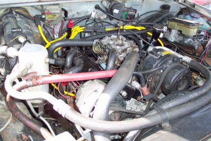

ok.. I have a question then... I'm planning on swapping the 3.4 into my 84 bird... will the 95 3.4 flywheel work with the F body tranny?
Thanks,
Keith
Old Jan 16, 2004 | 04:39 PM
  #71
KED85's Avatar
Posts: 7,604
From: ****SoCal, USA****
Yep!
IF ya got a carb'd 2.8 here's what it looks like in end.....This is pic of my Blazer engine bay w/3.4
