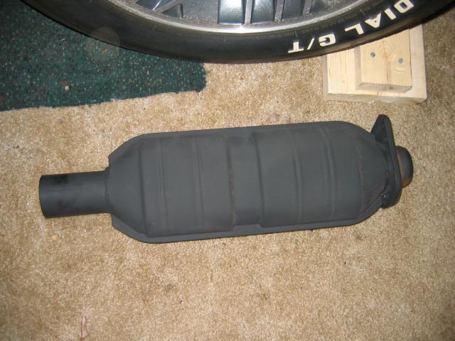

Does anyone have any real HP numbers for the 2.8s???
I have done a 2.5/3" intake using custom 3" aluminum tubing and a GN intake pipe, 2.75" exhaust all the way back, crappy Thermomaster HyperTech chip, and make sure the engine is tuned properly and I can easily beat down my wife's 3100 GRand Prix, which is still nothing to sneeze at...
I have been accused of sporting a V8 on a couple of occasions before, and actually had to pop the hood to proove myself.
Oh, and I forgot to mention my homemade "cat"...
