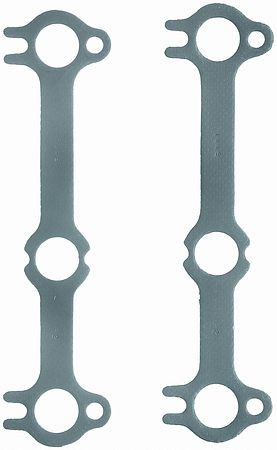

Thanks Kryppy, I thought they didn't. If anyone needs to know a good set of gaskets to order so far these Fel-Pro ones have worked for me. I bought them at Summit, http://store.summitracing.com/partde...0&autoview=sku. I attached a picture of them. They are for an 80-86 2.8L motor but they are way better than the gaskets I have found so far.

Puntank, where did you get the locking header bolts from? Also which FelPro gaskets did you use? I just changed the gasket on my driver's side and it's still leaking on me.

I replaced the header gaskets again. It looks like I had not matched the gaskets with the ports correctly the first time. So I bolted everything up and there still is a leak. The leak is from the catalytic converter to the y-pipe. Would a leak there still making a ticking sound? I am to the point of just throwing on the old stock headers and a stock y-pipe and calling it quits. Either I am having problems with the cheap gaskets Pacesetter included or leaks. If anyone has not bought these things I advise you not to get them. It's not worth the agony.
