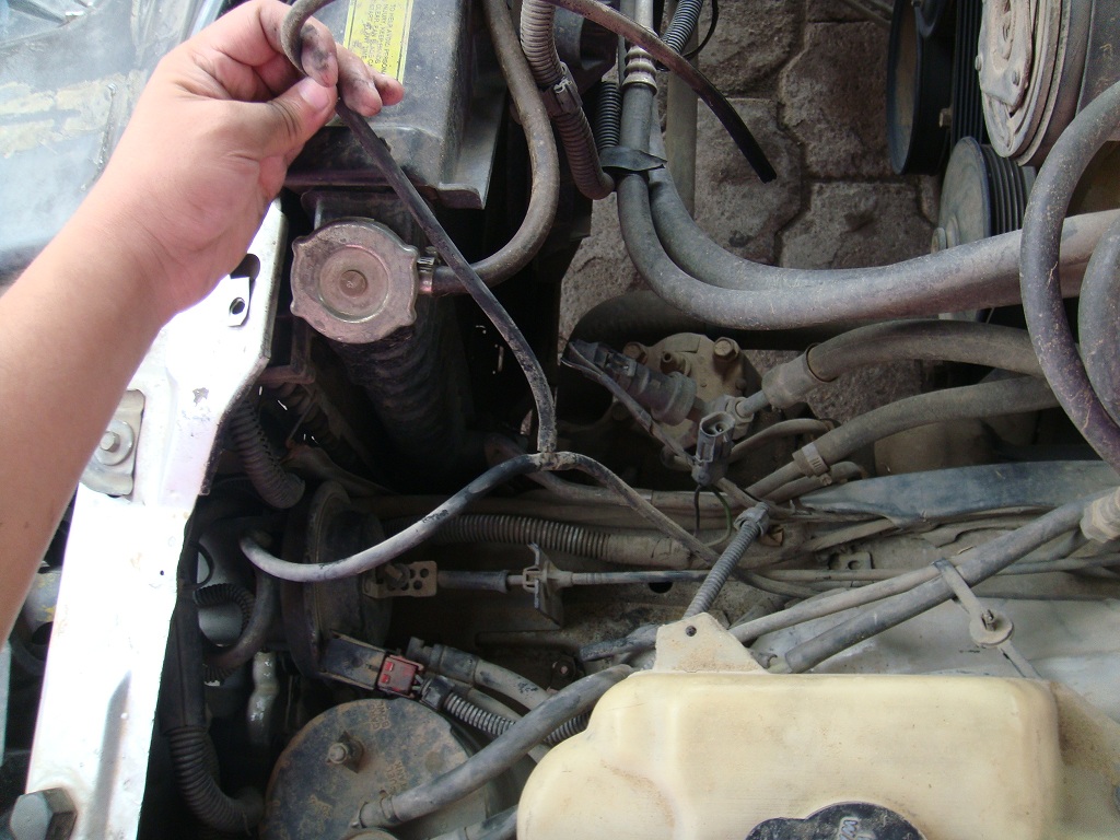

Hi, i need some help here.
Well, i have a lot of troubles with my car (for a newbie i think), have bad egr solenoid, bad maf, (codes 32, 34) i im getting like 12 mpg, the engine is the 2.8 mpfi and 700r4, wich i think is bad, the ses light comes only when im driving on highway at 50 or 55 mph and release the gas, just going whit the impulse, well also i have noticed that the cars runs much better when is cold, and when are warm days, i push the gas and it seems like im not, it has bad acceletiion, i also noticed a a whistle vacuum leak, and in the pictures i show you one hose unplugged, i was gonna replace the egr solenoid but also i was reading thar the egr system only can affect the mileage for 1 or 2 mpg, so i think thats not the trouble,
thanks, javier
oh i forget these pics are behind the egr solenoid, next to the wall
Attached Thumbnails Hi, i need some help here.-dsc01137.jpg   Hi, i need some help here.-dsc01138.jpg   Hi, i need some help here.-dsc01139.jpg

Did you set up the EGR the way I told you since you can't get the solenoid, or did you try a solenoid from another car?
Do the cabin vent controls work to put air out of each vent when you move the top lever along its settings? Does the heat work constantly? That unplugged hose is for one of 2 things. It's either for the inlet to the ventilation controls or it's the vacuum source for the heater core bypass valve by the alternator. Also, does the blower work on High? If not, then you need to find the other half of that red connector as that is the power source for the high blower relay by the blower motor.

Ok, first at all, thanks maverick for allways answe my newbie questions, well i have putted the egr valve as u say, and im gonna leave it for a while, and i see how the mileage is going.
i have taken another pics, so, the hose unplugged comes whit another, wich is conected to this split? one side goes to the back of the manifold,

OK I'll give it a try; first for your EGR, are you sure it's the solenoid? Is the little vacuum line between the switch and valve in good shape?
I agree w/Maverick that the vacuum hose from the firewall is for the heater controls (between defrost, panel, heater, etc)...
The vacuum hose by the radiator comes from your ball-shaped vacuum tank which is inside the fender on the driver's side. it might be so simple that the hose fell off the vacuum tank. Take off the driver's side tire and take down the plastic inner fender liner to see the vacuum tank. My Firebird has the battery on that side, and my vaccum tank is rectangle-shaped and on the firewall, so I can't help much more than that. Someone with that vaccum ball has to go out and look at their car to help.
Do you have a sticker underneath your car's hood with the vacuum line diagram on it? That would help with the melted hose (replace the hose!) at the back of the engine... or hopefully someone can go look at their car and help.
I don't even recognize that connector by the radiator either...
I guess I'm not much help but if you have that sticker under the hood it would explain where all the hoses go!
They must have changed the vacuum tank ball between 86 and 87... My 87 Bird has the ball under the battery and nothing on the firewall as a vacuum tank. The line that would be running to it (the ball is gone now... broke the mount removing it and the battery tray is shot) would be T'd into a check valve and the side outlet of said check valve would be the vacuum source for the HVAC control head. And of course, the inlet to the check valve would be the small side of the T where the brake booster connects.
The earlier cars had 2 connections for the HVAC blower motor, one being ground and some connection for the resistor pack, and the small gray connector coming from the junction block by the headlights for the high speed blower relay. The gray single wire connector looks like what my connection for the high blower relay used to look like before I put the terminal inside the larger connector (with the ground and other wire) as is used on the later model harnesses.

Well, thanks for answer, and yes i have the diagrams, one of the vaccum diagram, other of the emision hose routing, i checked today, all the hoses are plugged right, seems to be ok, no signs of leak at idle, (the only leak i ear is always, when i start to push the gas, then i cant hear it anymore when the rpm goes up, by the sound of the engine), i took it to the mechanic to a better inspection, he sayed that there are no visible or audible leaks, but he suspect that the problem is the iac, he start the engine and then unplugged the pin, and say that the engines had to increase or decrease rpms, and nothing happens (he says that is like there are not iac detected by the ecm), but it has no ecm codes for the iac, so, about the egr, i applied vacuum, and the valve retains the vacuum very well, and the diaphragm moves ok, i think the valve is ok, tomorrow im gonna test the solenoid with the battery and che also if is necesary if its energy on the wires, (here a funny thing, i was playing whit the battery i purchased to test the solenoid, and it has no charge! xD, so the test doesn´t work) (right now egr valve its conected like maverick recomend me).
the maf, i cheked it and the orange thing its flat, but it was dirty, i cleaned, (with electric cards cleaner) and tomorrow, i`ll see if it works, if not im gonna replace the relay,
Last thing, forget all that hoses of ac.
