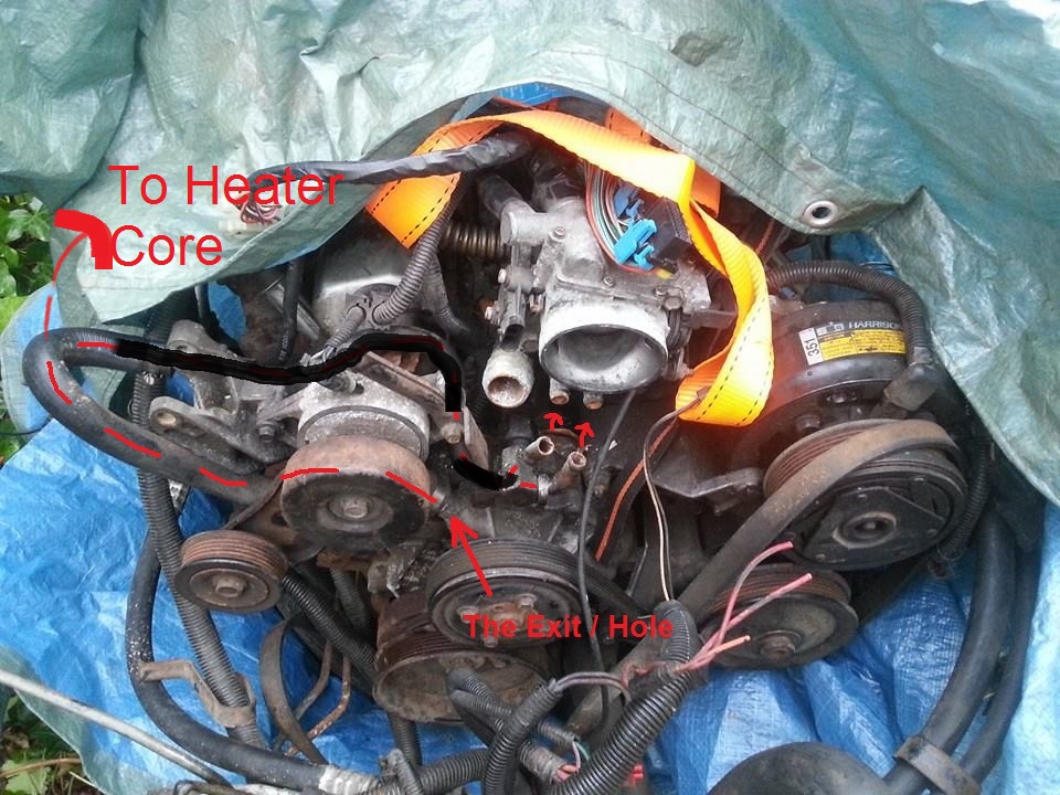

Wait a minute!! Isn't the exit on the waterpump supposed to be connected to the holes on the throttle body through some hoses and a pipe that splits near the end?
Edit: Here I'm showing with a quick drawing how I saw it is on my spare / donor engine, could it be I connected it completely wrong? And should do it this way instead (the way it is on the spare engine)? And do I need to connect a hose or something at the back of the engine (by the firewall) as well? Have I possibly been flushing the wrong thing with water?

Re: Small Exit on Waterpump
The right one is the inlet into the throttle body and the other is the outlet from the throttle body that goes into the block
Old Apr 29, 2014 | 03:13 PM
Renier's Avatar
Joined: Sep 2013
Posts: 184
From: The Netherlands
Car: '89 Camaro RS
So you are saying the small arrow on the left should be the other way around then? But the rest is as it should be? Thanks for the additional information, makes sense now! ;]

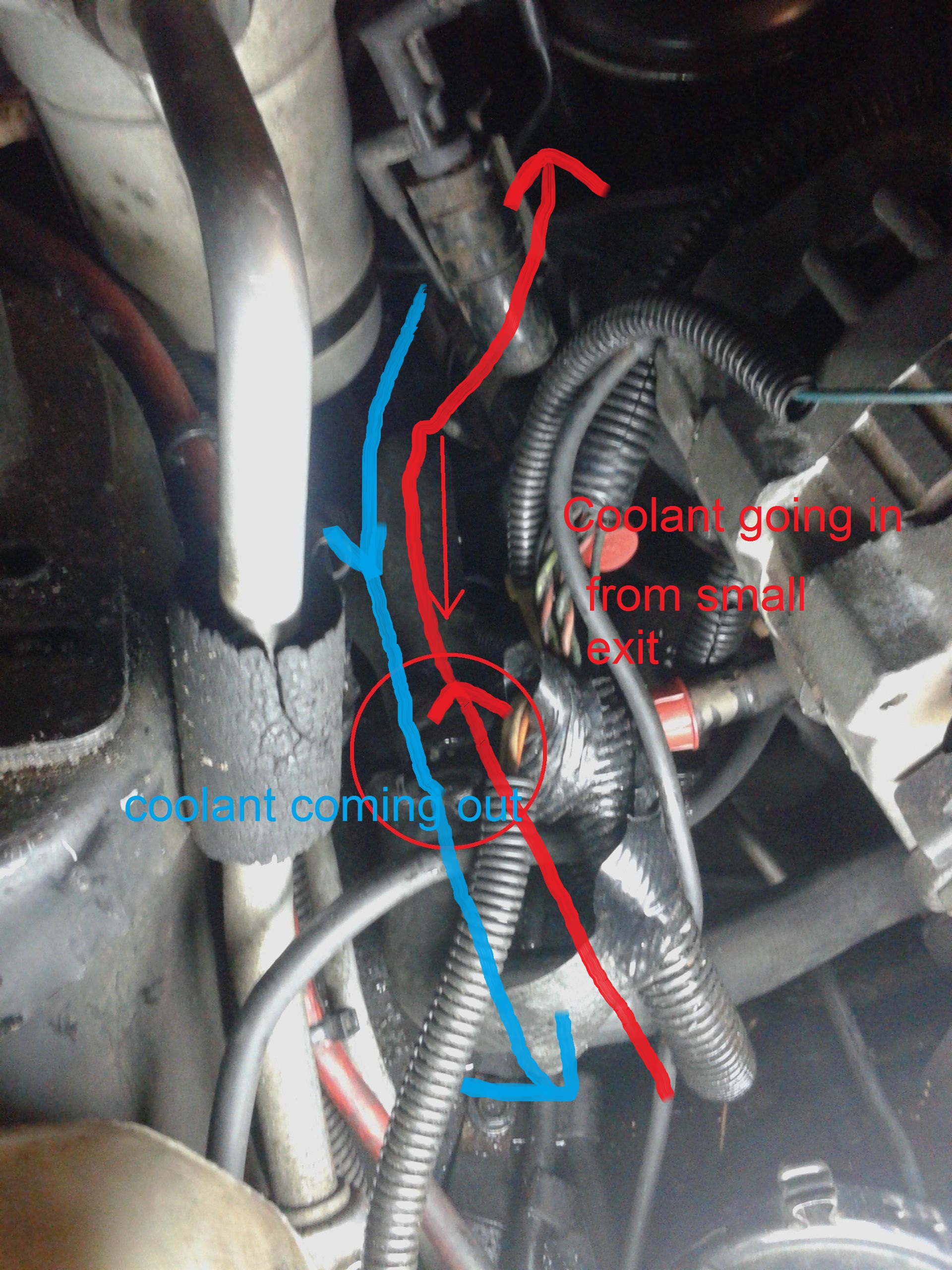

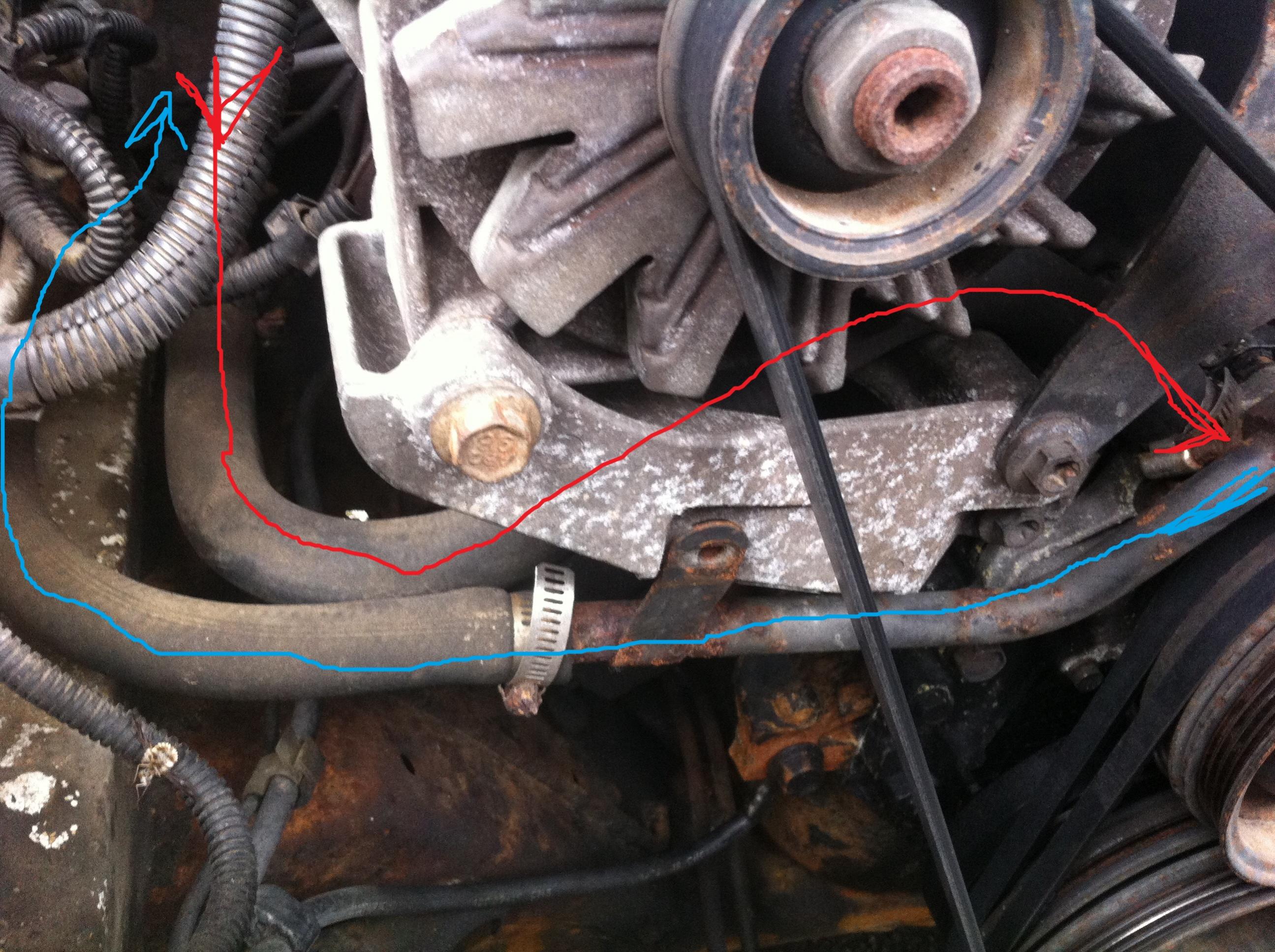

also that hose that comes out of the exit hole is suppose to go to the heater core.
Attached Thumbnails Small Exit on Waterpump-engine-3.jpg   Small Exit on Waterpump-engine-2.jpg   Small Exit on Waterpump-engine-1.jpg

This should answer your question about the other two hoses that aren't connected to anything and just leak.
Old Apr 29, 2014 | 05:26 PM
camaroyoungster's Avatar
Joined: Aug 2011
Posts: 280
From: Wisconsin
Car: 1985 Camaro Sport Coupe
Engine: Chevy 3.1
some more pictures better explaining it.
Attached Thumbnails Small Exit on Waterpump-engine-fixed.jpg   Small Exit on Waterpump-engine-fixed-2.jpg
Old Apr 30, 2014 | 03:42 AM
Renier's Avatar
Joined: Sep 2013
Posts: 184
Car: '89 Camaro RS
Alright, great, man! Many thanks, couldn't find this anywhere, even the repair guide used a generic illustration of a cooling system that did not add up at all, so this is amazing. But the current setup I have is like a heater delete setup or something like that then? Again, many thanks for the illustrations, will further examine it once I get home from work!
