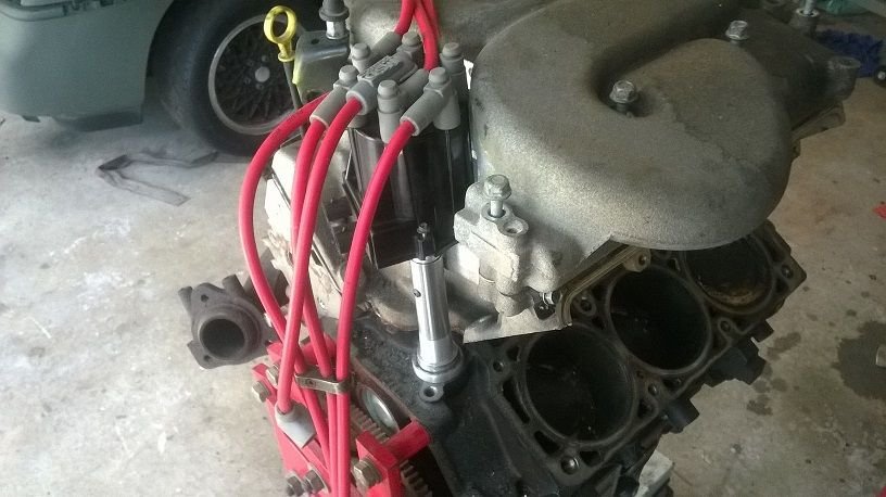

That was pillsbury10's car. I saved some pics of his set up. He modded a 3.4 intake to work with a distributor

Another question I have is anyone have any pics of some ported 3.4 heads? Or even inside the ports of stock heads. I do all of my own porting and plan on cleaning up the heads. Also, what size valves do they come with? Would it be advantageous to up the valve size? What springs should I go with?

Re: New to the V6 world, have some 3.4 intake/ exhaust questions.
1.60" Intake / 1.43" Exhaust
No, just clean up the bowls and runners thoroughly...
Depends on cam size and if you go boost...
Edit: I measured a set of 3.4 valves I had lying around RF, in case you were curious.

Can you use a distributor with a 3.9? The intake looks like it's recessed enough for one to fit
Old Aug 15, 2016 | 06:45 PM
Shaun41178's Avatar
Joined: Jan 2015
Posts: 72
it does fit but it takes a bit of machining but nothing too crazy. A dremel could probably be used.

Wow, that's nothing a dremel tool couldn't fix..
Old Aug 15, 2016 | 10:18 PM
robertfrank's Avatar
iTrader: (27)
Joined: Apr 2004
Posts: 3,001
Likes: 62
From: Salt Lake City, Utah
Car: 1988 camaro "SS"/ 1991 305/T5
Engine: 383 LT1 in progress/LT1TBI 355 soon
Transmission: Probuilt 700R4 3600 stall/ T5
Axle/Gears: Moser axles, 3.42 Eaton Posi
What distributor is that?
shout out to me lol...might be the only car with that setup. so theres that lol
