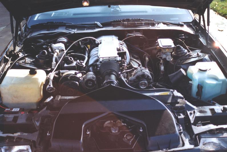

hey tis is how mine looks ... though mine is a v6 ... ibut same intake
i opended it and found under the 2 filters i have like a airbox and flap that u said .. remove flap using screwdriver... done and what didya do next... cut the bottom of the air box....

pull the whole air box out, and there should be a plastic bar about 1/4" thick running through the middle (more air restrictions!) you should cut through the whole thing right about that point-actually, i cut just below it, and then cut the bar out after.
also, while you have your air box out, you can see what else is in the way of air flow, mine has the fog lights like i mentioned earlier, , so there is a plastic gaurd that also blocks outside air, but i think im going to cut that too.
hope this helps

looks like we are mining our way...
ur right i ahve a plastic shroud ,... and i dont have a z28 grill w/ fiog loights i have teh standard grill
anyway thanx ....
have u cut all tat out ... does it pull better???

mine gave me, imo, a small, but noticeable improvement, but i didn't get to enjoy it for long, b/c the intake decided to leak.
since i have it all apart again, i might go ahead and remove the plastic cover that comes all the way back from the fog light cover.
(if you can find one of these, i recomend it, b/c it will let more air in, i put one on my 91 rs, but it had the tbi, so it was more for looks)
let me know how it runs

tell me this belowthe air box there is a black support / plate ... no foglamps
.. i dont think i need to cut the whole thing as i believe it holds some part of the front groung effects together
do u think i should cut it???
and how the hell didya intake leak??????

underneath my airbox, there is a piece of black plastic that comes back from the fog light housing, it looks like it directs air into the radiator for cooling. i might cut a small hole in it. it shouldn't affect the structural characteristics, at least i hope not
my intake started leaking b/c the hack that did it last didn't check to see if the manifold needed planed (aluminum parts on cast iron requires special attention to sealing), plus they probably didn't remove all of the old gasket. i can't wait till it is running again, there are several people that wanna race
