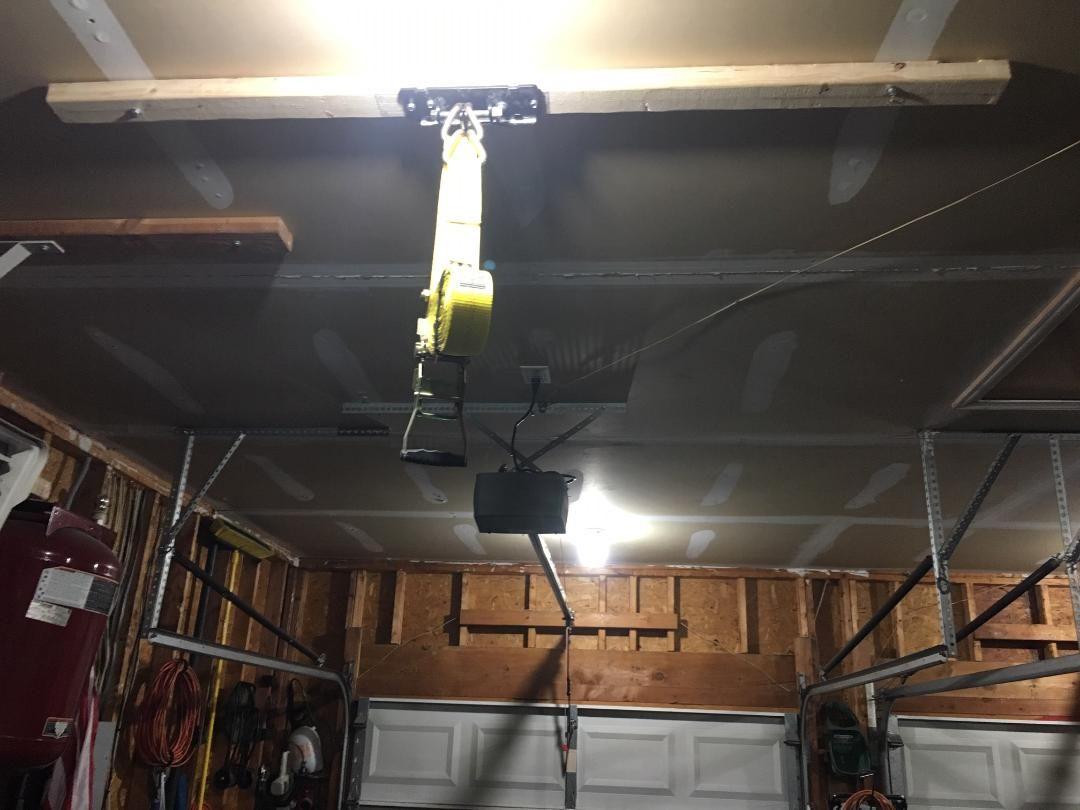

You will need to remove or disconnect the motor mounts and lift the motor up as high as you can get it. Check for anything else that would restrict it from being raised. You can use an engine lift, but be aware you will have to deal with the legs of the lift, getting in the way. I used a 2x4, lag bolted to the garage ceiling joist, with a ratchet strap and a hook, to raise the engine up.
