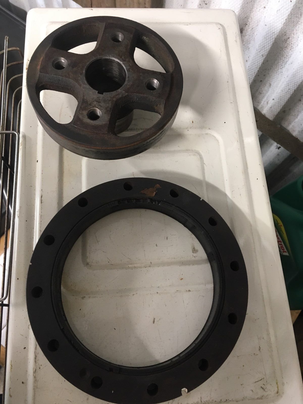

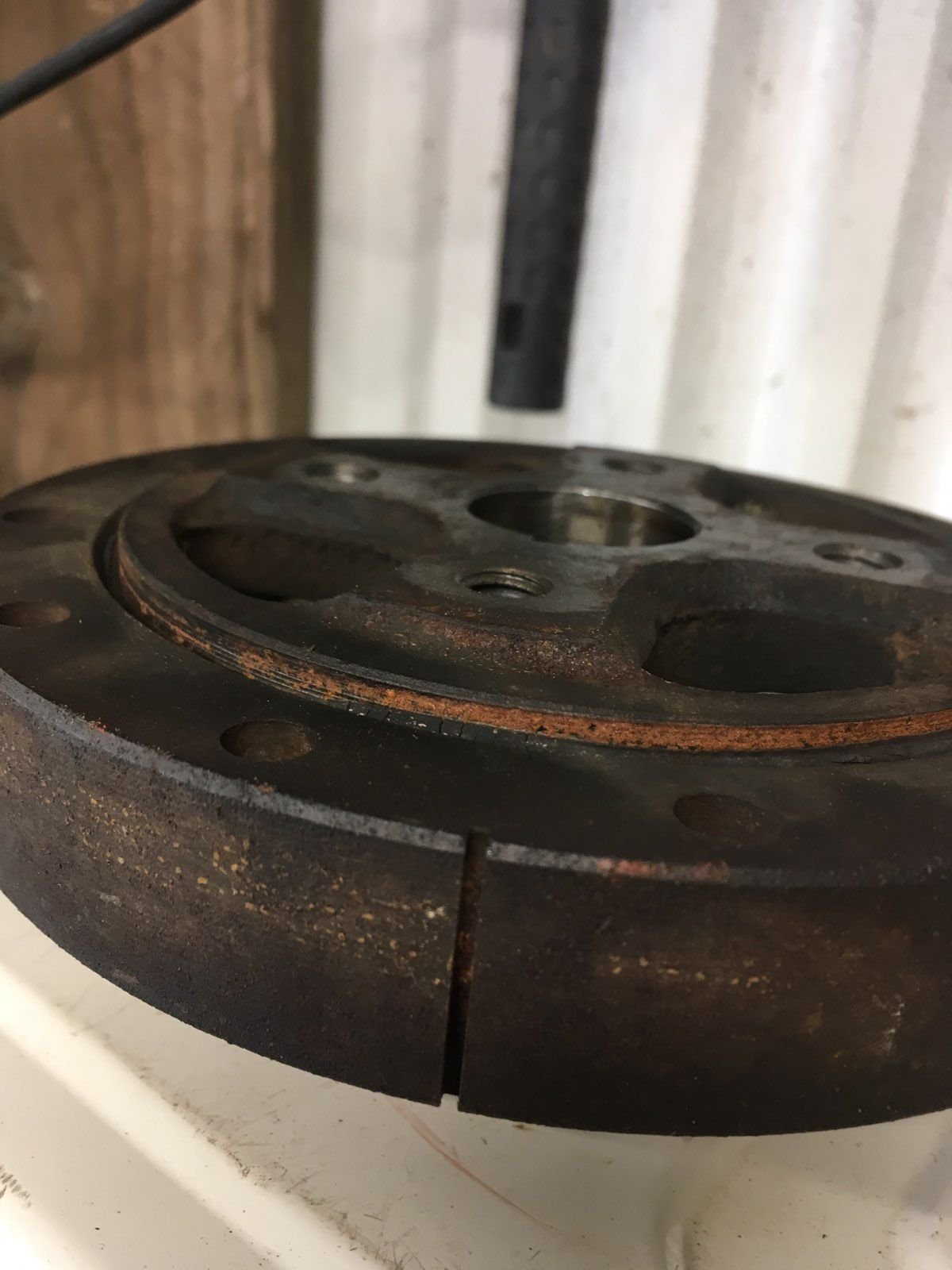

Your timing is correct as per the mark on the harmonic damper, but, , , is the mark on the damper in the right place?
Crazy I know, , , but, there is an all too common failure of the damper where the rubber holding the two pieces together deteriorates, and allows the outer ring (with the timing mark on it) to slip out of it's proper position with respect to the inner piece (hub) , rendering the timing marks useless. If you find the engine runs OK at some other setting than what the timing marks indicate is proper, you just may want to investigate whether or not your damper has failed.
Some pics of what I describe, this one, from a 2.8 V6, had slipped SO badly that the outer ring literally fell off of the hub

I can say with certainty that the timing mark IS in the correct location and i have just double checked the circumstance you described to not be true in my case
