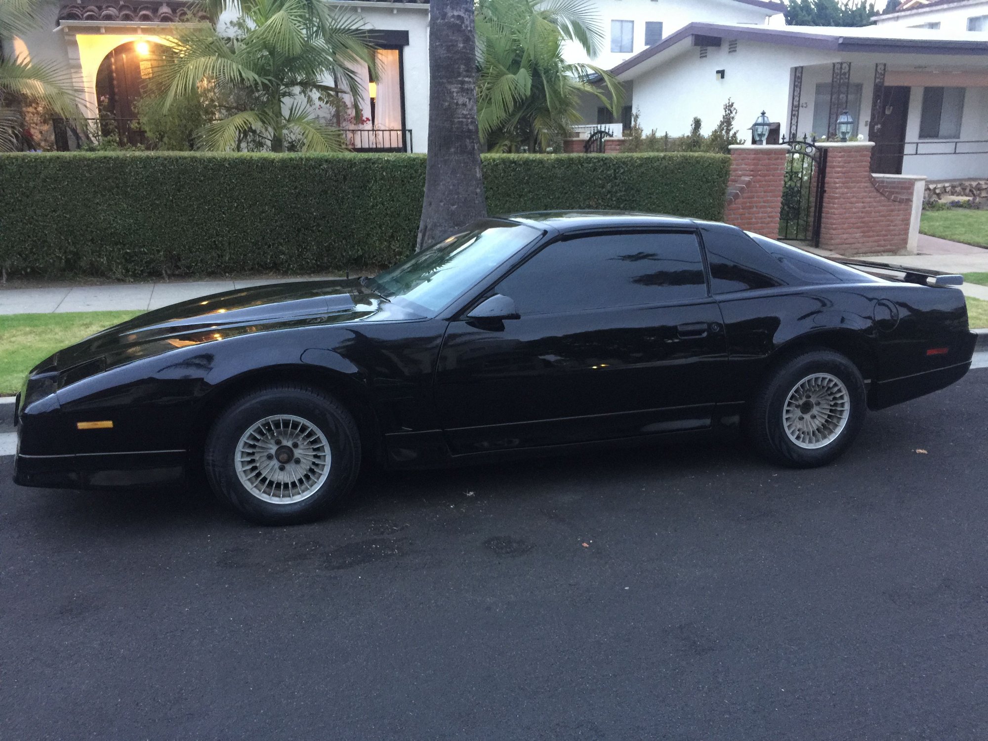

Alright.. this stuff is INSANE - i tried it on my 14's - I think i got great results.
I mean just look at the distance shots...
Whats left looks like brake dirt or something else, it comes off with a brush.
I'll tackle that tomorrow.

FYI - I used a 1 to 5 mixture, each wheel was sprayed with a spray bottle and then power washed after about 20 seconds. I did each wheel 5 times.
