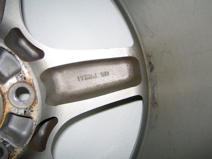

So I see the Ronal/Firehawks are all 0mm offset, and the 17" GTAs are all 12mm offset. Why the difference? Is it just a random difference, or is it on purpose. Since Hawk's brought 'em to market, I figured they were to their specs, so it was probably on purpose.
I know the GTAs are 9" vs. 9.5" for the F'Hawks, and I haven't done the EXACT math, but I just figured 0mm all around was pretty much the accepted thirdgen aftermarket offset, without running a mismatched set like stock.

Hawks are 17x9 too. IIRC, The spacer is for use with standard 10.5" brakes.
On their website, it states the Firehawks are 17x9.5
Old Nov 17, 2017 | 11:45 AM
TTOP350's Avatar
Posts: 12,233
Likes: 1,166
From: Il
Engine: 4++,350 & 305 CIs
Re: Firehawk offset vs. 17" GTA/crosslace offset
That's total wheel width, just like GMs wheels are 17x9.5 but for tire measurement it's 17x9

9.5" is the mounting width, the actual width is more in the 10.5" range. What is stamped on wheels is the measurement that the DOT approves and has to follow certain rules. Most wheels (from outside of flange to the other flange are in the 1" larger than stamped range - although some truck wheels can be closer to 2".
Ronals have the BS they do to make the Brembo kit (optional on the Firehawk) fit flush up front - using stock brakes and even some aftermarket you need the spacers.
The 17" GTA wheels are not meant to fit 3rd gens - they are more of a "universal fit" - they fit 2nd gens, late g-bodies and many other GM cars. 9" is narrow - but some of those cars cannot fit a 9.5", so they chose 9".
When one says 0mm - it means nothing, just that the wheel mounting flange is exactly in the middle of the wheel barrel. When you say 5.25" BS on a 9.5" wheel (which also happens to be 0mm), it tells you a lot more.

Ok, apparently, my memory is seriously slipping and in this case, I'm part of the wrong info on the interwebs.
I just measured my 1991 firehawk wheels. total width is 10 1/8th inches. Bead area is a bit larger than 9.5 inches.
Sorry for the wrong info earlier. I'm going to go on a wheel measuring spree for a refresher.
