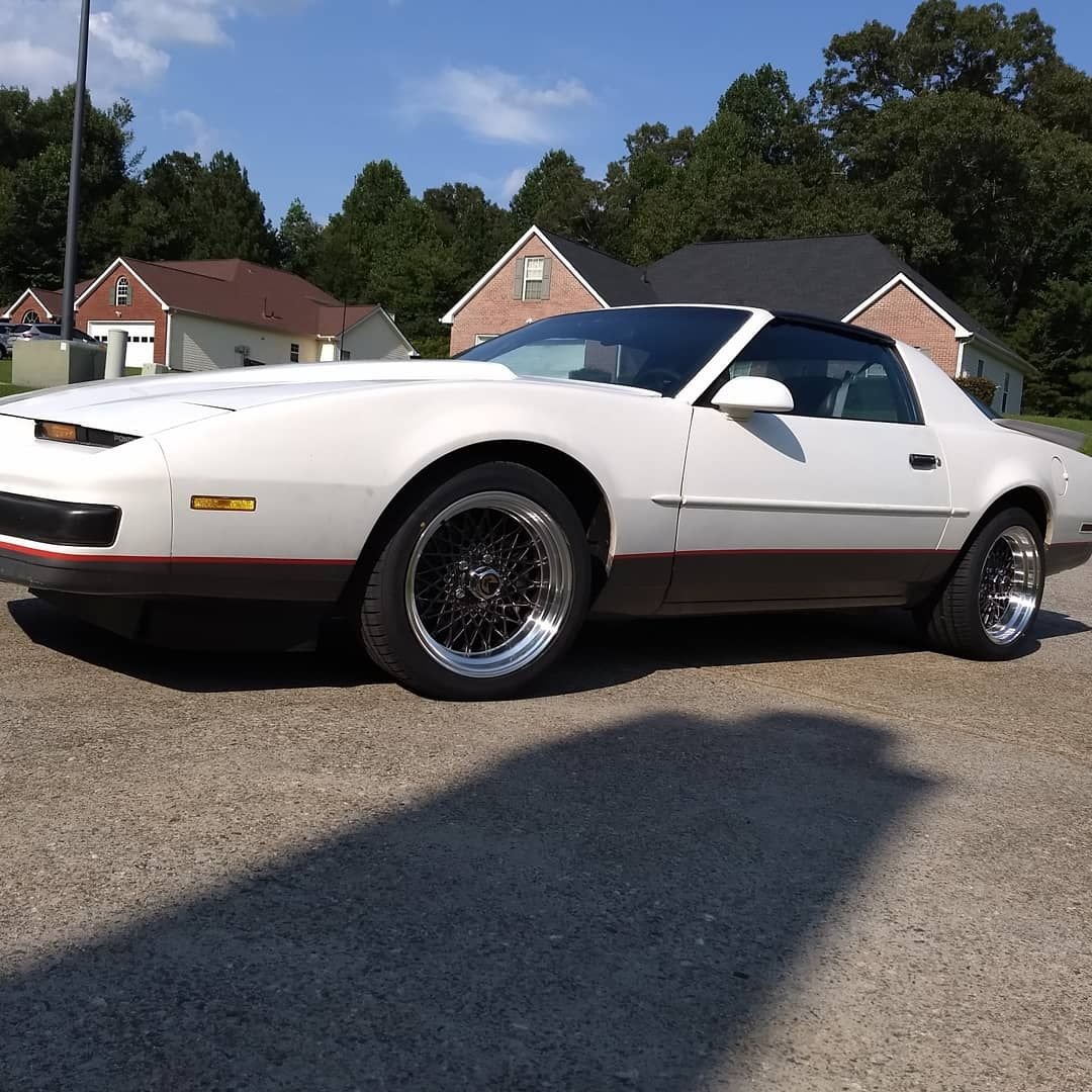

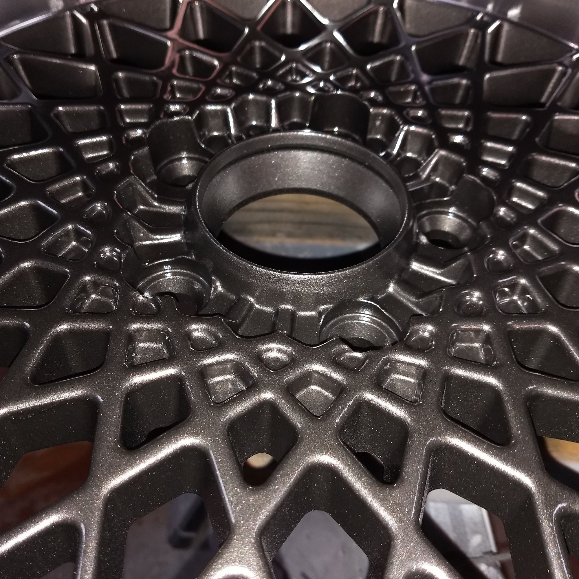

Obviously the first thing you do with brand new wheels is media blast and repaint them. But I wasn't a big fan of the black and liked them matching the bottom of the formula. Falken 512 tires, bmr lowering springs, bmr kmember and a-arms. Adjustable panhard bar. Stock style struts.
I did 255 40 17 for handling more than looks. They are much more silver in person I can't get it to photograph.

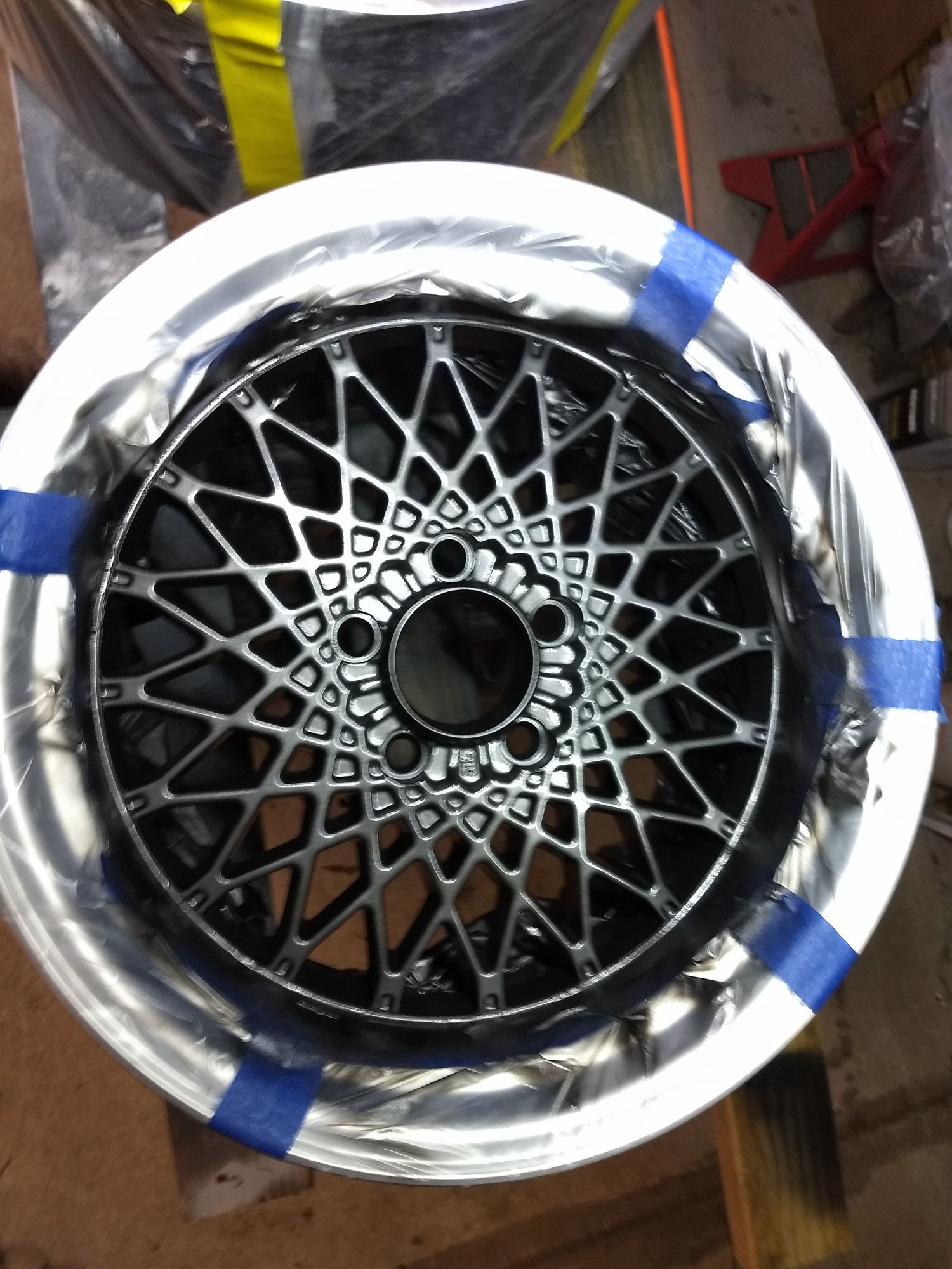

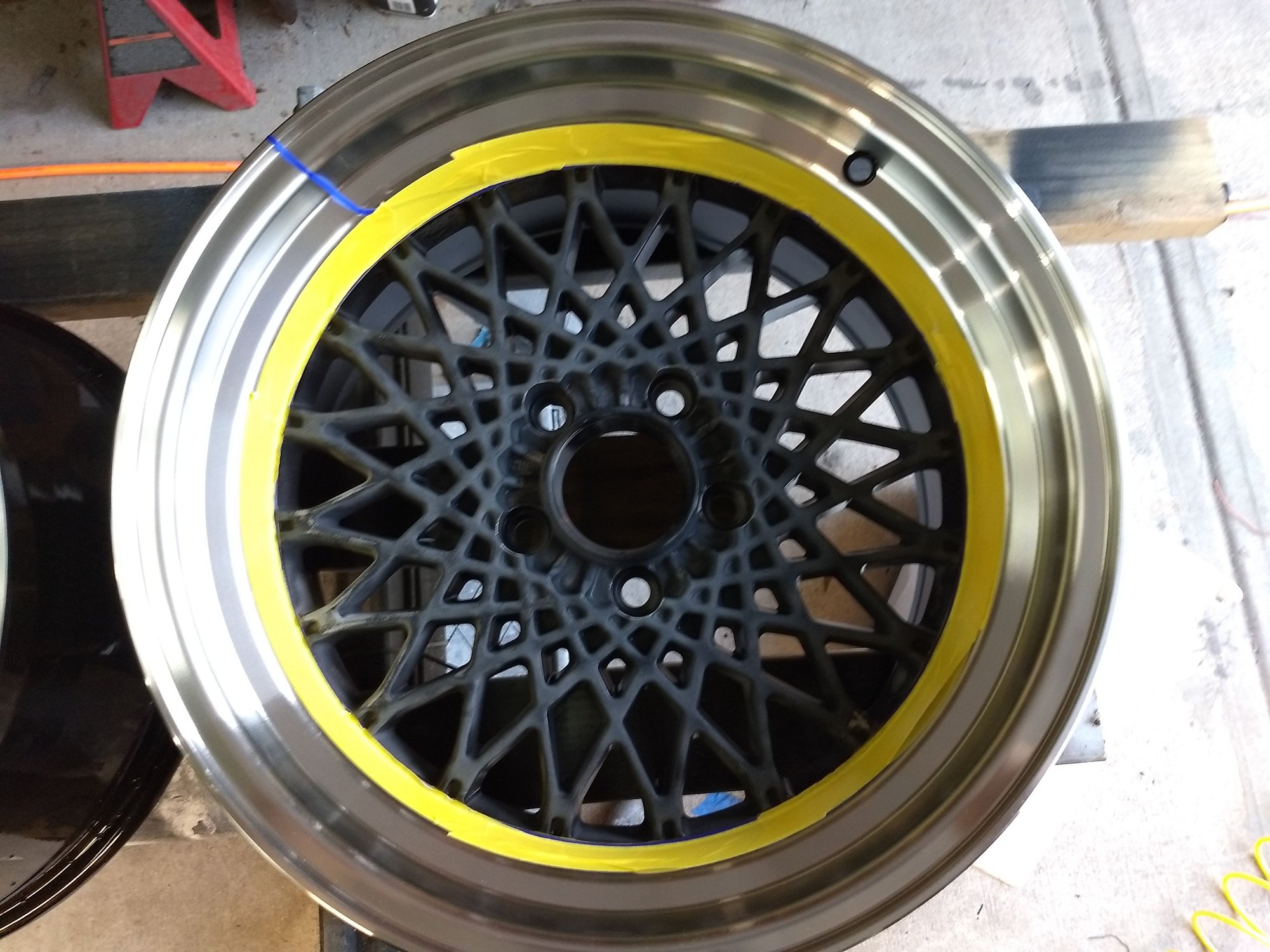

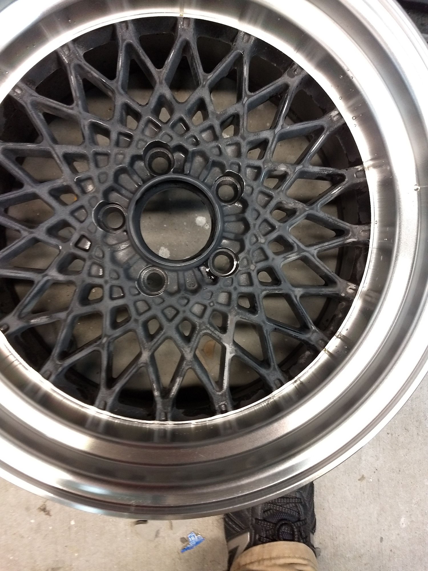

Aluminum oxide blasted to prep the paint surface, shinny surface was tapped up while blasting.
.25 inch tape for the hard line
Tapped up
