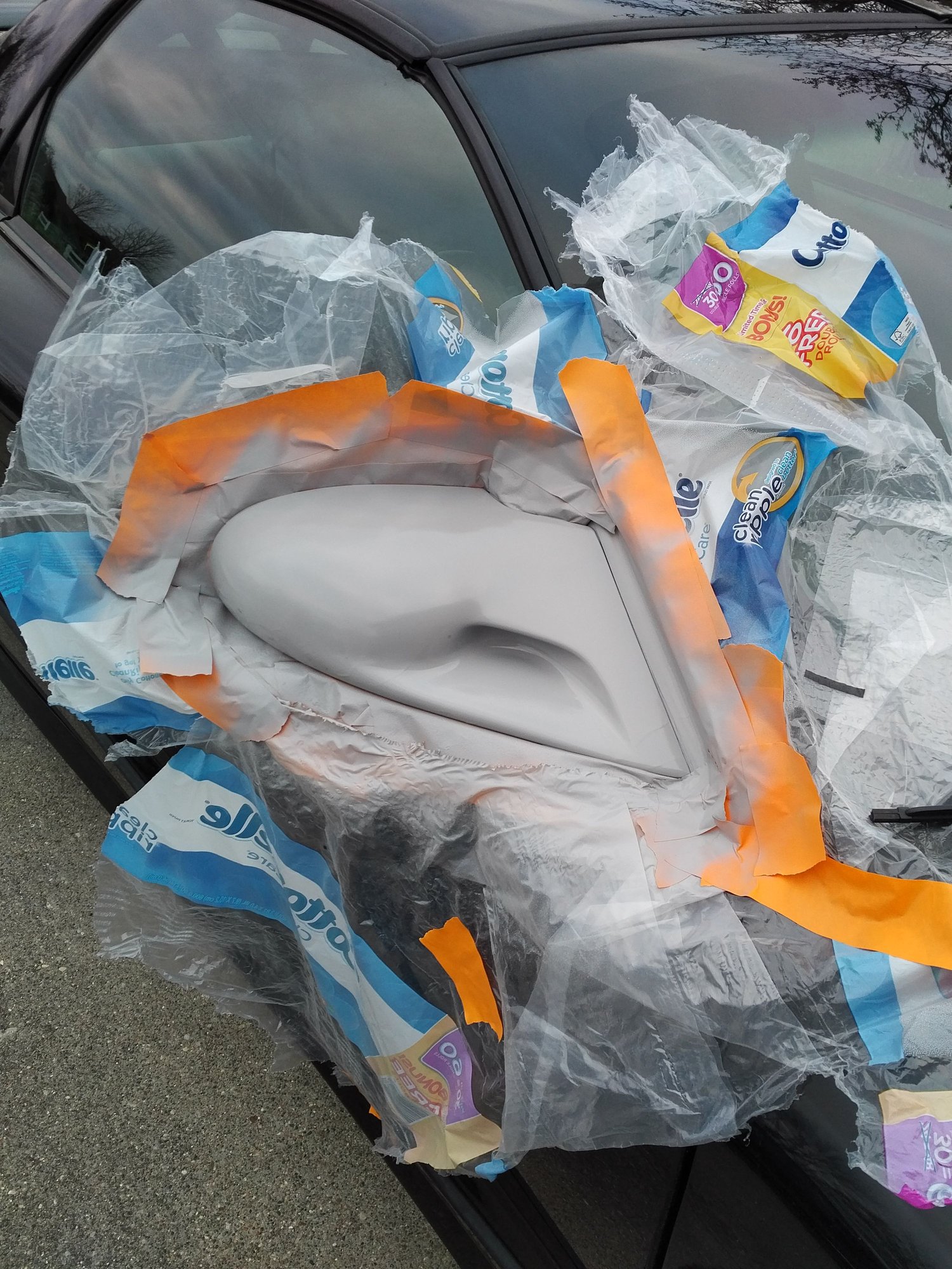

My 99TA's side mirrors looked bad. Clear coat peeled off and paint weathered flat black. I was quoted $300 for a pro to repaint mirrors - which I think indicate the project wasn't something he wanted to fool with.
Picked up some scratch filling primer, black & clear coat. It was so bad it's not like I could make it look worse - I hope.
Replace the red can with GM Black
Nasty driver side, 400 grit wet sand followed with 1500 grit and wiped clean.
Nasty passenger side. Same process.
Ghetto masking with plastic bags and masking tape. Light coat of primer. Two coats.
Repeat
The primer sprayed very well for a rattle can after shaking for a minute. Two thin fine coats. Primer leveled nicely.

I was pleasantly surprised with the primer coat.
The moment of truth color coats. Shook can for a minute and followed directions.
Two light coats
Will wet sand in a week and then clear coat
I am very happy with how well the Dupli-color sprayed and looked afterward. Next week will wet sand and clear coat and post follow up.
