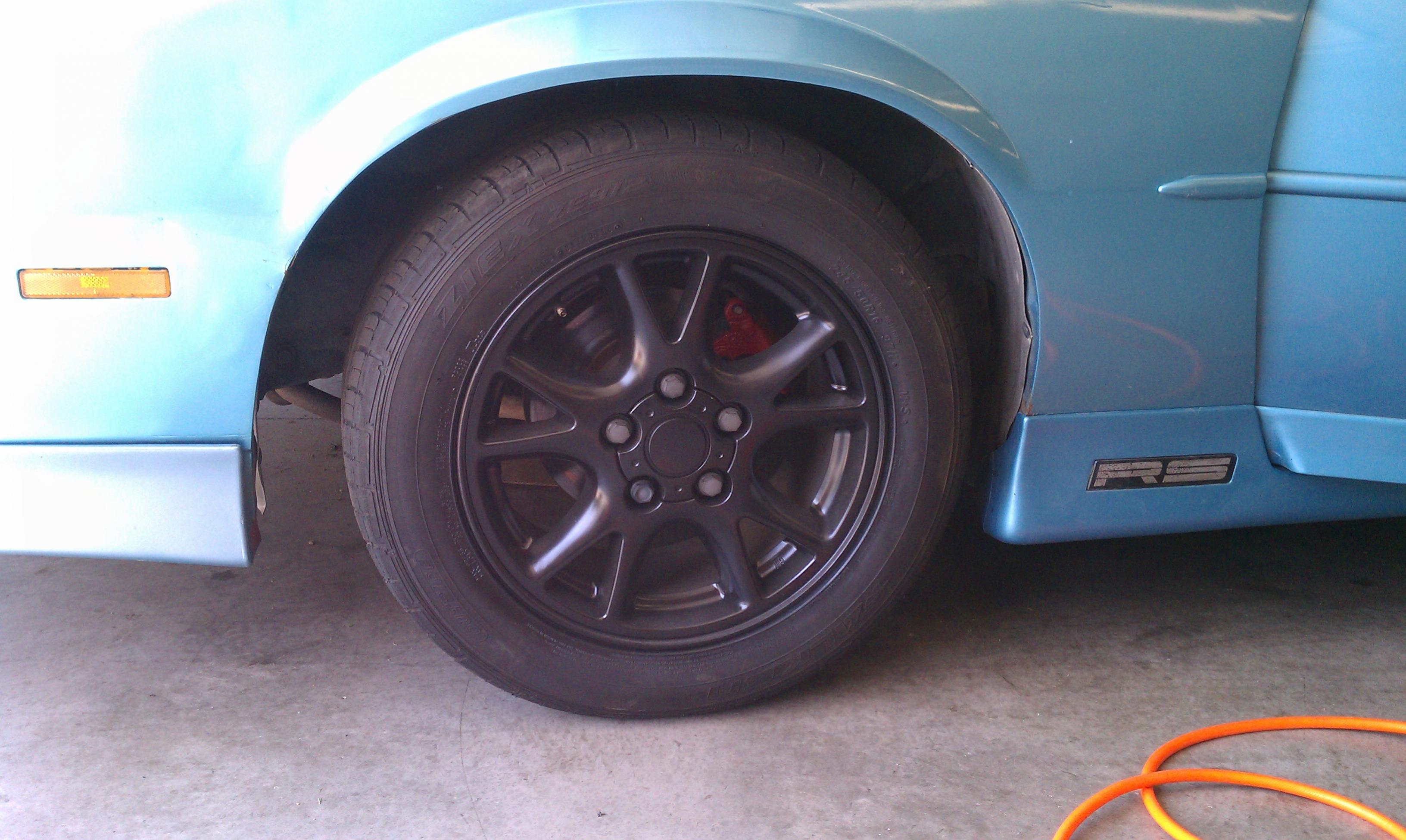

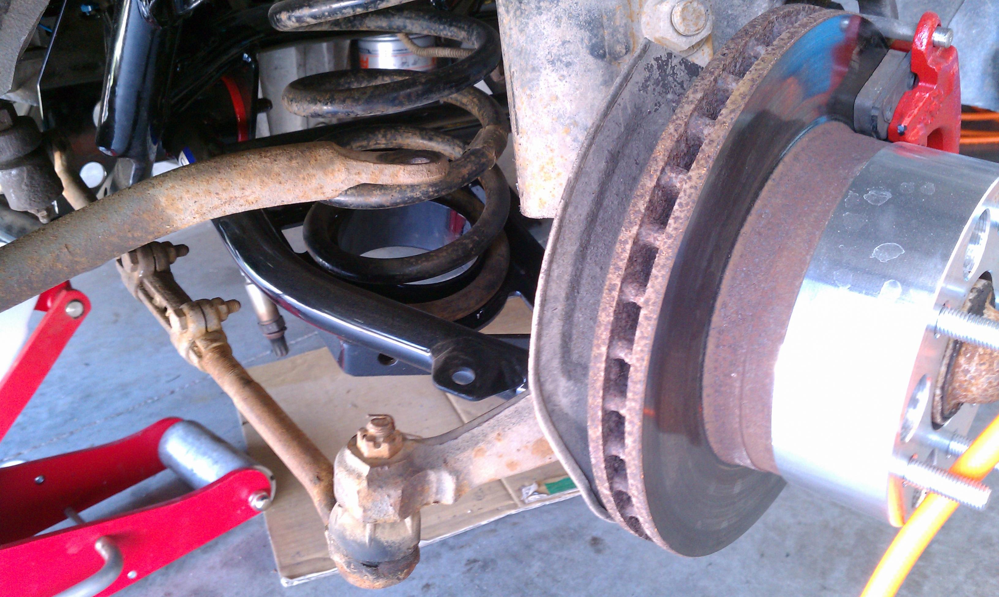

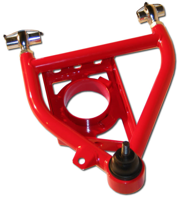

So I bought some Spohn Tubular Non Adjustable A Arms....
Put them in, and then my tires rubbed in the back when turning... not a problem before when I had the stock A arms in...
Posted about it, and told by some it had been discussed many times before (I never heard about it) and told by others they currently had the same problem... and told by some I was full of BS....
Anyway... Emailed them a few times... chatted on Ebay and was told to send photos to their email to review... I did... They never got a hold of me... They never proceeded to contact me after many attempts to contact them...
Some users with their K member's posted some problems.... the person that ended up buying my Spohn A arms bought them because after installing his Spohn K member and stock a arms, he had the exact opposite problem I had... his wheel were moved forward in the wheel well...
Full info here...
https://www.thirdgen.org/forums/susp...now-tires.html
Anyway.... Posting this so that fellow members of this board can stop getting screwed for hundreds of dollars or more while Spohn silently take our hard earned cash and do nothing in return....

I'm the guy who bought your control arms. I finally got them installed and now my wheels are to far back. Car isnt running yet so I'm not sure how much of a problem its going to be but it moved them quite a bit. Spohn ls1 swap k member with spohn control arms.

I already pitched my stock a arms, but I can tell in my situation its the a arms. my car was fine before then i pulled the motor and tranny and installed the spohn lsx swap k member with my stock control arms. I thought the wheels were sitting a little towards the front but I wasn't thinking about the fact the car didn't have an engine in it. As soon as I installed the spohn arms (still with no engine ) the tires were very close to rear of front fender. Still are after engine installed. If it helps I just ordered the k member in jan or feb of this year. I ordered the k member with mounts, 4l60e tranny crossmember and a wonder bar at same time. No major issues with anything else. I can try to post pic tomorrow of the wheel clearance issue.

Trying to get some decent measurements but I'm not real sure where to measure??? The spohn arms are installed and not much room for an accurate measurement.
Attached Thumbnails Spohn A Arms - Don't waste your $$$-imag0358.jpg   Spohn A Arms - Don't waste your $$$-imag0359.jpg   Spohn A Arms - Don't waste your $$$-imag0360.jpg
Measure from the center of each bushing to the center of the balljoint.

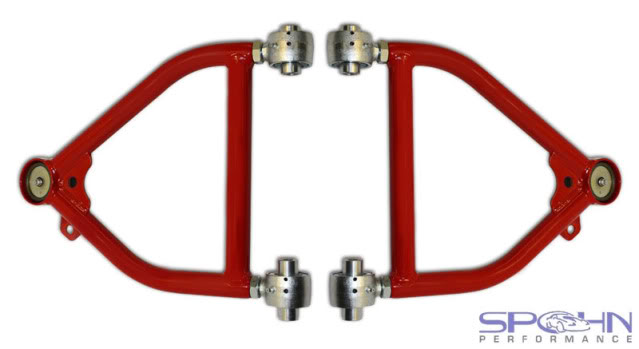

since these arms work on some cars and not on others. It makes me think it may be more of an issue with slop in the jig, not necessarily a completely wrong part. Could also be the same with the k-member. it would explain why some people dont have this issue and others do.
a center to center measurement across the mounting ears on the k-member would be good to have too. I have a stock k sitting in the driveway i could get measurement to compair with. I dont have any stock a-arms handy though.
somebody also mentioned the sway bar tab was moved too? something else to measure while we are at it.
Also, i know this was discussed before, but why do the a-arms on Spohns site no longer have steering stops? i know they didnt have them in the past, then the pictures changed anh the stops appeared, now they are gone again and somebody posted a picture of their new spohn arms recently with the clamp on style collar stop. why the constant changes

I tried all that I could to measure these arms. I don't see any to get an ACCURATE measurement with them on the car. The spring, spring perch, k member braces and spindle are all in the way. I wish i could be a little more helpful but its not going to do any good to get a close measurement. I plan on calling spohn on monday to talk more about the arms and the problem with them setting the tires back. If they are interested and willing to ship it back I will remove one and ship it to them, maybe they can measure it or put back in the jig and see if something is off.
