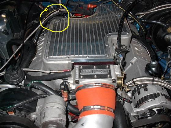

In the back of the plenum, on the passenger side, there is a tapped hole there where you can mount it. Just make sure you mount it in the upright position.

Im kind of limited on the pics I have. You can try to see if you can see it on this one. Its there under th braided fuel line, and plug wires on the rear corner.

Right here. This is the best I have right now.
