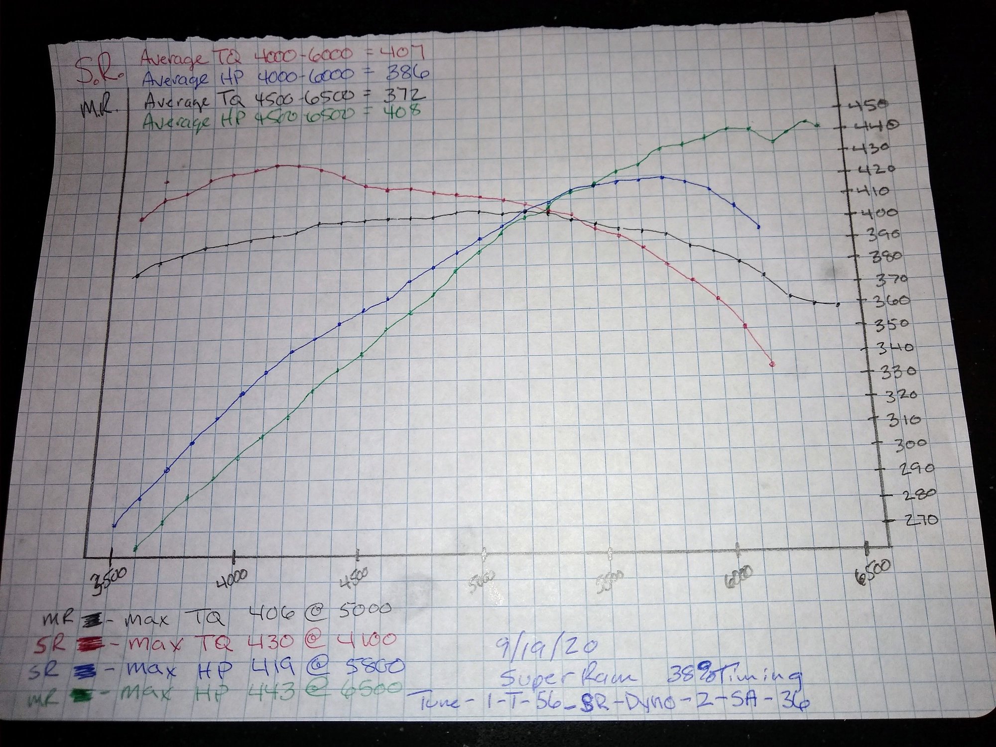

Old Nov 6, 2020 | 01:31 PM
  #127
drb930's Avatar
Joined: Feb 2006
Posts: 168
From: SoCal / Central Coast
Car: 1987 Chevy El Camino
Engine: 357 CID w/Lingerfelter Super Ram
