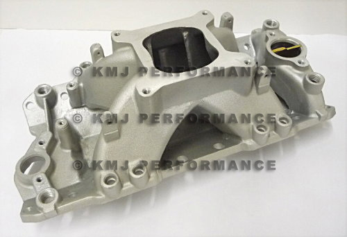

I just realized I missed something before. The Accel Super Ram intake like pictured here is about a 1206 port and too big for my heads?

the only accel intake pic is of a PRORAM not the SuperRam.
the Super Ram intake ports are smaller then the 1206 Gasket.
The ProRam, intake is for larger HP/RPM engs
The pro ram (singleplane) is a 1206. The superram is a TPI pizza box abortion.

This is the used Accel setup I can get for a good price. But if it is a 1206 Pro Ram maybe it's not a good idea and the Edelbrock would be better.

So I measured the intake ports with a ruler since my calipers were at work and I got almost exactly 1-3/16 x 1-15/16 (1.1875 x 1.9375) which is quite a bit smaller than 1206. I also noticed the Hurricane in the ebay listing is listed at 1.11 x 1.80 (left small for porting). Is that accurate? If so I might sell the Accel manifold and run the Hurricane with the Accel electronics.
If you look at post #30 by me, I put a 1206 over the port and traced it. It is just a little bit under a 1206, but so is the AFR 'comp ports'.
https://www.thirdgen.org/forums/post...10-post30.html
It's larger than a 1205.
I purchased this one:
http://www.ebay.com/itm/SBC-Chevy-Hi...2cdd04&vxp=mtr
I think the dimensions listed are not quite right. If you do get one, keep in mind you will need a fuel rail kit.
-- Joe

Hey Joe, I saw your post, but it's hard to see in that pic. Did you happen to pull measurements when you did it? I know I will need the rails - they are like $60 from "procompoverstock" on ebay.
http://www.ebay.com/itm/SMALL-BLOCK-...a7c56d&vxp=mtr
Orr, I sold the old AFRs because I really want Eliminators. And if I go 421ci, the 1204 Accel will be pretty small.

Yeah, that's still an "if." I've gotten lots of calls on my 355, but they're tire kickers.
I called KMJ and had them measure a manifold and their listing online is way off as you expected, Joe. 1.2 x 1.95 is what they told me. That would still be a 1204 though, and not even a 1205.
I almost want to order one and see for myself.
Does theirs say "procomp" on the front? Mine did.. I wonder if their is more than one casting...
-- Joe
-- Joe
No it doesn't...that was another thing I noticed. Maybe that is the difference.
http://www.ebay.com/itm/SBC-CHEVY-Hi...item4cf76cd16c
This manifold has longer runners and just looks a lot better than the Accel. The Accel has bosses for Vortec holes and what I assume is EGR in the center bolts. And the MAT up front is ugly. Small details, but being a designer it drives me nuts. haha I like a nice, clean slate.
I bet you a six pack the picture is wrong Look at the description, says you are getting procomp stock.
Overall I like mine. My only complaint was I had to get a 1/2" spacer because the linkage on my throttle body crashed into the fuel rail. Although, I'm running a holley throttle body and the linkage was designed by an ape.
-- Joe
