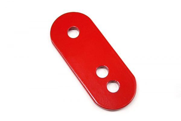

While I was under the car I noticed the torque arm front mount plates were cut down some on top for clearance for the transmission. Looking at UMI website the torque arm mount plates have 3 holes. I am starting to think this is why I couldn't get enough adjustment out of the torque arm to get my pinion pointed up where it needs to be. The previous owner of the torque arm setup must have had clearance issues and used the lower bolt hole and cut the rest of the plate down for clearance. I ordered two new plates from UMI to see if I can't make it work correctly with the top hole. It looks like I will have clearance issues too but I will do what I can to make it work. Here is a photo showing the plates.

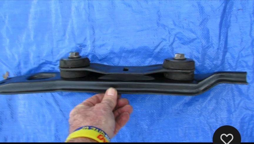

you know what, your post just reminded me. this formula has a tranny cross member I had never seen before. my 91 z28 was a factory manual car too, and it had a normal looking single piece cross member, I fought vibrations with it from day one, even with rubber mounts, I did switch to poly. so this 90 formula I have now has a 2 piece cross member that has a center piece that raises the tail housing higher. while it did come with a aluminum drive shaft when I got it, I don't know if it was stock, but this car has always been vibration free.
it looks like this one.. I have no idea of that plays into your pinion angle measuring
https://www.ebay.com/itm/30506537492...mis&media=COPY

In my reading I did see something about a 2 piece cross member. Also read something about a fluid filled transmission mount. Definitely never seen one in person though, looks like a interesting piece. Back when I was still running the T5 I had just the typical 1 piece cross member. I can't remember if I went to the poly when I swapped transmissions or earlier. Was back in like 2015 when I did that swap so I've slept a few times since then.
Honestly if I can get this final clunking figured out, I will be tickled pink. I was really starting to get aggravated with it to the point of throwing the towel in all together. I started back on this car with basically the only goal of actually being able to enjoy driving it. And that vibration was a major road block on that front. So every step I take towards making drivability something that is enjoyable is a big win. Next up on my list of things to attack will be getting the front springs installed. The rear springs really jacked it up...so once the fronts are in I need to decide if I want to cut them any and then get a heavily needed alignment.

they look good really low, but being able to drive around without hitting the air dam or dragging the mid pipe everywhere goes a long way to enjoyment as I get old haha.
since the factory used the same rubber tranny mount for both style crossmember. I can only get they did it to raise the back of the tranny and/or tq arm up an inch or so? which seems like it would make pinion angle more steep?
I remember those rubber mounts, once the own one broke, the aftermarket ones would bearly last a day or so haha. with the factory tq arm on the tranny you almost had to go poly in a v6 haha.

My replacement torque arm mount shackles came in Saturday as well. During one of my breaks from the springs I looked into that. The previous owner of the torque arm definitely cut down the old shackles. And my transmission definitely hits if I use the new shackles. You can see in the photo below. I highlighted in red where I will need to cut some bosses off the tailhousing. I already cut the rear most tab off. Still need a bit more room so will need to cut the stub where the transmission mounted torque arm bolt goes. I guess if I ever regret doing this, I can replace the tailhousing. But I doubt I would ever go back to a transmission mounted torque arm.

Front springs are complete and torque arm has the correct shackles installed now. Took car for a short drive and it felt really good. My front end however is basically at the same height it was before. I didn't use any isolators on the spring tops, so maybe I need to get some to gain around an inch. With these springs though the front felt a lot better. Was plenty firm and felt smooth going down the oil and chip roads leading to the paved roads from my house. The old springs were so short they could be installed without a tool, so I think they were barely doing anything for ride. I will likely end up removing the 4th gen isolators in the rear. Right now I am sitting at 26" in front and 29" in rear...I like some rake but not quite 3" I'd really like to see around 27" front and 28" rear. Maybe even 27.5" rear.
WIth the torque arm work, shifting has improved greatly too with less jerking. Really starting to feel like a normal car finally. Still has a slight clunk in the torque arm when coasting or during load change. Thinking it is just bolt slop in the shackles. Overall though it is greatly improved.
I am coming along nicely with the tune as well. Have been making adjustments to proportional gains and acceleration enrichment. It really seems to have gained responsiveness with a touch of throttle from idle. Before it would rev kind of slow, now it seems to get up in rpms quicker. I took a lot of AE out of the tune because it was swinging way rich. Probably causing a slight bog. I will continue to make adjustments each drive. Technically now that it is late fall/winter, I am not "supposed" to drive the car with the antique plates I have on it. But I doubt I would get too much hassle over it around here.

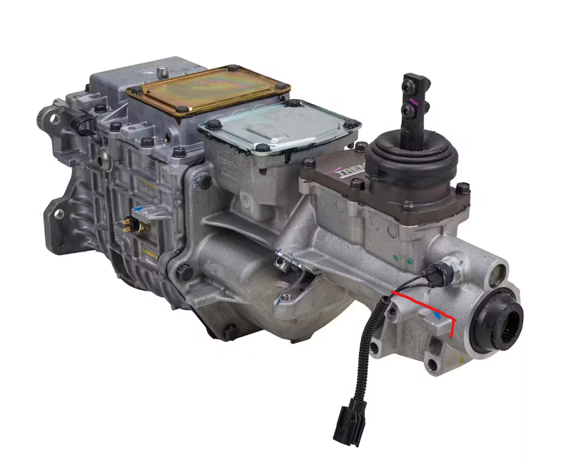

Some to-dos I have waiting to be installed are a new front driveshaft yoke and front U-Joint. Still have a bit of a clunk and vibration going on I would like to eliminate. It is a lot better than it was before doing all the stuff last summer so I am making progress. Once I get those installed I will probably start looking at getting the AC system sealed back up and working. Already have a new accumulator waiting. Should hopefully cool really well with the brushless cooling fan setup.

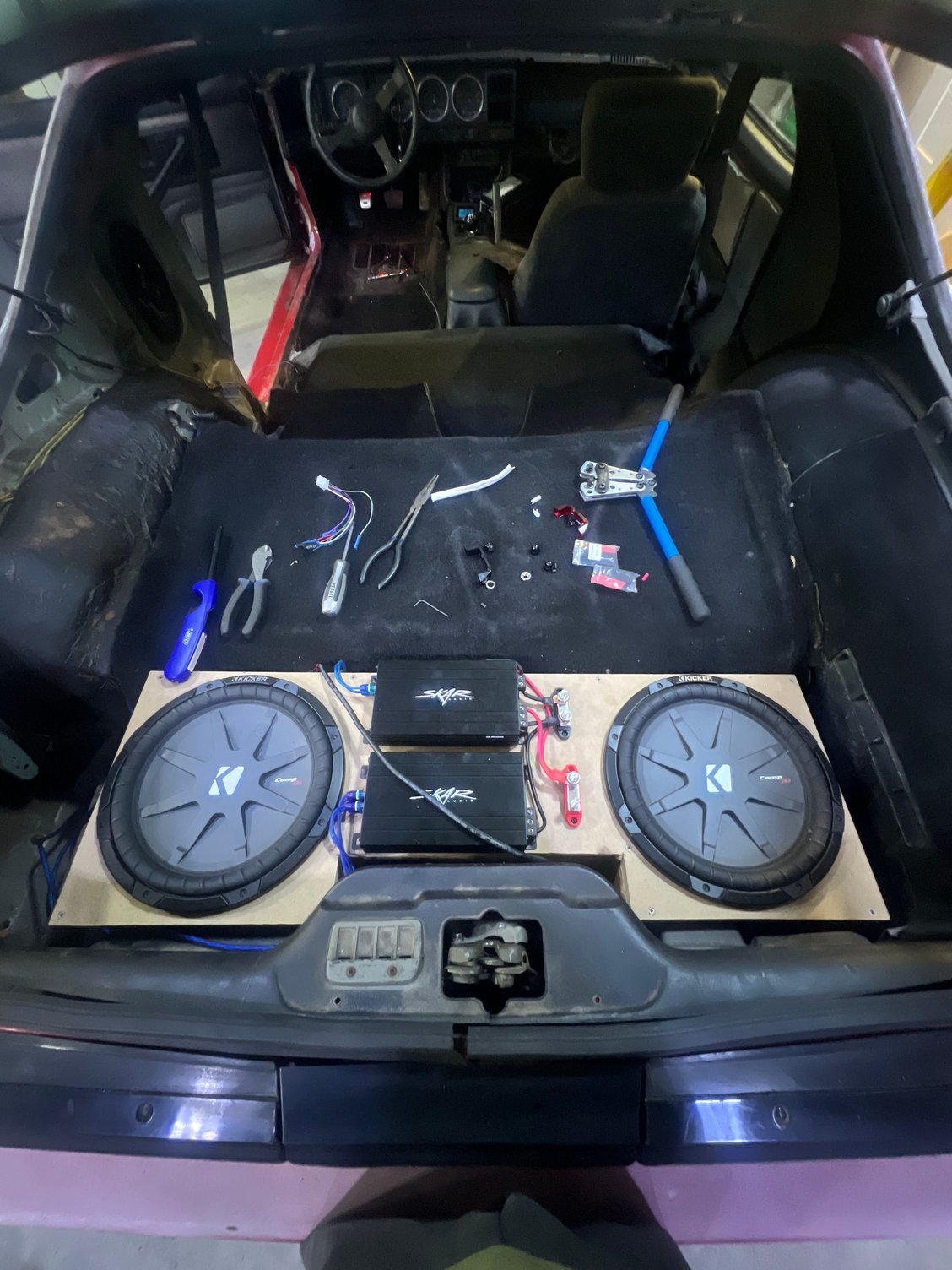

Been a very busy summer with the jetski side business. Didn't really do anything with the car due to that. At this point I am convinced to go ahead and keep it unless a great offer comes up for it. The good news is with having a great season for the business, I have saved up a little chunk of change for spending on the car while also having enough to also keep the wife happy with some projects she wants done.
Now that season has slowed down for me some I have been tackling some projects I had for it. Got the new yoke and front u-joint installed. Replaced the remaining pieces of the front steering components I had purchased to go along with the new tie rods I did last year. Installed the steering shaft upgrade. Attempted to adjust the steering box but I think it is well worn past its adjustability. It took all of the adjustment to even begin to remove the play it had. But then the steering didn't want to return to center while moving. I will probably look into a new box for it. Steering is tight aside from the play in the box now at least.
This past week I've had a lot of the interior removed for some audio upgrades and wiring up the rear hatch release. It kind of snowballed on me with the audio...started out with just installing some 4" speakers up front. While I had the sub box out to do the rear hatch release I pulled the single 12" it had in it to look it over. Years of sitting in the sun did its toll and the inner cone was shot. The box was kind of junky anyways and needed a new top so I got talking to my buddy/neighbor with the '99 TA. I knew he likely had some equipment laying around cause just about every vehicle he owns has audio systems. I first asked about just a single 10". But he said he had these two 12" subs he'd give me for free along with two amps I could use and if I like them we will figure out a price down the line...so here we are! Don't worry I have carpet coming for the sub box!
It will be a hodge podge system for sure with all the mix match going on. Pioneer 4" speakers up front due to the very limited dash space Firebird/TAs have compared to Camaros. Some Kenwood 6x9s for the rears. 12" Kicker Comp RTs. And then the two Skar Audio amps. Certainly not a "powerful" system but should be a huge improvement from before.
My dash pad is pretty toast. I think I am going to leave it out for now and attempt a refurb job on it over the winter using some marine vinyl/faux leather to recover it. After that I want to do something about the door panels. If I don't go with some black GTA panels, I could probably incorporate that same material from the dash into the doors as well.
Then looking further down the line, I am going back and forth on paying someone to paint it. I spoke to a local hot rod paint guy at a car show very briefly about it. He ball parked a 10k figure on paint. Which honestly is about what I expected for a professional job. To get that done though is going to take me selling some toys off, otherwise the wife would never approve of that kind of spending.

I fired mine for the first time with the EBL p4 a week or so ago. idled and some good chop. I didn't get it out of the garage thou. it's kinda crazy loud with this 4in. I ordered a varex valved 4in muffler for it, hoping to get it installed and driving soon ish.
I tend to agree with the tq arm. unless you're going to do some drag stuff the stock arm if it fits is probably just fine and a nicer drive.
