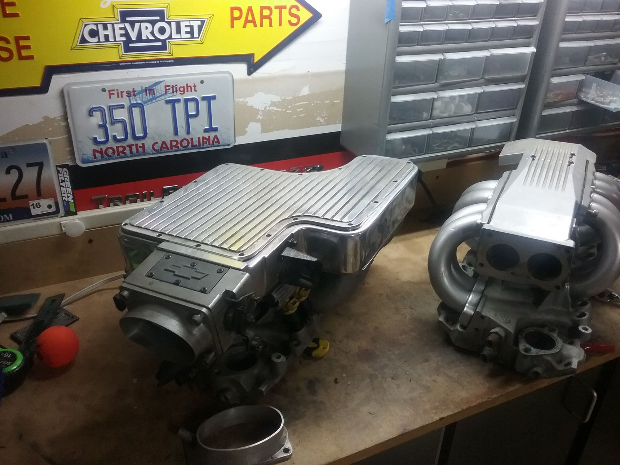

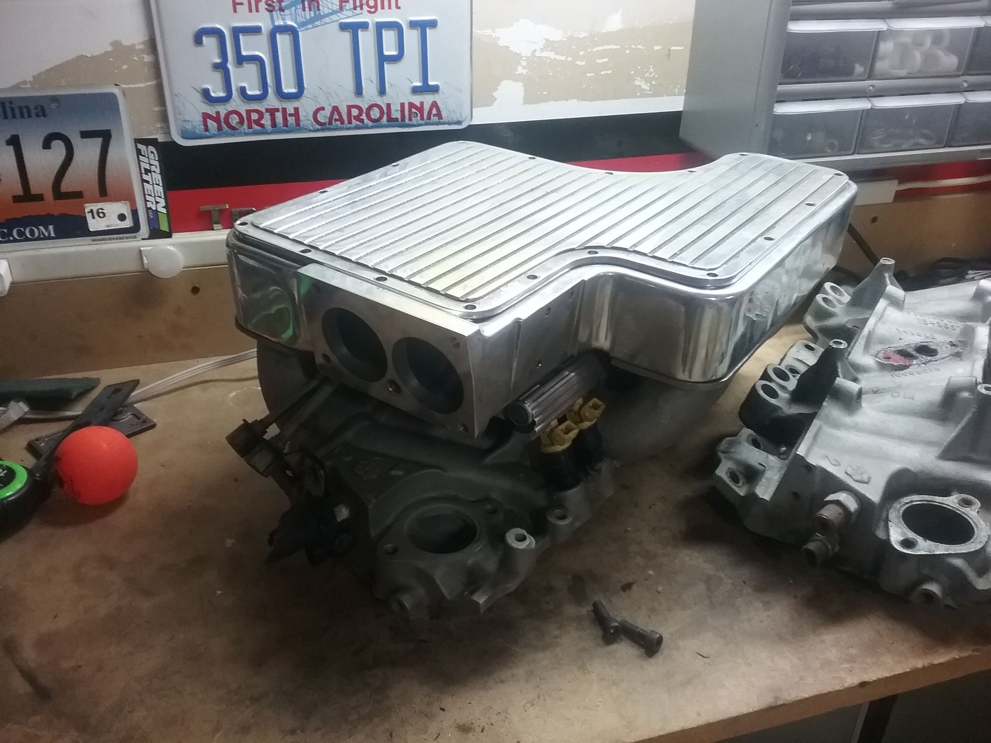

So I guess you go buy one of these and then you post up pics, right!? Happy to oblige!
I don't have extra ENGINES in my pics like TTOP350 did, but I dusted off my old TPI just for the heck of it! .....jokes aside, I'd actually PM'd with a few of you including TTOP350 about possibly buying one of these and based on what they're selling for, I couldn't afford it. Let's just say I got this one a LOT cheaper than any I've seen recently!!!!! Like...found it on craigslist in PA, and picked up the phone immediately kinda good deal. It's complete, minus the the runner to plenum gaskets, and it's got an extrude honed GM base instead of the Accel base. Not looking for a debate on performance, but here are my observations. The exterior opening is matched to the runners, which surprisingly isn't really much bigger than the stock opening. Magic is how it carries that opening through the port instead of the stock cast which immediately chokes down. ...and then the exit port is matched to a 1256. This base isn't quite as big as the max effort GM base I'm running now which dwarfs a stock aftermarket base, and it won't impress the SoCal guys, but it's a nice piece. It'd certainly outflow the Edelbrock base which I had. Never had my hands on an Accel base so I can't speak for it.
...and I've got the early style throttle body, corvette rails and what are probably Accel injectors.
Plan for now is to keep the plenum and runners. Probably try to sell the base and throttle body. Not gonna rush. Enjoy the TPI now, and take my time, clean the SR up and possibly port it for an eventual heads and cam swap. Honestly wasn't planning on having this, but here it is.

Congratulations, looks like you even scored the rare throttle bracket.

Hmm, Corvette base and fuel rail?
Good score. Never cared for the look, but they're iconic now... The Nostalgia helps.
Am I correct in that claim? I think so, but I could be wrong. Doesn't look line MY fuel lines.

Accel, edelbrock &tpis all used a vette style base. Drew is correct vette rails. If they don’t have the ninth injector they are for 89-91. I think the center holes on the intake are 90 degrees compared to 73 on later heads.

Casting 10066013. Later style 'Vette base from what I can find.

I could break out the book and dig for the part number, but the only bases that have the tall boss next to the Tstat, seem to be Y-body parts, and of course the aftermarket bases usually copy that boss for interchange. Since you said it's a stock base, and the Y-body fuel rail, it seemed a likely conclusion. If so it'd have the EGR port at the back and 86-earlier intake bolt angles.
