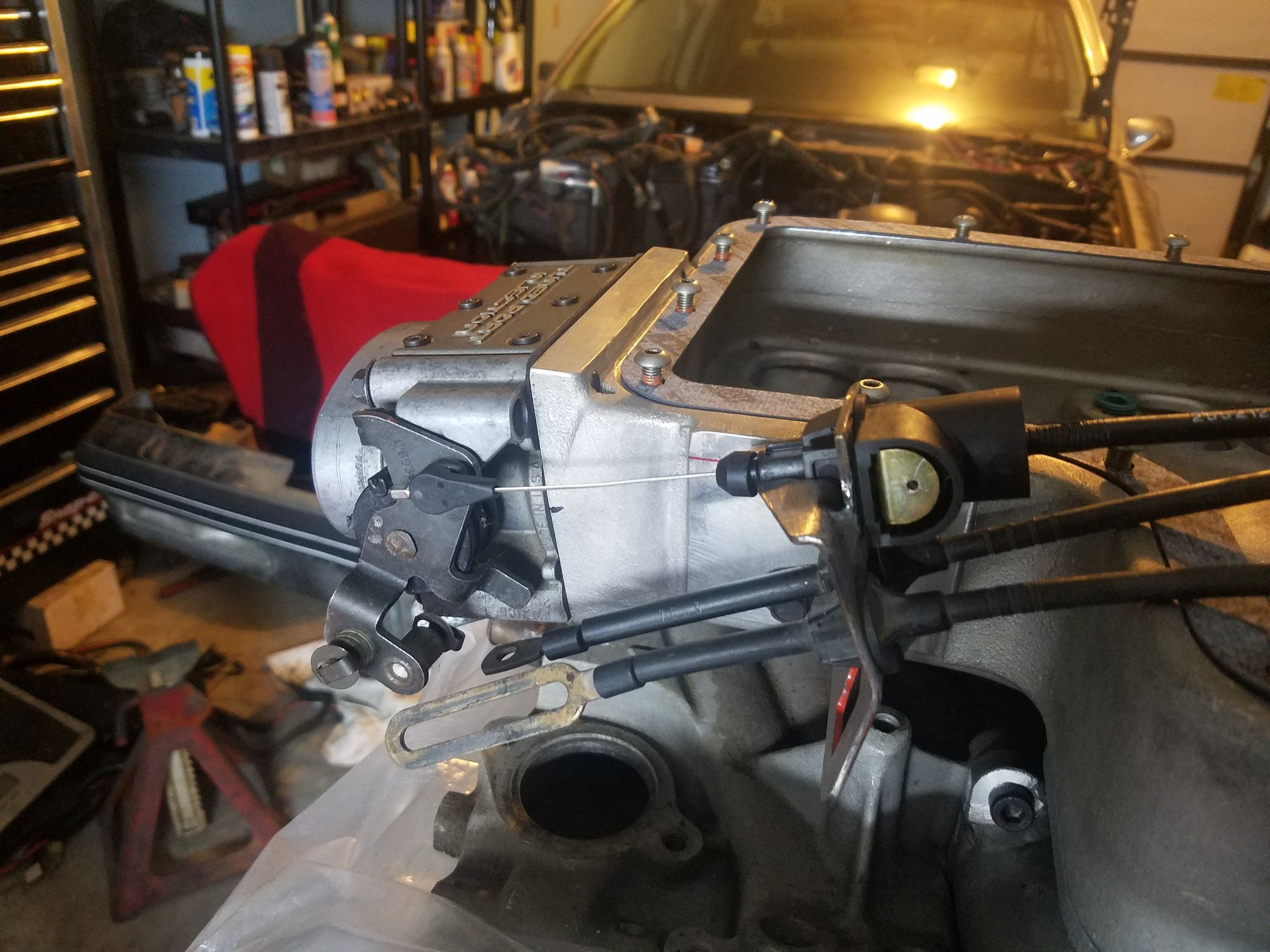

Mod'ed SR T.V. cable bracket
Here are some pics of my modified TV bracket for my super ram that I am going to be using. I had racked my brain trying to come up with something that would work. Searched the internet till I couldn't find anything else. Nothing really appealed to me. Then it hit me one day when I was staring at it. Basically the same as a Q-jet. The Q-jet rotates below the shaft towards the front and our throttle bodies rotate above the shaft towards the front. Almost identical attachment points from center of shaft. What little difference there is won't matter.
Questions, comments or concerns...

In these days of everything bolt-on, it's nice to see someone actually fabricate a solution.

I was thinking about having to make SR bracket by cutting lower mount tab off and bending the bracket to the right angle as SR bracket then somehow move the TV cable hole more inboard if I had more tools like a band saw I think this could be done
