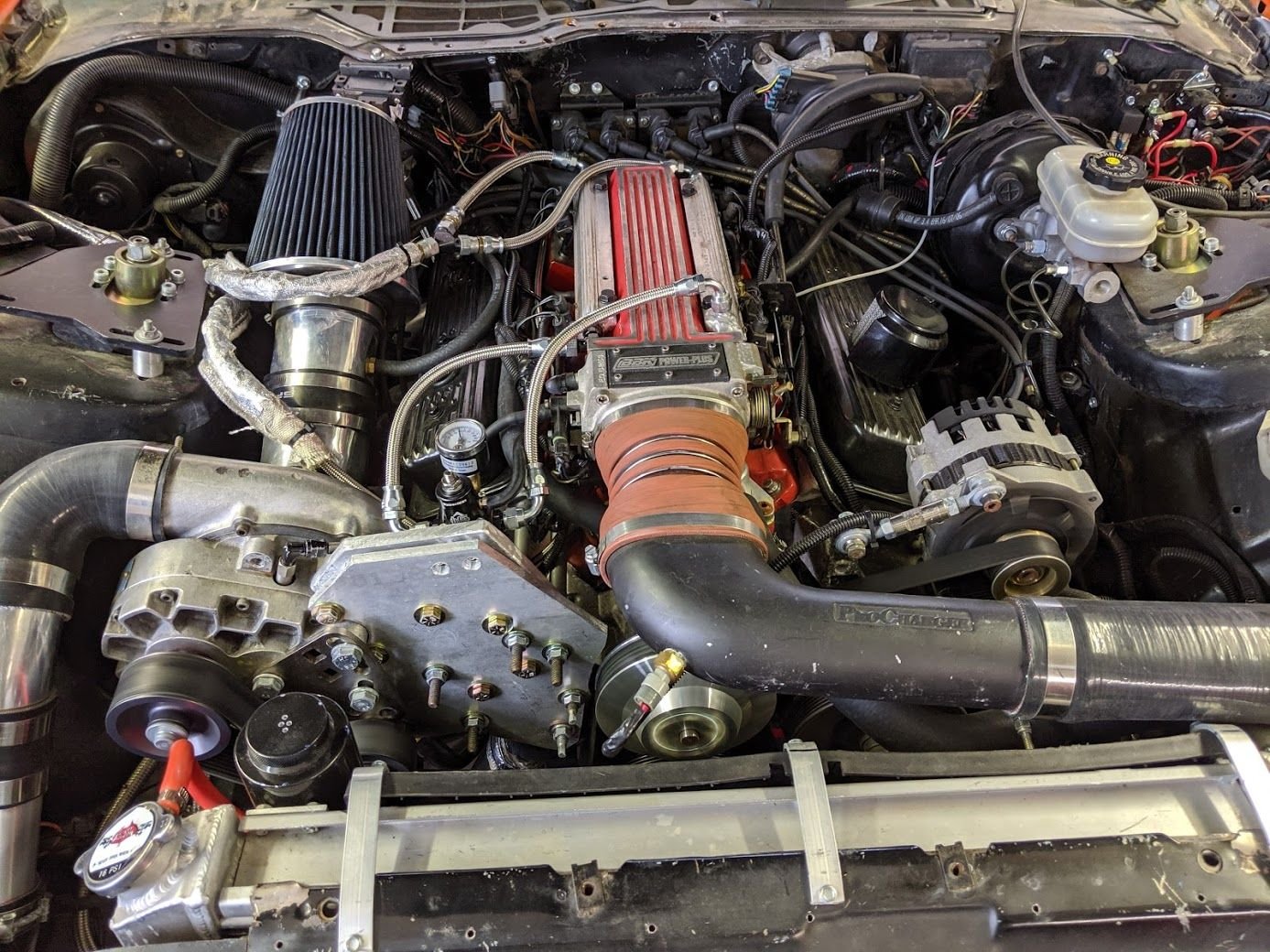

You should use a remote regulator with integrated gauge port, similar to what I'm using here. Run the lines for parallel feed without crossovers.:

In a perfect world, the fuel pressure should be equal and even everywhere in the system, so the placement of the gauge is doesn't matter.
In reality, there is some small variation. I have an electronic sender in my left rail which runs to the ECM to log fuel pressure, and I have the mechanical gauge in the regulator housing.
Again, I'd recommend using a WYE fitting and feeding both rails in parallel, and then running the discharge out the front into the regulator.
-- Joe
