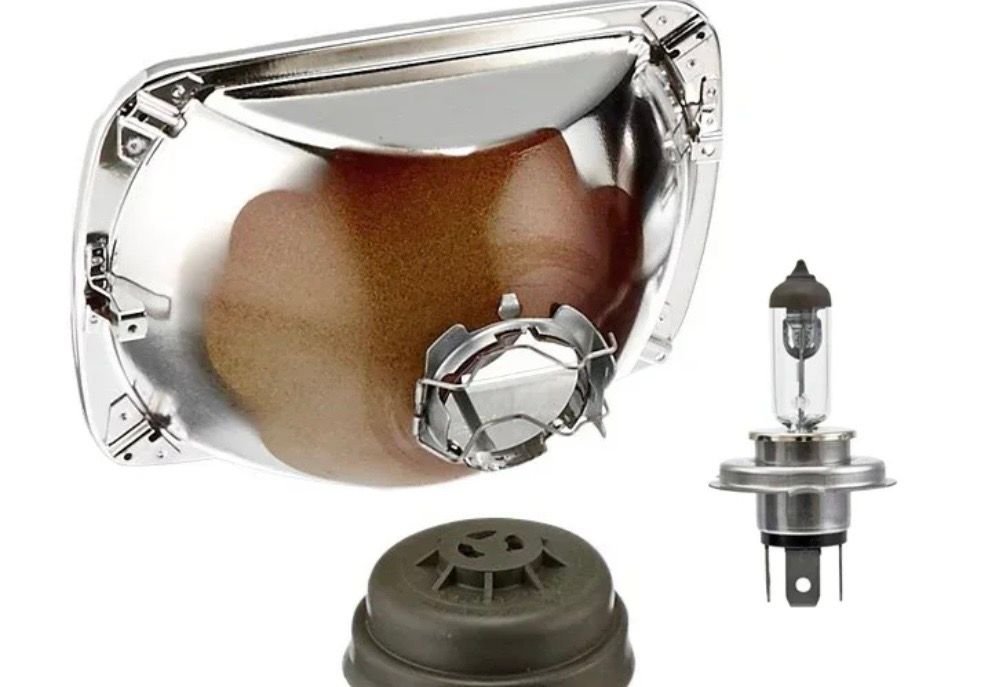

Hella makes them too…but these might be the smaller ones for ‘91-‘92….
Hard to tell size from the pic, but looks like it. 91-92 birds used 4x6 bulbs (H4666 I believe), earlier birds used 5x7s

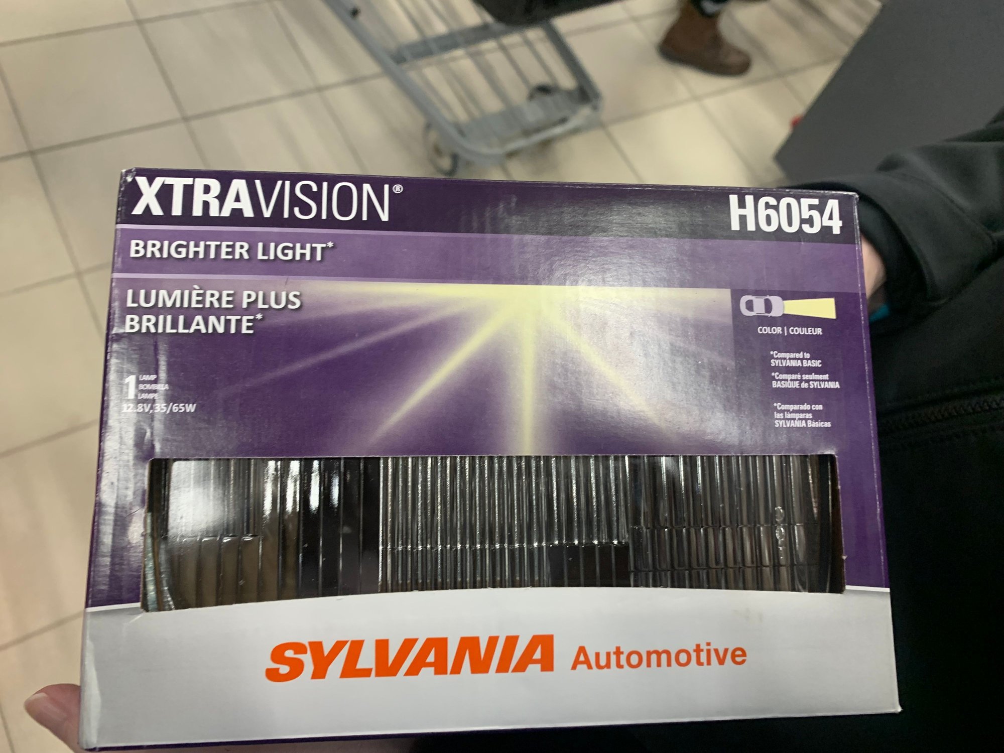

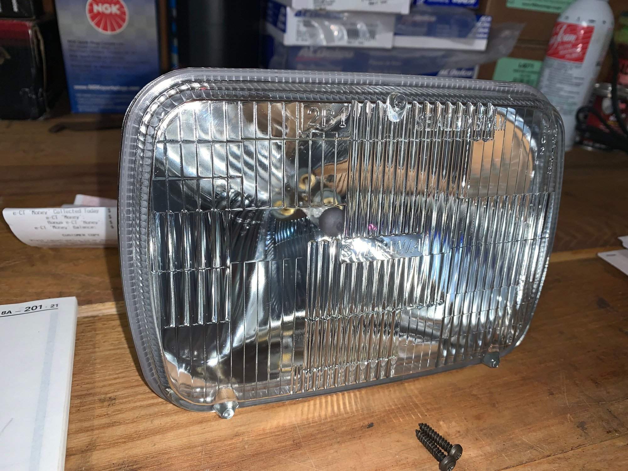

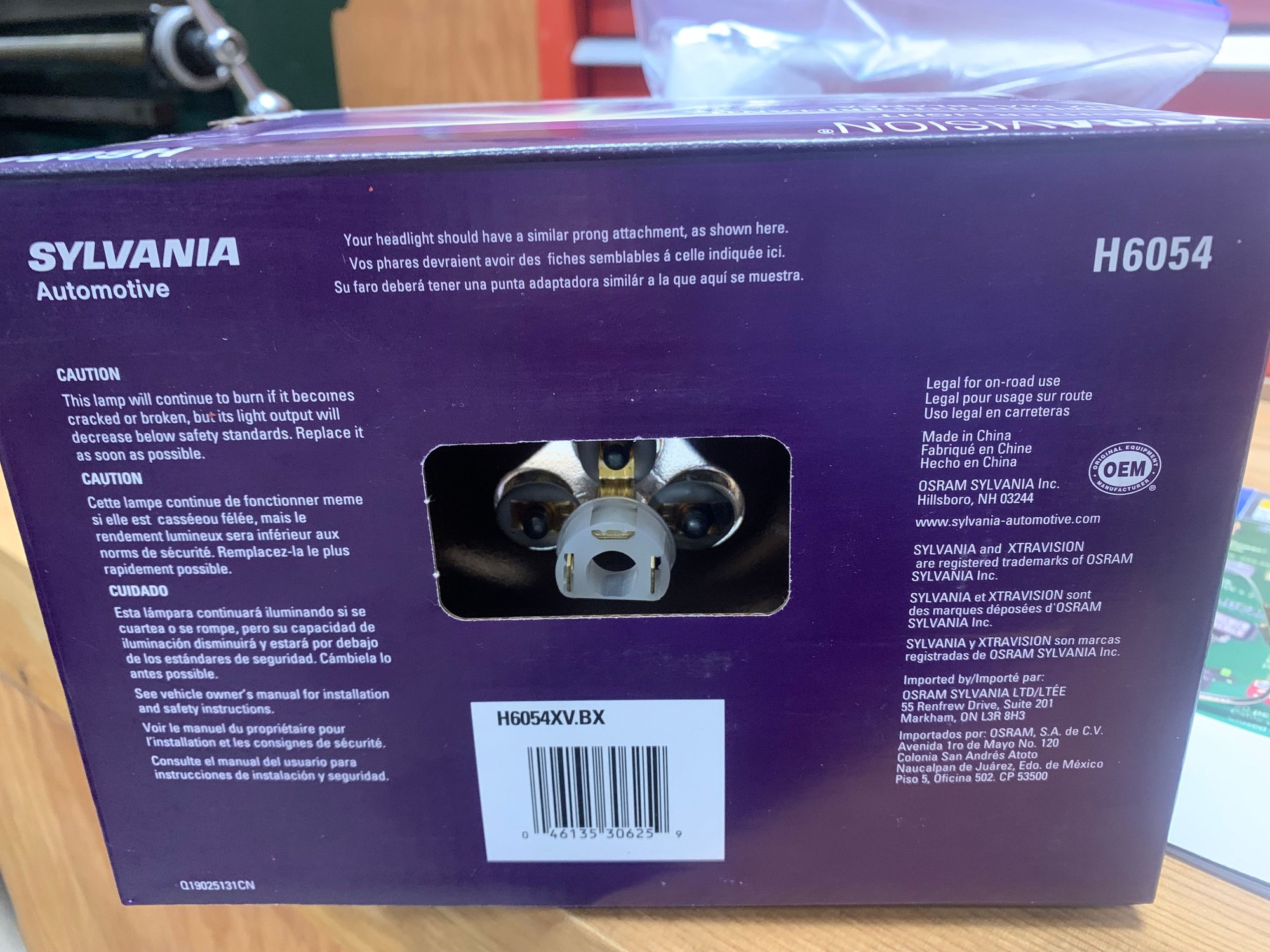

I ended up picking these ones at Canadian Tire. It has the factory look and feel, but with a tad-bit of added performance

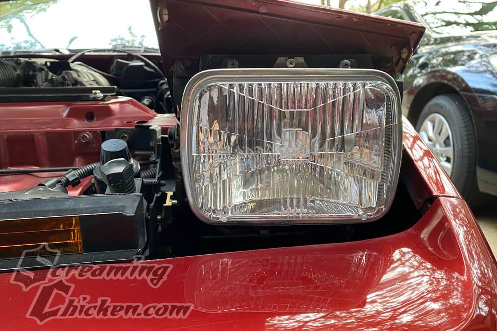

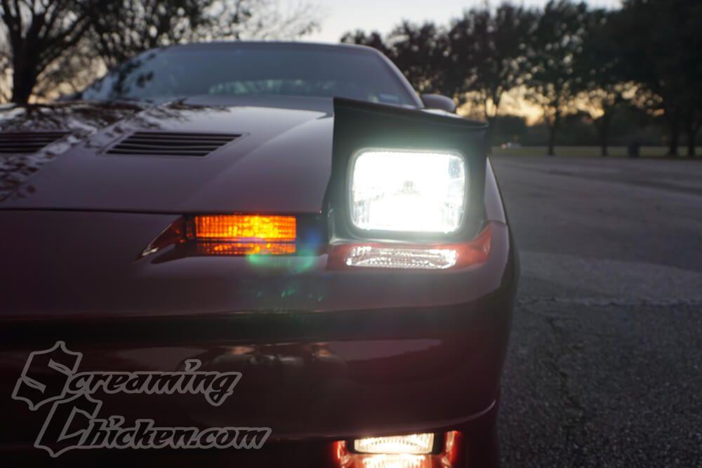

We currently have 2 headlight options for 1982-90 Firebirds/Trans Ams. We sell a kit that includes a pair of headlights with glass lens and replaceable H4 bulbs, they include halogen bulbs or you can select led in the options and we will swap them out before shipping them. They do not require any wiring or other changes. Once installed we recommend manually raising them up/down to verify wiring will not snag when headlights go up and down. 1982-90 Firebird Conversion Headlights – Screaming Chicken
We also sell the Holley Retrobright headlights, these headlights look stock but have light output like a new car. They have the stock headlight lens pattern and use Holley specific led bulbs that are included. They install with no changes. The Holley headlights would be the closest product currently available that gives you great visibility at night but you can't tell that anything has been changed when the lights are off. The lights are designed and manufactured by Morimoto. Holley pictures below.
1982-90 Firebird Holley Retrobright Headlights – Screaming Chicken

I'm probably gonna bite the bullet and pony up for the Retrobrites...

They look very tempting.
