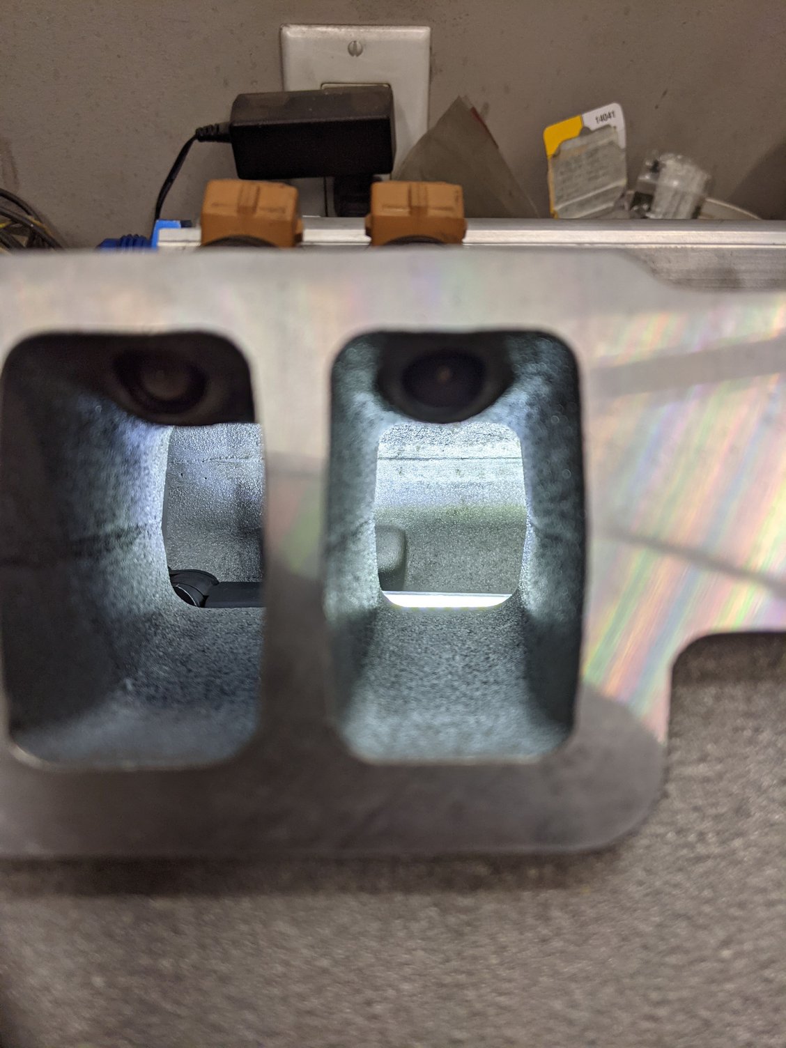

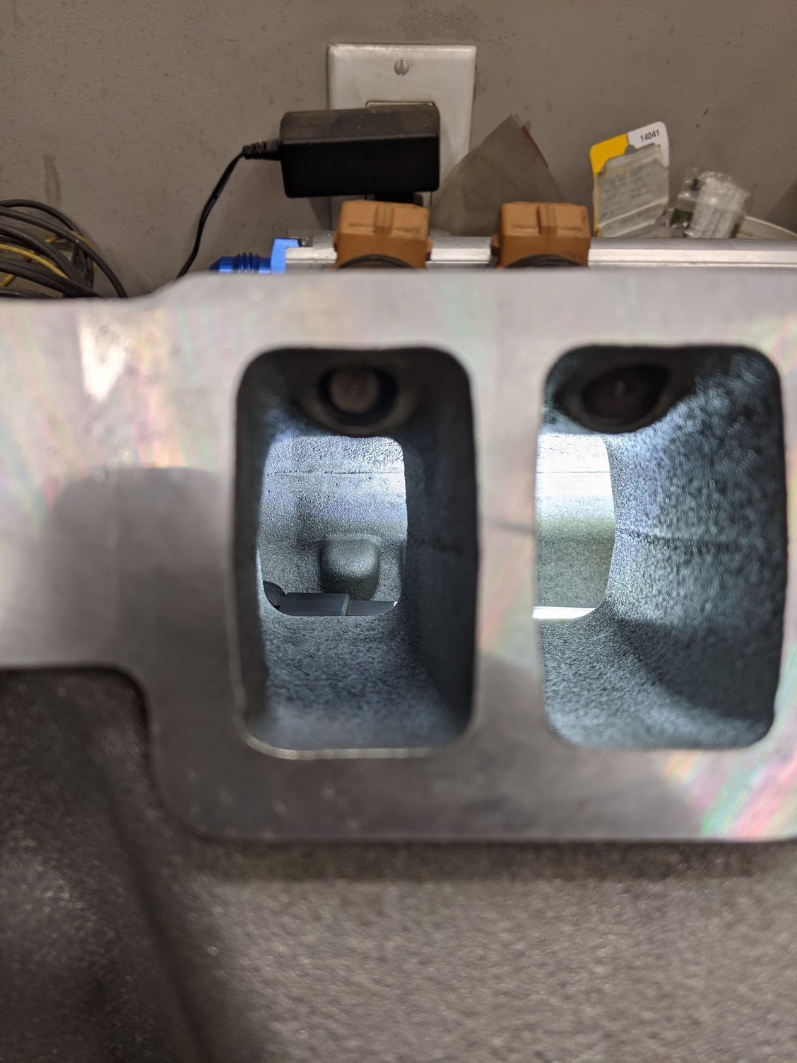

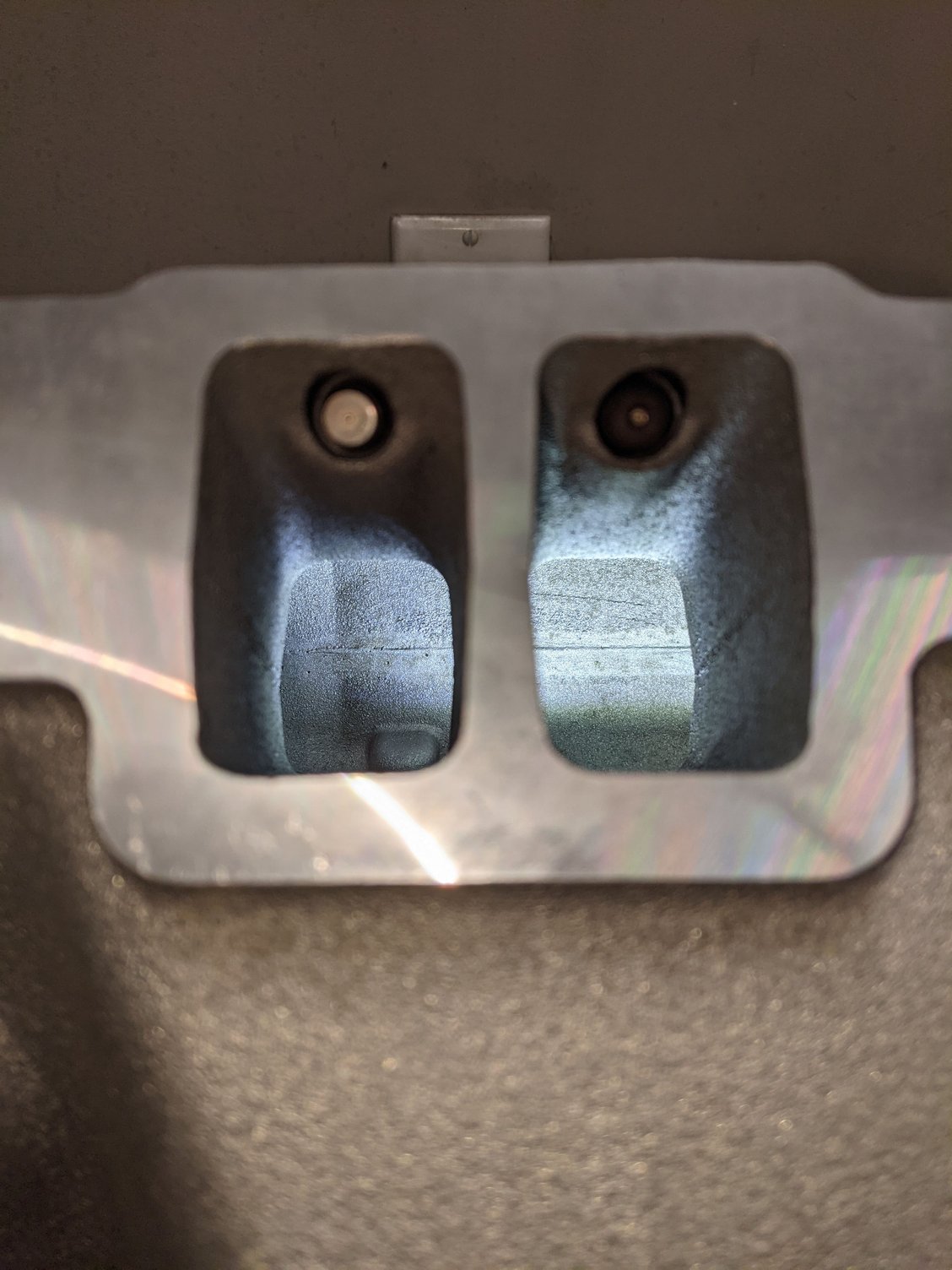

I was looking at those Enforcer heads from AFR. Same casting as liberty and other chinese heads. I hear the AFR springs and valves are better though.
Can you snap a few pictures of what it looks like inside the runner? Curious how far they can be ported.

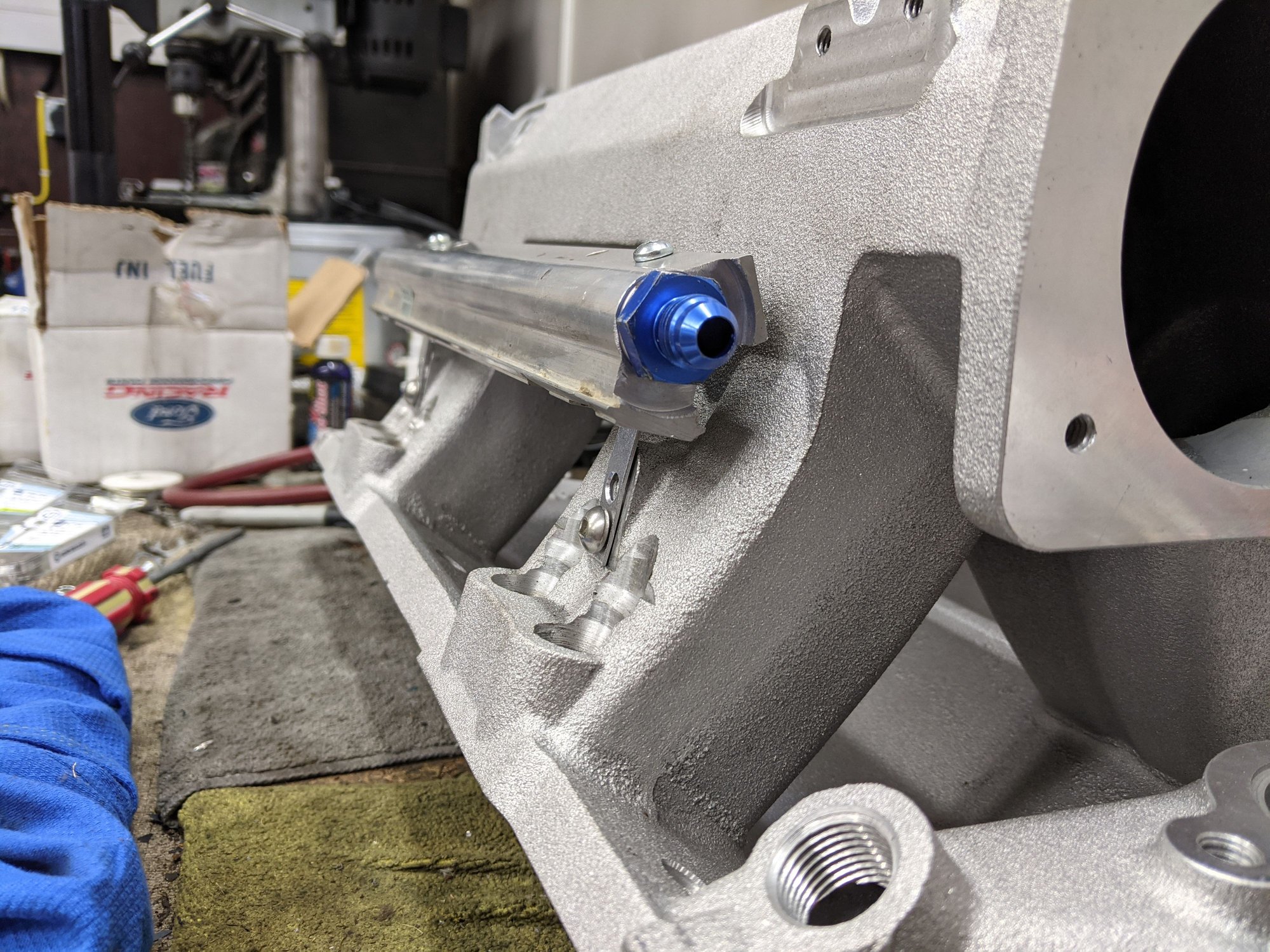

Mocking up LT1 fuel rails. I am too cheap to buy fuel rails. I got these for free. I would just need to weld shut the front crossover and then drill/tap or weld threaded bungs into the ends. I can even use the fuel pressure regulator as long as its the right fuel pressure. I will have to look that up.

Pics of the intake or head runner?
Here is the heads starting at post #24 https://www.thirdgen.org/forums/memb...ml#post6403622

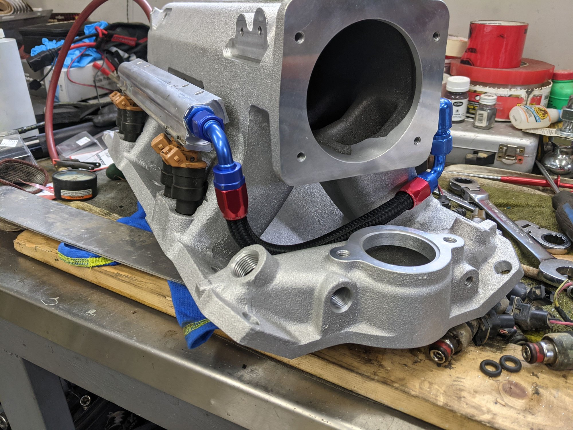

LT1 fuel rails modified and mocked up with old injectors.

When I used modified LT1 rails I was concerned about tapping them, so I welded the mail ends on. The casting is just really thin, although I was probably just being paranoid.

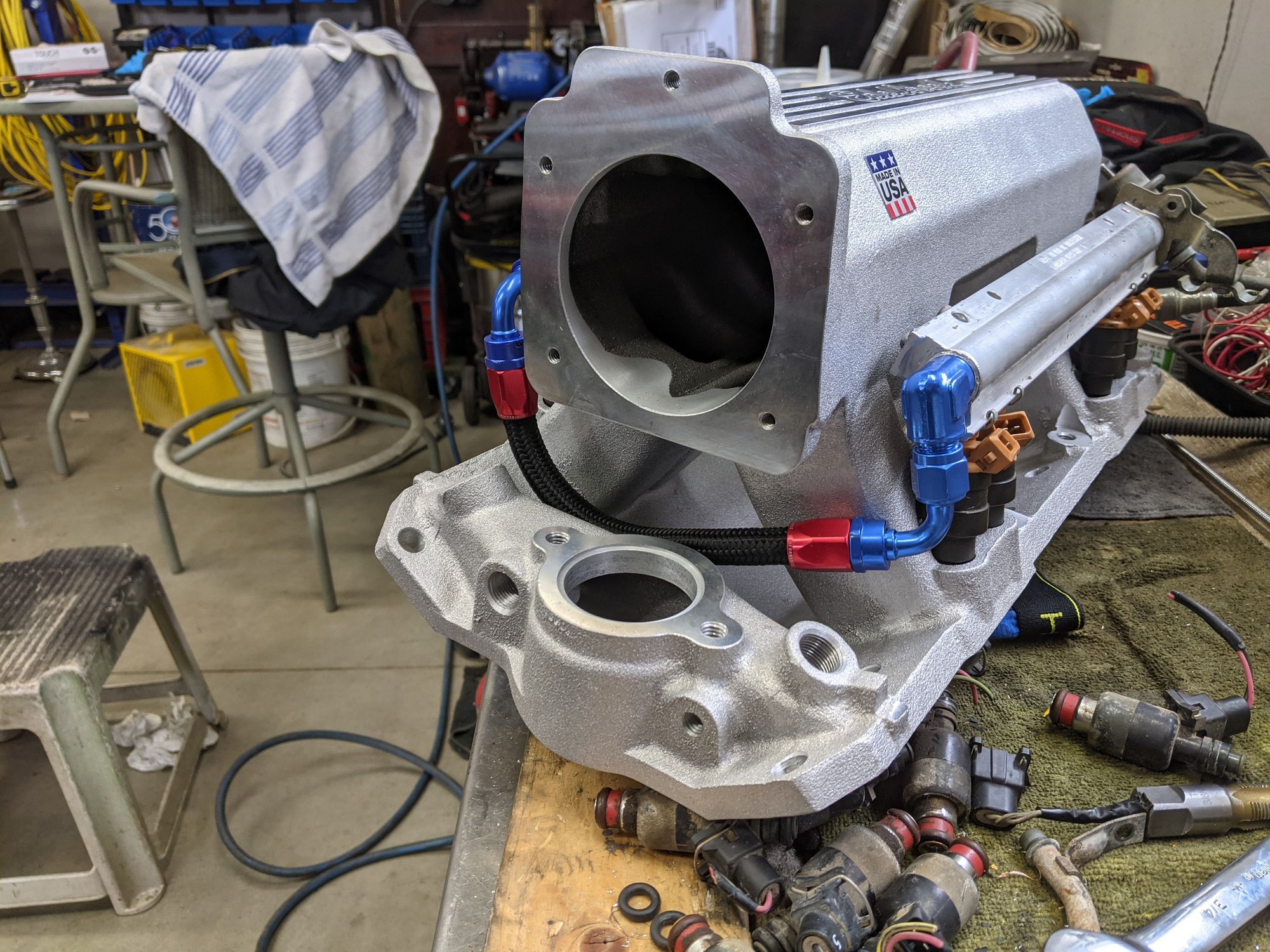

Fuel crossover done and pressure tested.

So how are you bolting the rails down to manifold?

I made 4 strips of metal with a bend on the top end. They sit against the intake fuel rail mounting pad, then the bend goes along with the factory shape of the LT1 fuel rails. They are secured to the intake with 2 screws each and then a bolt through the existing hole in the fuel rail. I will get some pictures later.

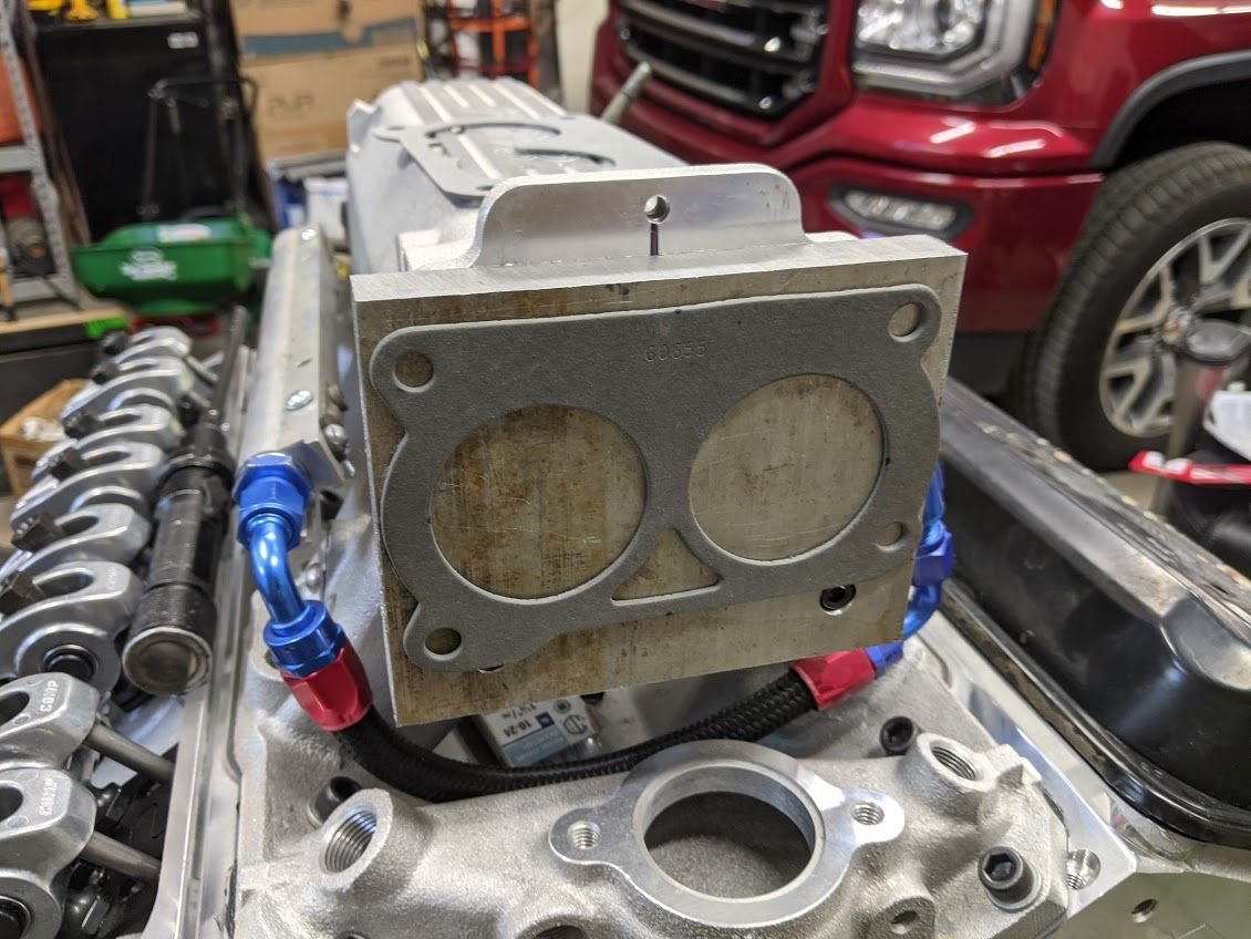

Got to work on the TPI throttle body adapter. Ideas borrowed directly from Dave_85 on corvetteforum. https://www.corvetteforum.com/forums...ttle-body.html
Looking at the pictures I stuck the TB gasket on backwards.

Originally Posted by dbrochard
Why not just go with an ls1 throttle body like the manifold was made for? I'm no expert but I would assume the tpi throttle body on that intake would be a big bottleneck
You have to use edelbrock's $500 throttle body that doesn't have a spot for a TV cable. Or a LS1 throttle body and a adapter plate, also the throttle body does not have a spot for a TV cable.

Wow they make it difficult. Any reason you chose just the manifold over doing the entire pro flo xt self tuning kit? I think they go for around $1800 but that includes throttle body, fuel rails, injectors, harness, computer

Re: Pro Flo XT because HSR is out of stock
Budget, TV cable and pro flo xt self tuning kit doesn't control torque converter lock up.

Here is the TPI throttle body and adapter on the engine in the car. Close to first start up!
