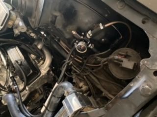

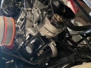

I put one in my ride recently. Love it. I got it all set up for e85 cause it’s cheap, easy to find round here (mn) and works good with my higher compression. I just added fuel in advanced tuning and the self learn took it from there. So nice to be able to set your timing right from the tablet. No more popping the hood constantly and messing with springs and bushings. Mine likes 22 initial 32max and no vac advance. The edelbrock proflo forum is very informative too.

I recently finished mine also. Have not went for a drive yet, just idle and backing out of the garage. I remember seeing in the instructions that it said it was not compatible with E85 fuel. Also, why no vacuum advance for timing? Just wondering, I still need to play around with some of the features of the system. But, you are right. It is awesome doing everything without opening the hood! Are you using the edelbrock 8041 throttle bracket? I am waiting on mine to show up so until then, I am using a FAST bracket with spacers so it clears the fuel rail. This made me go to a 2" tall filter instead of the 3".

Over on the edelbrock proflo forum their own guys say the system is not “officially” designed for e85 but is completely capable of running it. Everything (fuel injectors, rails etc) is capable of handling e85. Premium is getting expensive.
I just rigged up the bracket I had on the carb. Had to go a little customs stuff but it works.
My motors 10.8:1 compression and doesn’t like the timing to go over 28 with premium and 32 with e85. Anyone who has high comp should be careful with the proflo as the map the set up wizard picks for you starts you off with 36 total and 5 degrees of vac. So you’ll see 41 when getting on it. That’s detonation city. Don’t know if you’ve ever watch Eric the car guy on YouTube but he put this system on his 383 and cracked the pistons first drive. I believe he was only running 10:1 comp.
