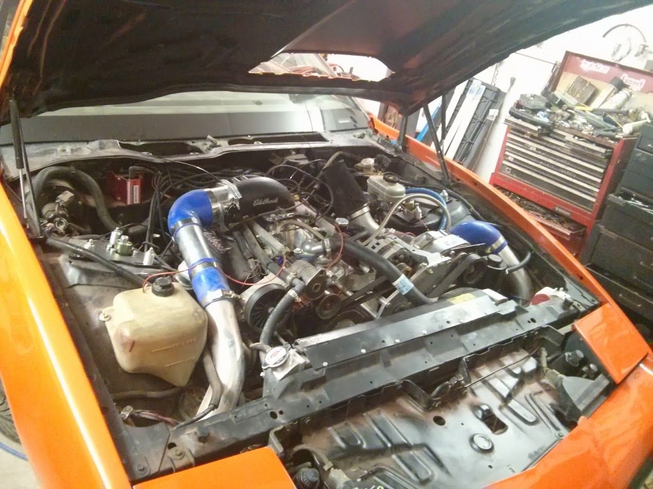

That setup clears the firebird hood just fine. I ran this setup a decade ago:

How were your IATs w the filter there? I'm the process of collecting stuff for a blower this winter and struggling w the air intake in that area.

Did you cut battery tray for intercooler piping or run through fenders? I'm leaning towards A2W to try and limit distance. But packaging isn't too easy on a bird

If you have a cowl hood like Joe does, it wouldn't be tool awfully hard to fab up a tin tray that would isolate the filter to the cowl when the hood is closed.

Absolutely terrible.
I also ran a vortech on the passenger side with the air filter pretty much in the same location, with the same issue. Then the pressure drop through the intercooler is absolutely insane because it's taking out so much heat.
I think Willie did that 20+ years ago, and it came out great. In the photos above, that's a stock formula cowl but I suppose one could fabricate a mechanism to draw the intake air through the opening. The cowl I have now would probably work even better but I never bothered to fabricate such a thing.
Now I have the turbo with the air intake facing forward and I'm in the process of re-routing everything again to draw even colder air from the front right fender.
I'd like to go back to the formula hood eventually. I painted the car in 2013 and it honestly is ready for another paint job. Maybe next year.

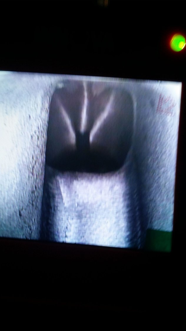

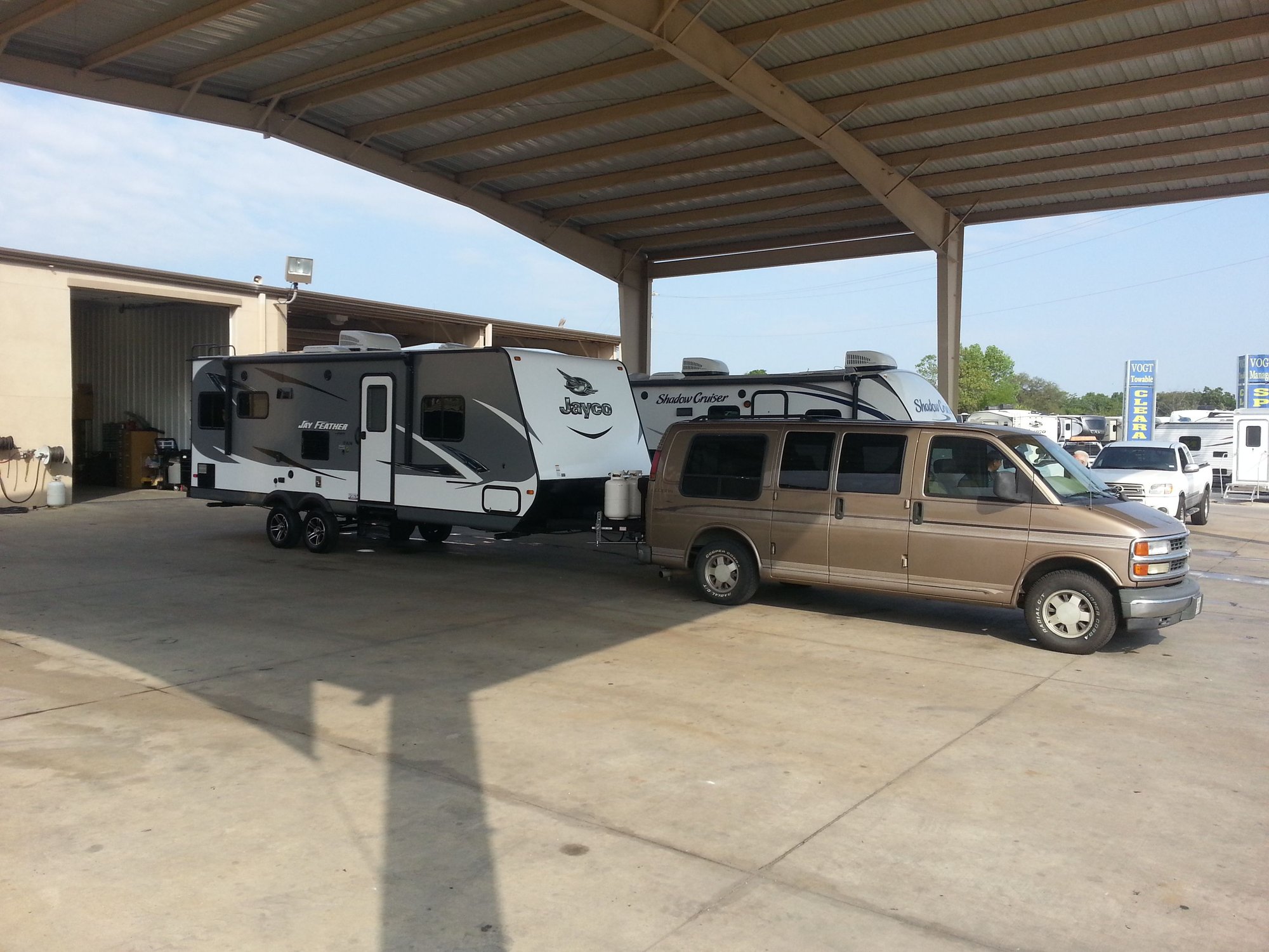

Sorry SBC is not dying at all, they are still easy to make power out of, cheap and extremely reliable. Just worked on one that had a mouse chew on the harness a bit and would not start. It was installed brand new about 6 months ago. 6.2L of aluminum headed turbocharged SBC running on natural gas. Seriously though when it comes to big power it does not matter if it is a SBC or LS, cost about the same to build and it is all going to be aftermarket. Plenty of 410s make more power than most naturally aspirated LS engines dream of every weekend and run lap after lap. Plenty of drag cars running small blocks and the owners will not be replacing those engines with LS engines anytime soon. I personally prefer the SBC over the LS. More torque where you actually drive 95% of the time with a SBC.
BasIcally brand new SBC 377. 4.00" bore and 3.75 stroke, aftermarket block and aluminum heads.

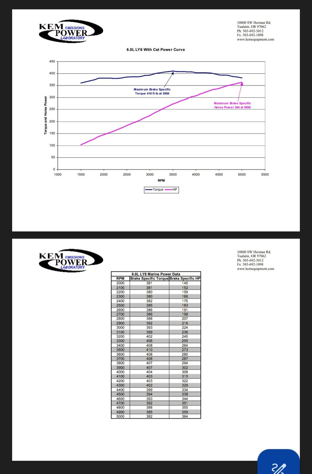

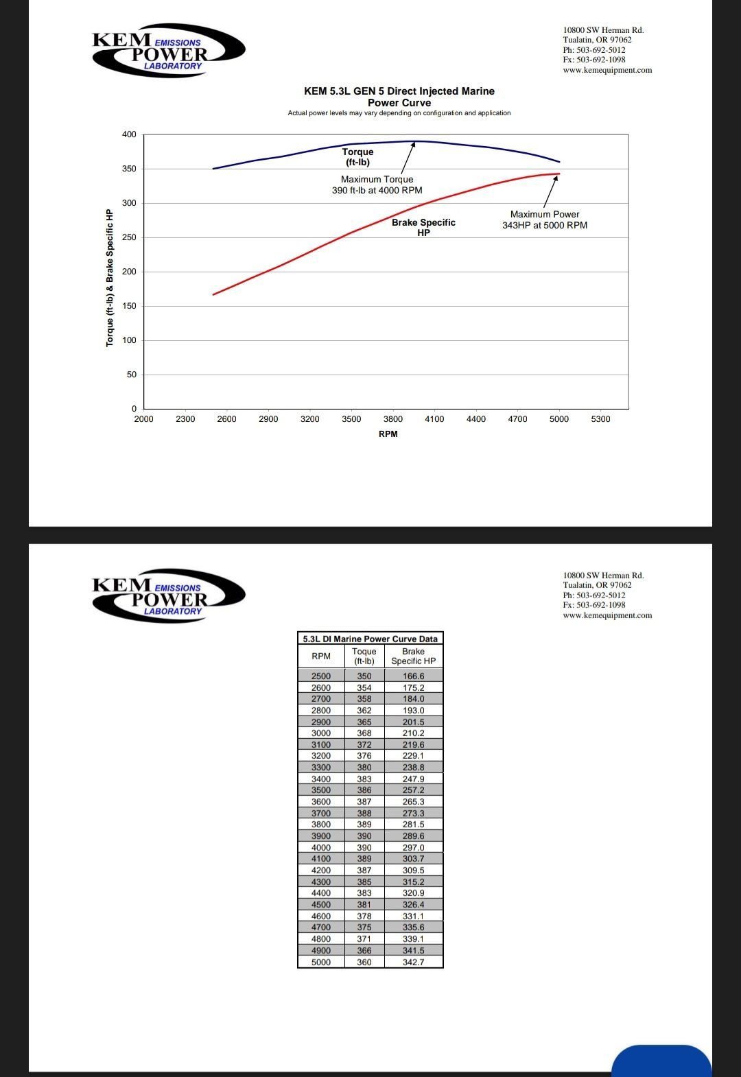

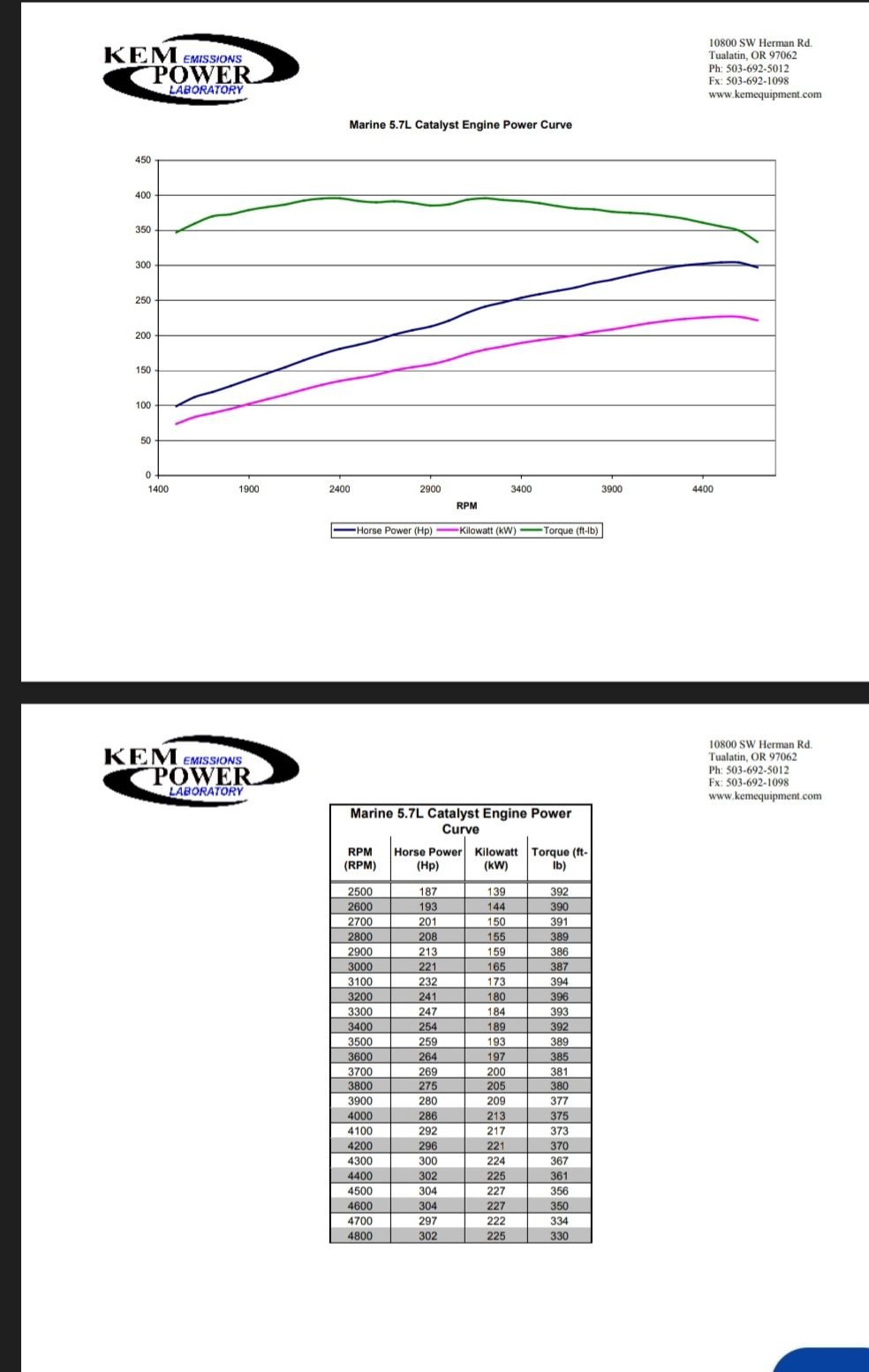

Not even close, takes a LY6 with VVT to even come close to the L31s low-speed torque and even then the LY6 is still softer under 3,000 rpm on torque. The L31 350 makes close to 400 ft/lbs from 2,000-3,500 rpm with a good tune. Best comparisons I have that have a good clean pull at lower rpm are all net rated marine engine setups running optimized tunes for torque production. L31 5.7L, LY6 6.0L and L83 5.3L with direct injection for comparison.

Yeah? A STOCK one does? You're saying that there is 50 lb-ft in a tune only??? Let's see it......
Not that it matters, b/c I thought the discussion about towing was Re: stock trucks.

Mine went from 185 whp and 250 wtq to 229 whp and 304 wtq with PCM tuning. Stock L31 through a 4L85E and 9.5 semi float also turning a 9 bladed Duramax fan blade when it made those numbers. Both were done in over 100F ambient temps. I changed the valve springs and put 1.6 rockers on it and made 257 whp and 310 wtq. I was getting valve float over 4,500 rpm so severely it lost nearly 40 whp between 5,150 and 5,350 but the valves started noticeably floating at 4,500.
My stock 8.75:1 L05 TBI 350 long block with bolt ons and tune made over 300 wtq itself.

I did not bring up the 5.3L, I responded to it being brought up. Look at the torque at 2500 rpm in the SAE power charts I posted above. Even the LY6 with VVT does not make as much torque. The VVT version of the 6.0L makes considerably more torque at low rpm than the non VVT versions. The VVT setup adds a solid 30 ft/lbs down low.

Those aren't engines in trucks towing though....those are different engines w/different exhaust, accessories, tune, op temps.....not really great to "compare" or use as an example when comparing against trucks with the stock motors in 'em.

If you want to use Fast's graphs against each other, and assume that the engines being tested are configured the same, we can do that too. Let's do that and compare a few "low RPM" points and torks:
Both pulls appear to start at a high 1500 RPM, so,
RPM.......L31.....LY6
1500.......348.....353
2000.......380.......377
2500.......390.......380
3000.......385.......390
Ave ......375.5......375
IDK....that 0.5 lb of difference average in that RPM range is not what *I* would call, "Wiping the floor". Or "softer below 3000..." I'd call that a wash. Maybe our definitions of floor wiping are different?

You realize that is a GenIV LY6 with VVT. The older Gen3 6.0L made signifigantly less low-end torque. So a LQ4 or even LQ9 is a good bit weaker at lower rpm. So yes 350 wipes the floor down low with a Gen3 as I previously stated. The VVT system added 30-40 ft/lbs at 2,500 rpm on every LS offering GM added it to.

Stock L31 350 that had shorty headers on it because the OE manifolds had cracked. 4L80E trans and 9.5SF 8-lug 2500 truck. Looks like it too had valvetrain stability issues above 4,800 too. This one vs mine that made 229 whp and 304 wtq I forgot mine did have Thorley tri-ys by that point but the tuning was a huge gain by itself. Mine made 185 whp and 250 wtq stock. Ended up swapping valve springs and running it again, later locking the converter and some more adjustments to the tune and it made 257 whp and 310 wtq. On E85 made 272 whp and 330wtq.

View through my inspection camera down a L31 spider manifold injector hole. Right at the valve like a LS. Other injector angles definitely result in less MPG and soggy throttle response using sequential injection especially. Many LS manifolds have poor injector placement and angles as well, so I tend to stick with the stock GM manifolds.
