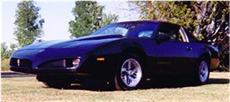

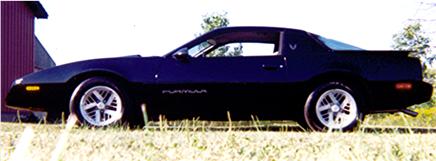

i think this is how i reply to this. The hood is a year old, but its still perfect, the rest of the paint i am almost sure is from the factory. I have a dewalt buffer w/ the trigger like a tps its the throttle. I am using a wool pad w/ 3m perfect-it II rubbing compund. I dont have good pictures because the camera takes care of the swirls. It deltes them somehow I'll add some anyway Thanks for the help again

Nice looking ride, In my view it sounds like its your buff pad?, go out and buy a 3m foam coloring pad(I think its called a waffle pad inUSAits the one with sorta dimples in it)
and a bottle of 3M perfectit "Glaze" get the black one coz of your dark paint color, just make sure you use it damp on a foam buff pad & don't let it dry or heat up too much when buffing & buff at about 1600rpm.
Watch you don't over cut on you edges, when your done wash really well in warm soapy water then hand polish with 113 or another good polish!
Never used 3m "Rubbing compound" but is it a liquid or a paste type coz if its a liquid type you maybe should be using it on a damp foam pad not wool, The other 3m liquid cut is good to use but a bit late now you have the rubbing compound.
Good luck lets know how ya get on
